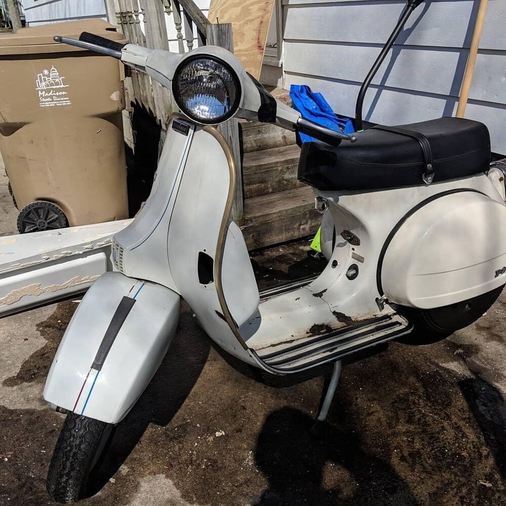

Just picked up this P200 from a local friend who wanted to thin his herd. In good original condition and will be my Wisconsin winter project.
First non smallframe for me so lots to learn.
Following gascooter Bianca project as a guide.

That looks great ExMayor - congratulations!
I've been through a few P200's now, Ruby, a maroon 79, Feebs, a white 81, and Flo, grey multicolored.
Ruby and Feebs are the main ones though. Ruby's thread is here: P200e - this time for real!
I'll be following along and also I'll try to make sure I update Bianca's progress as I do stuff.
Congrats again - that's a sweet looking P. I did notice the rust on the rear of the floorboard by the tunnel. I wonder if it goes into the tunnel?

The rust is just surface rust. It has been cleaned off by the PO.
The rust isn't deep and the tunnel is completely sound. PO thinks there was a rubber mat on floorboards that trapped some moisture.

You'll find the P200 motor super-easy to work on and fairly bulletproof. Likewise, lots of other aspects of the P's have similar Quality of Life improvements for maintaining or repairing them compared to earlier vintage bikes.
What are you planning on doing to it? Just maintenance and cosmetics, or adding some extra go-fast?
You'll have a fun winter project and a solid rider come spring in any case.

Got a start on cleaning up the areas that the PO had addressed with rust converter.
Used a flapper wheel on the Dremel followed by scrubbing with Eastwood fast etch and a green Scotchbrite pad.
Will need a little more work but just some pitying and no rust thru.
Then prime and touch up.
The respray is s in generally good condition.
These made short work of the clean up
So happy to not find any rust thru. No problems inside tunnel
Surface rust tries to hide under rear bumper

Since the bottom was so solid and just had really thin paint went after with sand paper and fast etch then primed and two coats of paint.
Sanded fast etched primed and painted the inside of tool box. All the area under the rubber seal had surface rust. Flapper wheel, rust converter, fasts etch and primer now that inside is done can top coat the rest.
New NISA seat from Christiaan Foppen at PLC Corse gives it the look I'm after.
Motor is down at Scooter Mercato for Matt to rebuild. Nothing radical. 57mm Mazz crank first over Grand Sport piston matched to bored original barrel. A little intake work Polini venturi and Polini box pipe.
Should be a good all day ride.
