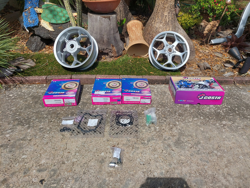

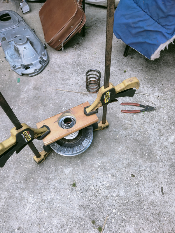

I have installed jcosta on four bikes. beo500, tmax 500, majesty 400, silverwing 600.
I was previously hooked on sliders (15% lighter than stock rolls), with malossi white contra spring (10% heavier than stock)
I couldnt find good info anywhere about what the contra spring does. in my head I figured it was a heavier spring so it would stay in first gear longer and do it with less belt slip. I did back to back swaps contra spring only so I could learn.
the contra spring is like changing your final drive ratio. a heavier spring raises ratio. a lighter spring lowers ratio. lower ratio= more load= lower rpm.
you should try the malossi white spring. it will sacrifice top end speed for better take off and snappier mid range.
one thing confuses me on the jcosta not being smooth comment. that is what I like most about it. it acts like a harmonic balancer on the crank. all engines run smoother with it. remarked so in my experience. maybe you are getting belt vibration? all the bikes ran butter smooth with jcosta installed.

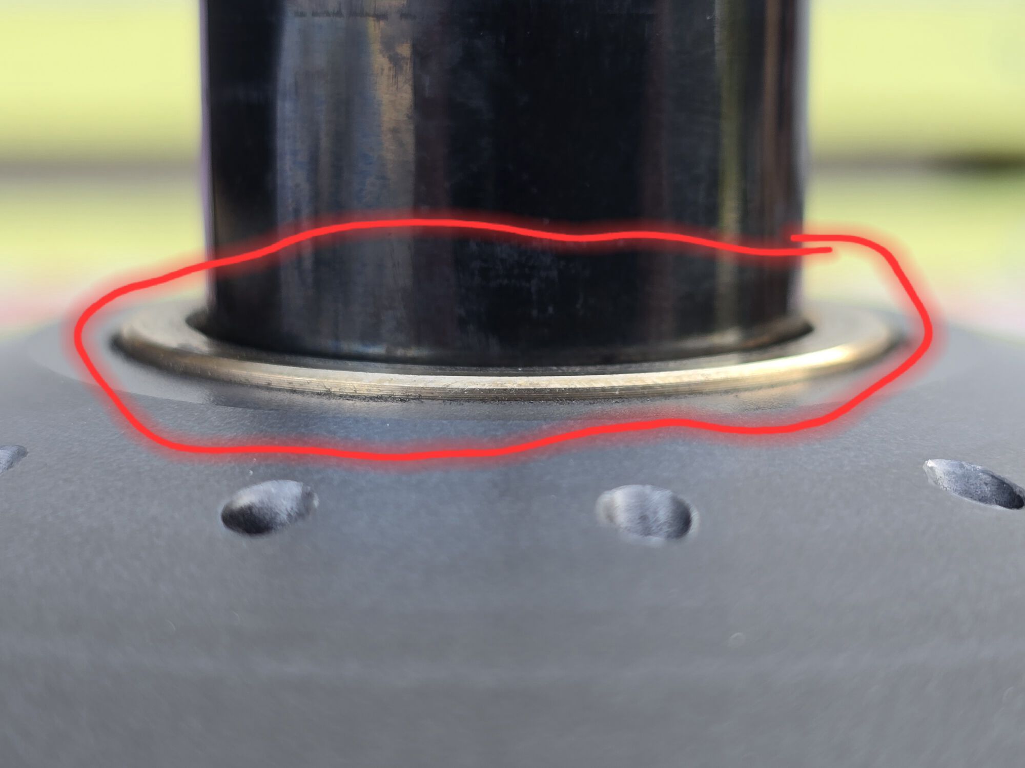

I dont have that data yet. so far only seen pins from the tmax after 5500 miles. they looked good like they would make 10k. the feedback on net is mostly from people not servicing the cvt when it needed it. and with older models of the jcosta.
the pro version has a drilled/anodized variator. diamond coated slide bearing, and other improvements. i am still believing lifespan is short compared to standard option varios. best bang for the buck is dr.pully sliders. especially for bike that does lots of miles. have seen sliders with 20k and no wear.
I drive for the pure sport of it. and I have too many scooters to put many miles on any one bike.
