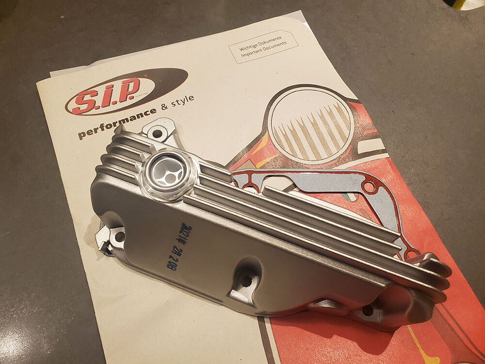

One bit of advice I'd give in the name of keeping an eye on the oil level: switch out the oil pan for one with a built-in sight-glass. The only complaint I have about the HPE is where they decided to relocate the oil filler, closely adjacent to the exhaust. Not exactly helpful for a quick level-check.
As far as the paint goes? Yep, definitely check that out.
New Oil Pan: Just like the original, but better.
New Oil Pan, Installed: Oil-check at a glance.

The oil pan with sight glass does look like a good mod, but assume it would invalidate any warranty?

No, it won't invalidate your warranty. It is actually a genuine Piaggio part that is modified to install the sight glass. Great mod.

Indeed it is a great mod that won't invalidate your warranty, only annoyance is that it should be a factory standard fitment and they are not cheap.

Ironically, Vespa apparently used to have this feature in the not-so-distant past. Luckily, someone outside the company remembered this.
