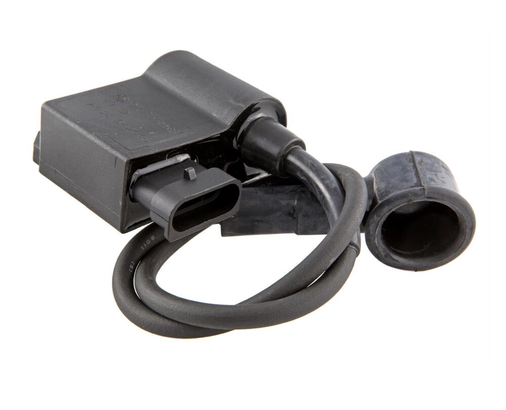

If the CDI is like in the pic, it has a rev limiter. Ignition system is made by Kokusan. But I don't think so, cause they came on the last of the PXs (2010 and onwards)…
