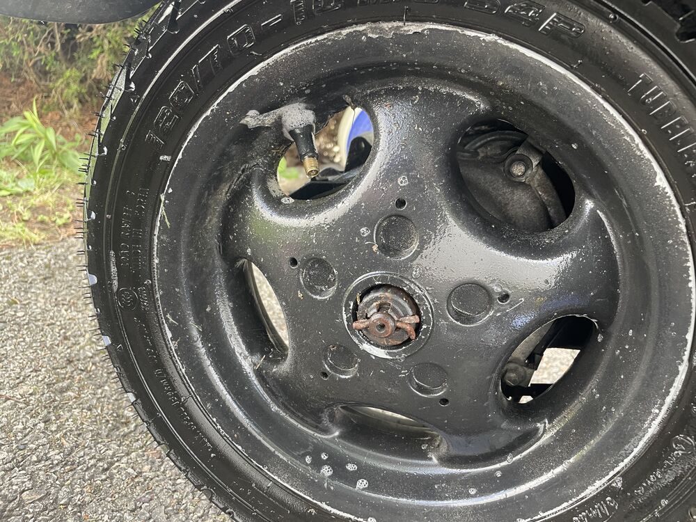

Back rim wheel issue. Before I left I had gotten a new tire. I think the place messed up my rim because now I'm on the second tire and it deflates after a few days. Any tips or best to just get a new rim? Guessing they bent it somehow.

Back wheel issue: Inflate to correct pressure, use some dish soap with some water and spray or pour it on the valve stem - if it bubbles there's your leak.

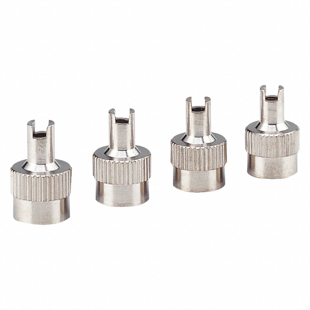

If it is from the core of the stem, check your valve cap to see if it is the type that are slotted to tighten the valve core. If not, check your bicycle, some tube brands use the slotted style cap. If not, they're inexpensive and I make sure one if not both wheels on my bikes have a metal or plastic cap that will tighten/loosen the valve core. A four pack of these should be available at an auto parts store for less than a gallon of gas, or stop by a tire shop to see what options they have.
If it isn't a leaky stem, get your least favorite roasting pan, large enough for the tire and deep enough to submerge a portion of the tire (see the bad photochop below.) Get some help lifting the back of the scooter so the rear tire sits above the pan, then fill it with soapy water and watch for bubbles. Mark the tire with a sharpie so the tire shop can find the leak.

My first time doing the soap test. But would this elude that the stem is bad and what is causing my rear tire to not hold air?

If it leaks from the valve stem, it is likely a bad core which is a 30 second job if you have a new core and a core wrench or slotted valve cap. The only other place likely for a valve stem leak is if it is cracked where it exits the rim. Then you need a new stem and that requires letting the air out and breaking down the bead. Possible to do it with the wheel on the bike but easier if the wheel is removed.

Thnx. Can I just replace the core and stem to be safe? Both at once.

Replace the valve stem. It comes with a new core. Every place that changes tires stocks them. It goes in from the back side so you need to break the bead on the tire. Search or ask for Schrader Valve.

Ty so much. I really do appreciate it. So happy it's not the rim.

Based on my experience with replacing a valve stem , I would take the wheel to a motorcycle shop that has tire changing equipment and have them replace the stem. They'll have the right kind of stems in stock; I wouldn't bother ordering from Amazon.
Bringing in the wheel, off the scooter, saves a little money.

Motorcycle shops should have a tool that can insert a new stem without even breaking the bead on the tyre. At least, that's the case in the UK.

We have these, and they are very easy to install. You can break the bead, drive the old stem out and stick one of these up there. They last as long as the regular one, but I call them emergency valve stems because you can replace them while the rim is on the bike, and it's very easy.
https://scooterpartsco.com/ricambi/misc/emergency-replacement-valve-stems
