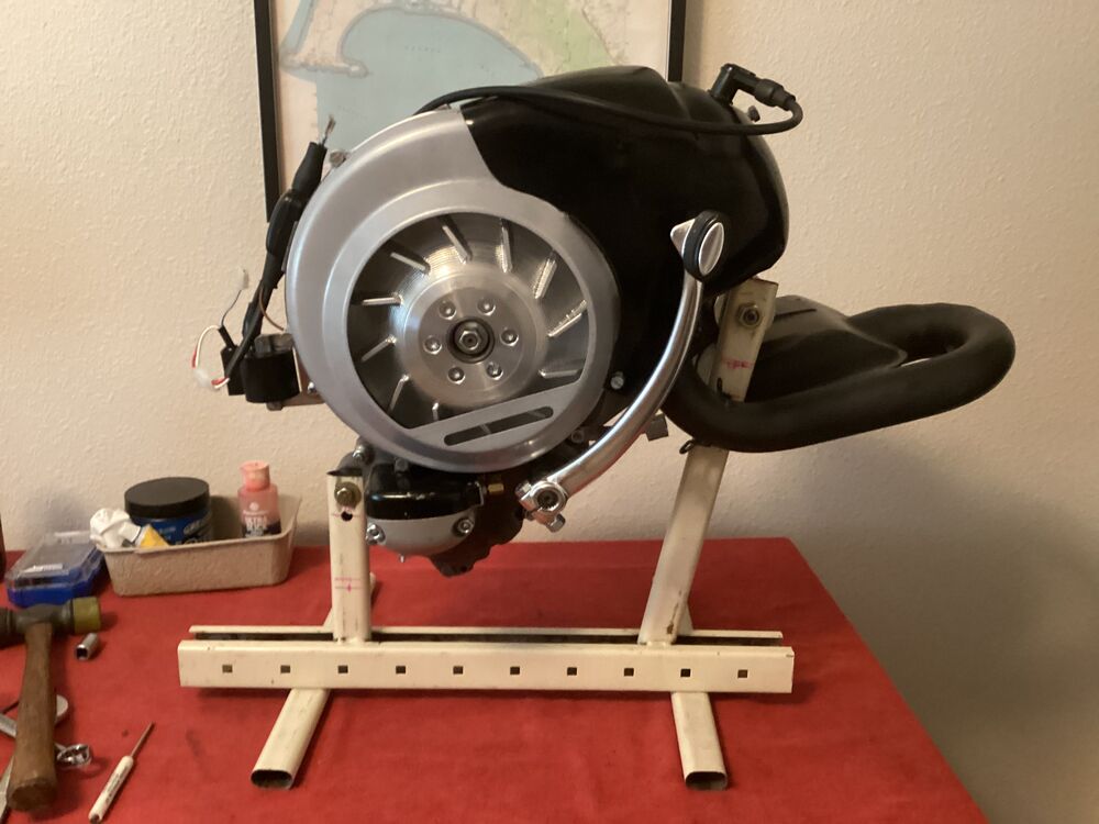

Good morning,
First off thanks to everyone for all the help and entertainment so far.
I've got a '58 150 VBA engine with the following.
Pinasco iron 177 unmodified
24/24 carb with 55-160 idle, 160ac, BE3, 116 main
SIP Vape static timed to 18 degrees
SIP Road exhaust v.1
After a year off I'm excited to get back on the road[/img]

Thanks. It's just on there so I could time the engine. Easier to manipulate. Good thing about a fully splined shaft.

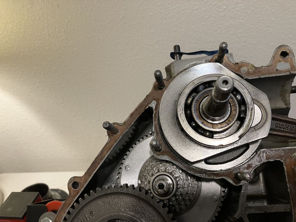

The case has been modified to fit the 24/24. I've got a Mazz cut crank in there but not sure of the timings. Have to look at the box later.

This crank
https://www.scootermercato.com/Scooter-Parts/Crankshaft/131897CUT

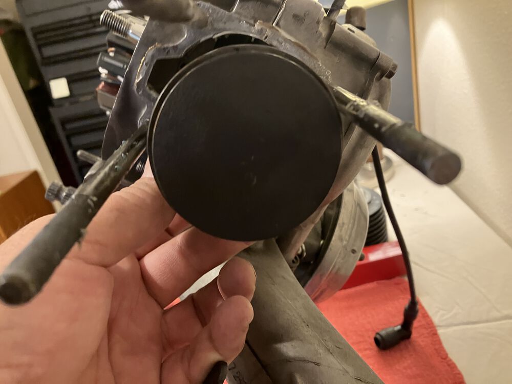

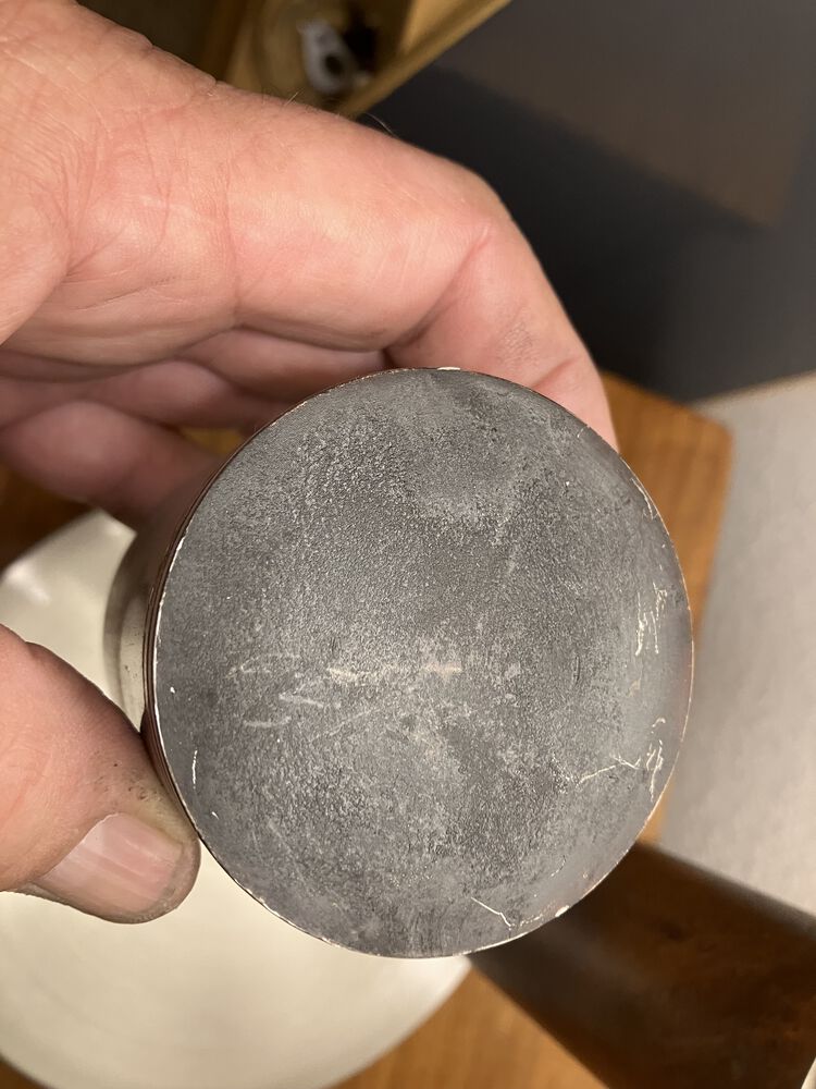

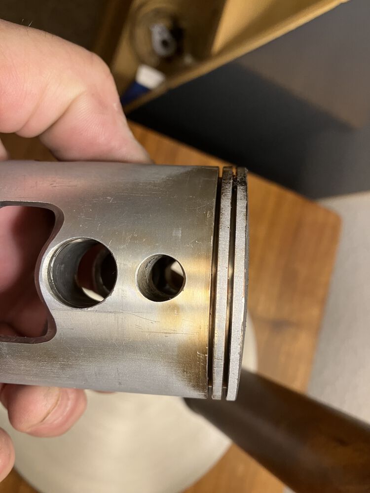

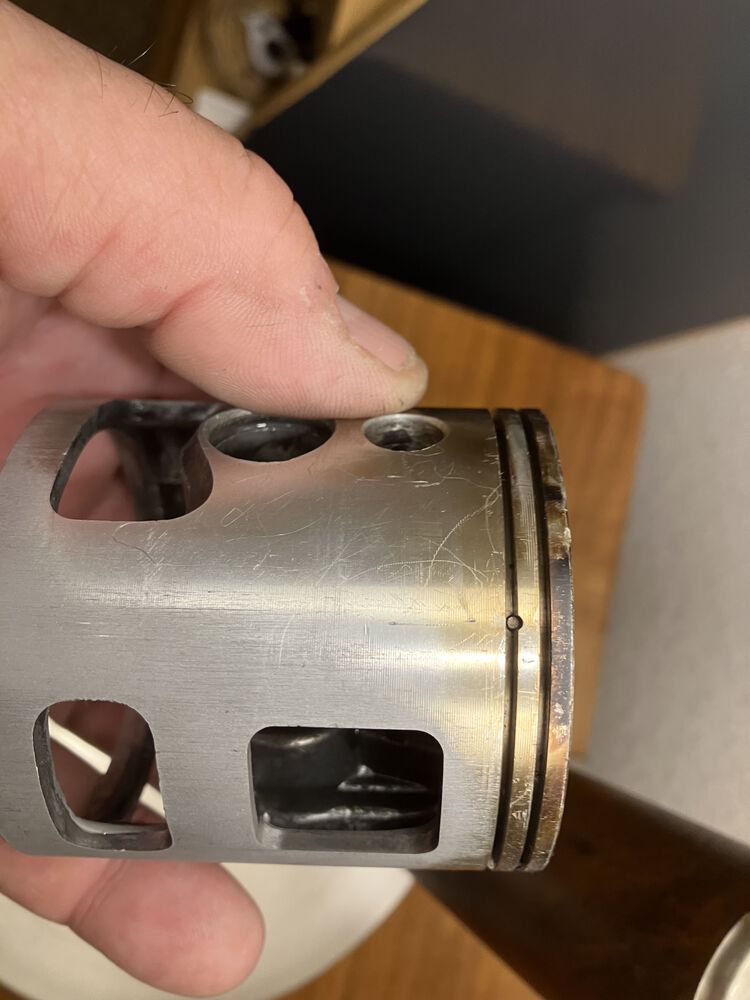

So finally got back on the road with the changes in the jet stack. Finally revs(edit: stumbles in third I apparently don't know what thing mean) in third. Also installed a CHT. Went for a run this morning. About four miles in it seized hard. Temp never went above 250. In my other thread about the way the engine sounded(yes past tense) the little unidentified sound I noticed went away about five minutes before the seizure.
So will pull the engine for the umpteenth time.
Anyone want to guess what I'll find inside?
Glad I just finished the trailer.
⚠️ Last edited by Grumpnut on UTC; edited 1 time

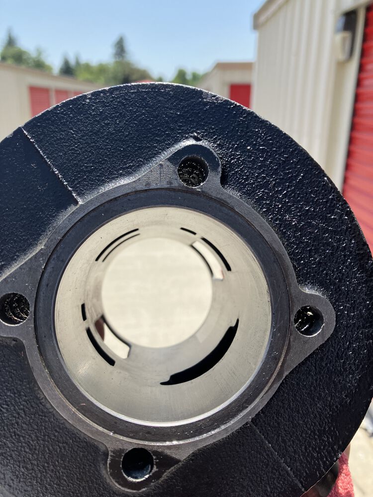

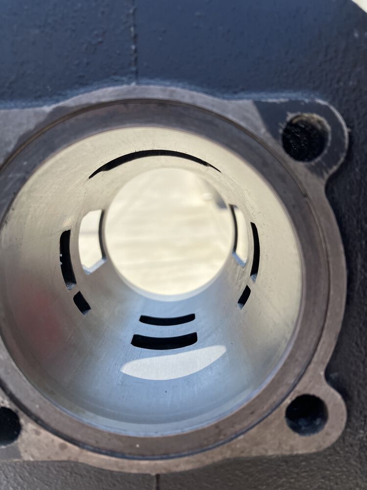

Aluminum smeared on the inside of the cylinder over the exhaust port. The rings melted/stuck in their channels. Too small a main jet.

Too rich would be stumbling instead of revving out in third.
The good news is that the pinasco is tough as hell.
Despite my best efforts, I only managed to kill my cast iron Pinasco 177 by raising the exhaust port too far. Not even eating a wrist pin circlip could kill that jug.
I think I put a random DR piston from the parts pile in it after that and just kept running it.

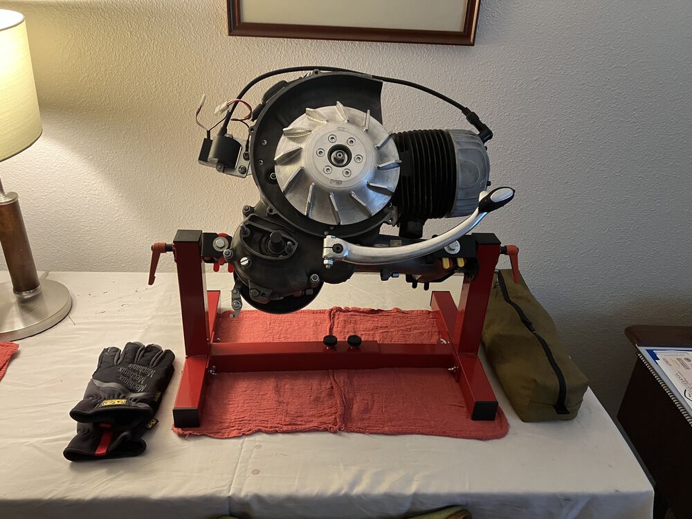

At least I have a chance to try out the engine stand

I'm with Gick. No way an unmodded, cast-iron 2-port Pinasco was running lean with a 120 main jet unless it had a massive air leak.
Are you sure it was the top end that seized and not the clutch or something in the transmission that let loose?

First off - sorry to hear. That sucks - but your gonna end up better at some point with this - and that much more expert.
(IK - not much consolation).
So - usual questions and a few comments...
- Is the carb float hole drilled? This will change the size of main about 6-10 points richer when it is - so some of the comments may be altered by that.
- You may have seen slightly higher temps than you realized - it seized after you came off the throttle - so I'm going to say heat seize. When it happens - it can be a very quick spike. Do you have a recorded top temp?
- You may find that your ring gap was too small. Did you measure ring gap when you built?
- Your "120" main jet COULD be smaller than it should be.
The thing about iron is, it expands slower than aluminum.
The thing about aluminum is, your piston is made of it.
Piston will expand faster than cylinder and can be unforgiving if piston size or ring gap is not right.
Aluminum cylinders are far less likely to seize for this reason.
just some data should you need/choose to replace the cylinder.
I prefer to jet the carbs with smaller A/C's - as per Chandler.
This allows less chance for restrictions un-related to the main jet from being problematic.
(It also moves you down in MJ size)
When you open it - look to see if you have skid marks that align with all 4 cylinder studs. If yes - it was unquestionably heat seize - and that's my guess.
