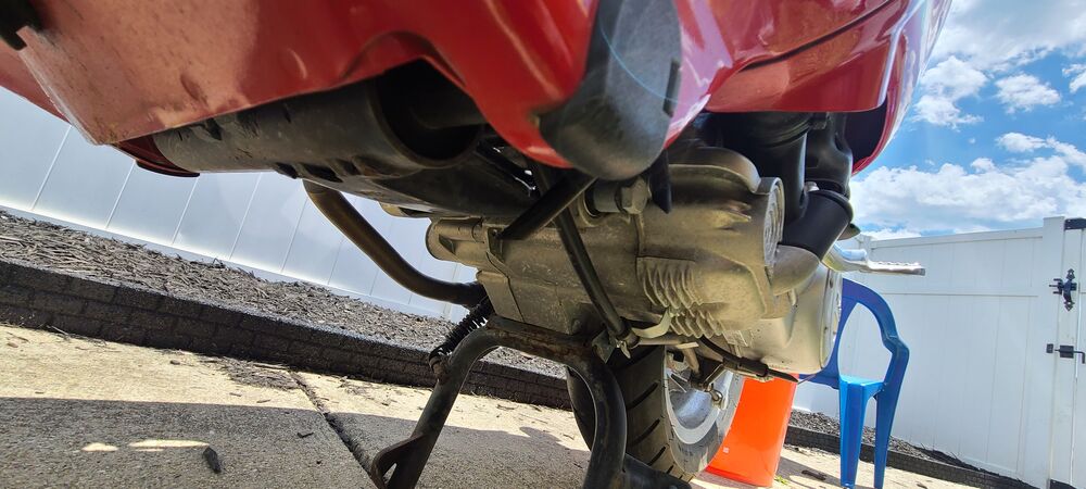

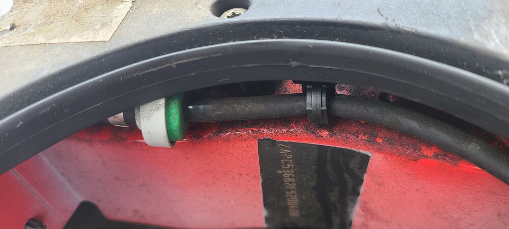

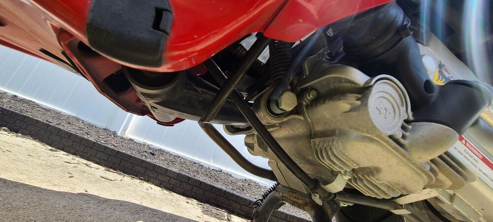

Newb here again, just trying to get my 2015 Sprint 50 with 649 miles running after buying it from a friend that is moving. The battery is ok, but I finally got it started after several tries(holding throttle helped), only to have it cutoff after a few seconds. Oddly enough fuel was leaking onto the ground every time from of of these lines hanging unterminated at the bottom. Are these lines suppose to be here? The two diagonally cut ones look like they're coming out of the carb, and the other the fuel pump? It was sitting for two years and the gas level shows two lines, I'm not mechanically inclined when it comes to engines and stuff, but I'm going to take the carb out next. I tried to siphon out the gas to replace with fresh gas, but I think I need a longer hose.
One line is here
One line is here

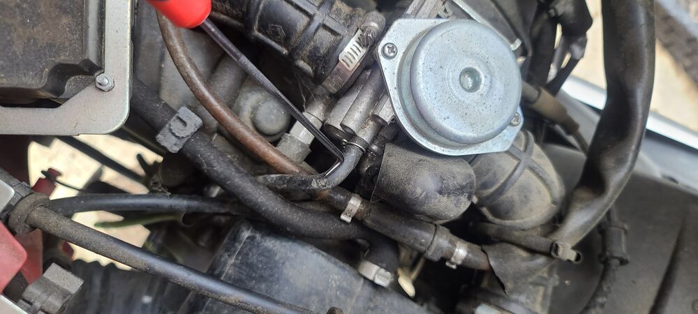

This is the other one coming from the carburetor.

One hose is the carburetor vent/overflow, the other is the fuel tank vent. Neither should typically have fuel coming out of them. I would bet that the float needle in the carburetor is gummed up and that this is causing it to not shutoff fuel when the carb bowl is full. This will cause an overflow and the extra fuel will run out the vent/overflow hose. Some of the fuel will also run into the intake and this is probably why the engine won't idle properly unless you open the throttle a bit.
