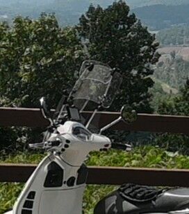

Here's mine on a Sprint. Probably depends on how high you slide up the adjustable screen.

Thank you !!!!
Mine is a GTS but this give me some idea 🙏

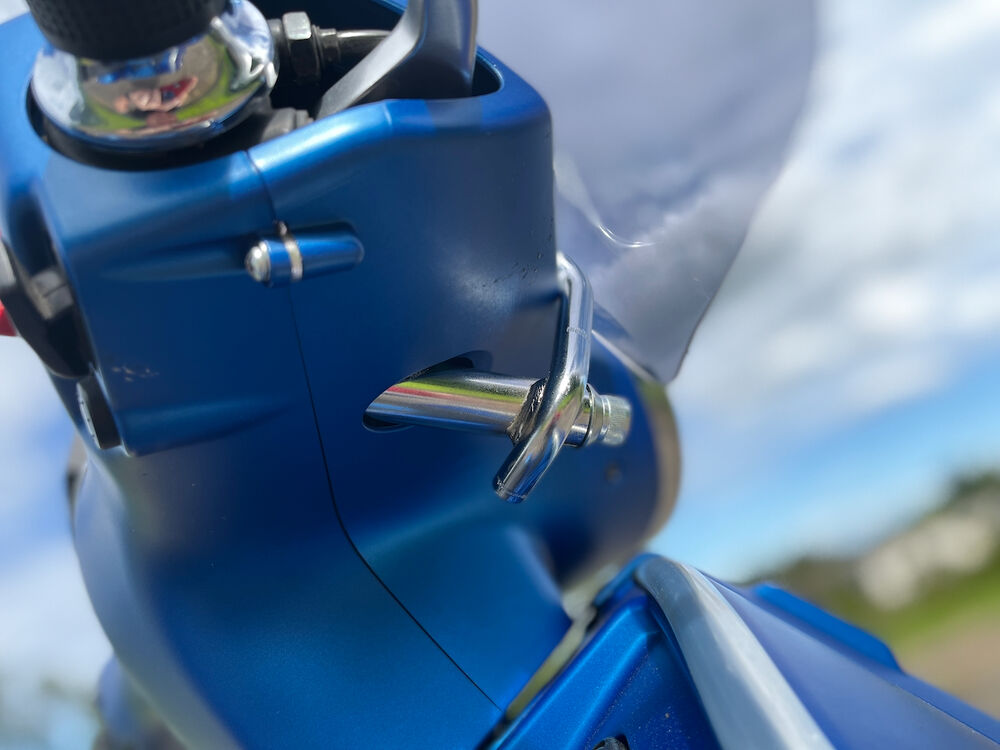

So I broke down and ordered the FACO Twin screen for my 2019 Vespa GTS hpe.
The hardware is decent but the instructions are non existent. Watching some Youtube videos was helpful. It takes some puzzling but with some common sense and experience it all came together.
Putting the bolt trough the long bushing puzzled me for a while. It only went in for 1-2 inches but then got stuck.Turns out that a quick tap with a hammer pushed the bolt trough.
The most important thing I learned from Mr Robot was that the expansion nuts need to be pushed in all the way. It took a couple of decent taps with a hammer to drive them inn all the way before tightening with an 8MM Allen wrench (not included).
The plastic nuts to mount the screens are very soft so be gentle while tightening them!
My scooter lost its cool sleek look and has been transformed in very nice looking travel machine with the windshield and the bag on the luggage rack.
Unfortunately mounting the Garmin GPS with the RAM mount interferes with the sliding windshield. I cannot slide it all the way down neither can I position it where I had it in mind but I think it worked out ok.
I connected the power supply to wiring to the USB ports I had in stalled and routed the wired trough the opening for the left mirror. No need to drill holes
Tomorrow I will take it for a test ride to see if the windshield prevents the wind from swirling under the face shield causing my eyes to water like the Niagara Falls.

I also felt the inner screen was a bit too short when fully extended. I wound up replacing the entire inner screen with a custom piece I made from a tinted windscreen for the Genuine Blur.
I had to cut it to narrow it a bit and drilled some holes for the mounting. I also heated it in a cardboard box "oven" using a heat gun (this process was monitored VERY carefully) to allow be to adjust the curvature to match the Faco's outer screen.
I really liked the result as it helped reduce the amount of wind (and fatigue) on my helmet, and reduced noise as well. As you can see in the pics, I still have about 2.5 inches more height available if wanted.
Custom extended Faco twin screen, with a good look at the longer RAM arm for my GPS in place.

I installed this on my 2020 Vespa GTS SuperTech 300 HPE. It looks really nice and I have also added the Laminar lip and it helps with buffeting. The only drawback I found so far (only a single 10 mile ride) on city streets is that the water from the rain with the extender fully extended, basically soaks my dashboard and also my RAM-mounted iPhone. I figured I can put a sandwich bag over the top of the iPhone, but the fact that water from the rain drips down in front of the raised extender and onto my dashboard may make this a no-go for me.
Have others experienced this in the rain? If so, thoughts?
I have attached a pic for reference.

I typically don't ride in the rain. And I live in the desert so I don't have to deal with that much.
I think I'm going to sell this windshield. Most likely, I'll get two. A short one for summer and a tall one for winter. Swapping it pretty easy. It only takes me maybe 5 minutes.
