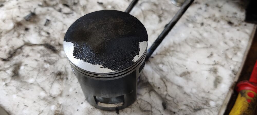

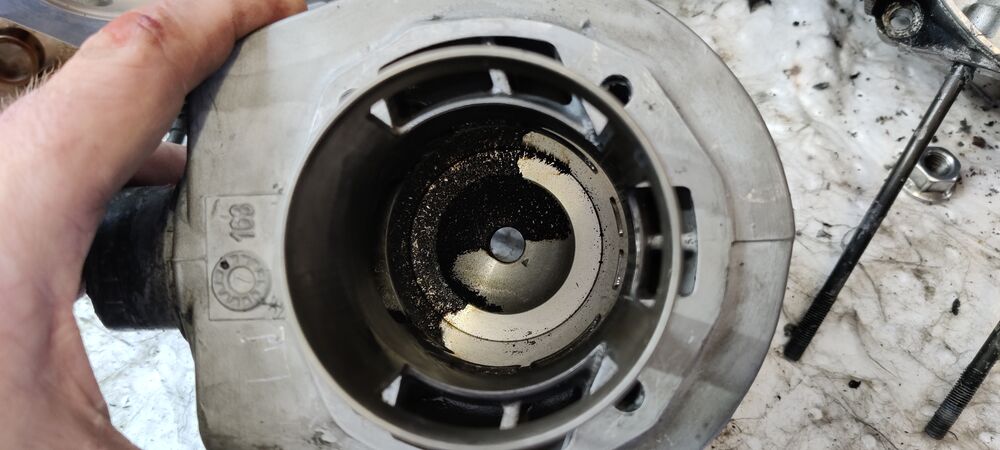

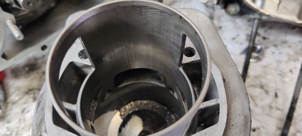

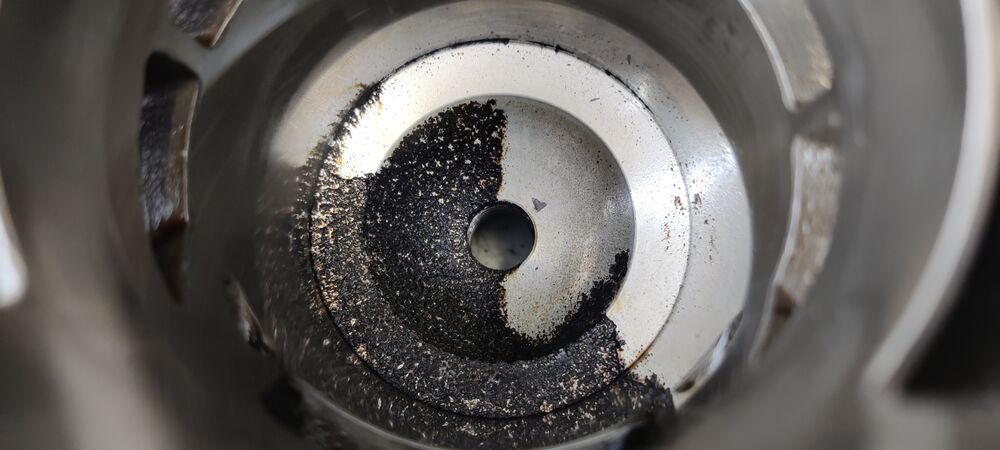

What does your piston, cylinder head and barrel look like? Post pictures for all to see. If you were having damage from super lean it will be visible on those parts.

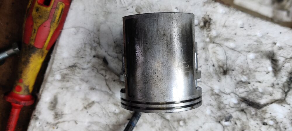

The lines on the barrel I cannot feel so they appear ok. Lot of carbon build up after only a short time.

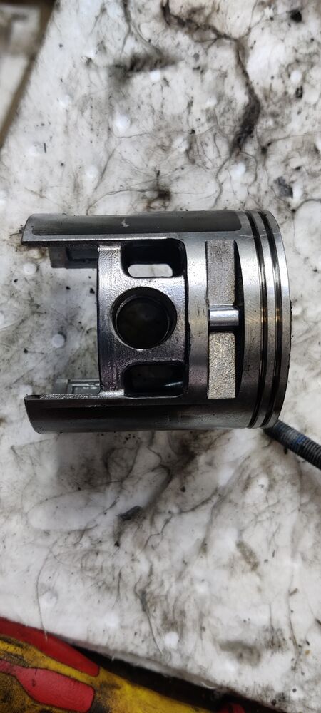

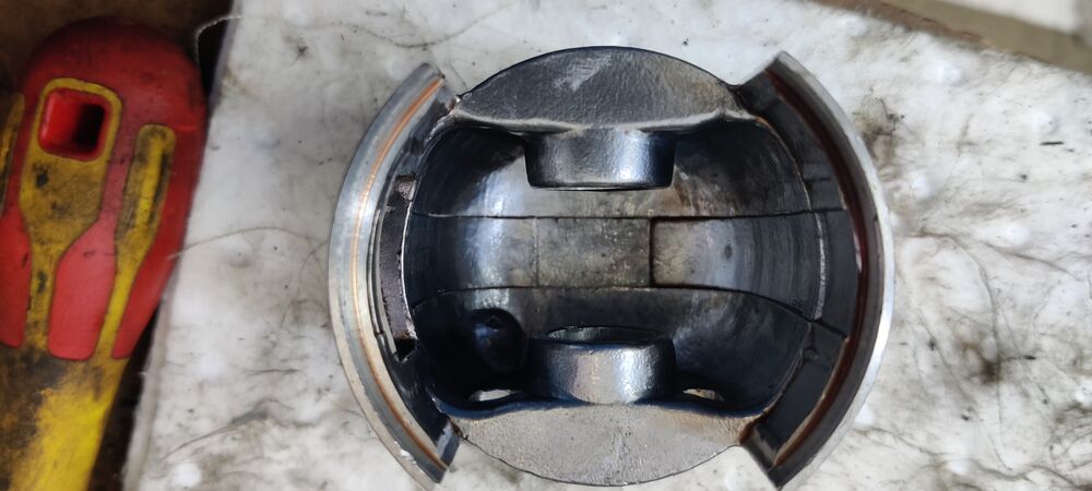

What's the head look like by itself without the cylinder over it? If you had an air leak at the head you can see oil marks dripping out past the cylinder mating surface.
That is a very strange looking piston top and commoner head oil/carbon pattern. One of the experts in here will probably be able to point you in the right direction with these images.
The head is fine. No sign of leaks. Its definitely at the base. There was a huge air leak flywheel side which I thought I solved by adding more sealant. This obvisously did not last as I needed to upjet to a 145 and it still was not bogging completely.

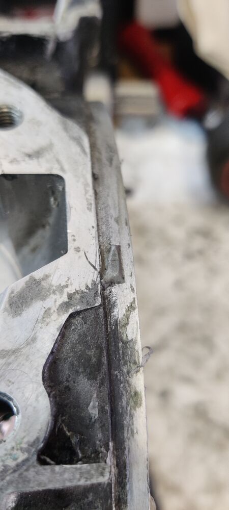

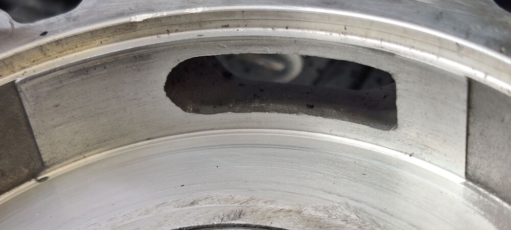

What is that lump of metal near where the cylinder sits? It's raised beyond the sealing surface and could stop the cylinder sitting flat?
There is a lump that flywheel could hit, file it off. Swiss can give you direction on surface sanding cylinder sealing surface by hand.
I would try a piece of plate glass with rounded edges, a suction cup to hold it, and something like a 600 grit wet dry sandpaper to polish surface and look for high spots.

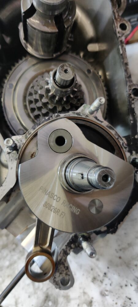

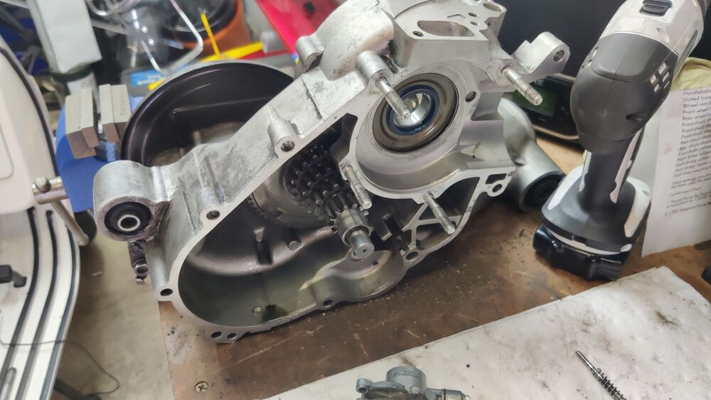

So just to update you all. I have stripped the engine and now in the process of cleaning it all, including all mating surfaces. I have replaced both flyhweel and clutch side oil seals. I now intend to purchase 26/26 carb and start a slow rebuild with pictures on the way as to gain advice from you all. I am having a few weeks break.
I will be back soon and provide some pictures of my progress.
Thanks again for your help in this very long post. I never meant it to take so long.
I may sand the cases where the cylinder sits but will post a photo to see what you think of them. They do not appear to be that bad.

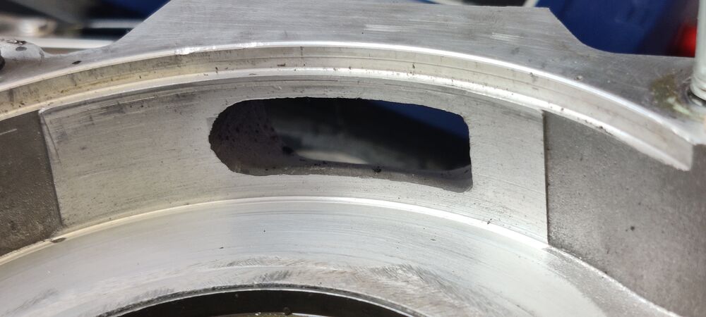

Before I buy all of this new stuff, here is a picture of my rotary valve pad. The clearances with the engine built up was nearly 0.15mm, well above the recommended 0.05mm. No point buying all this stuff if the valve pad is fucked.
General question for anyone reading this who may know, I've been curious. What would happen with a 62mm P200 rotary crankshaft in this case? If cases need to be machined larger to fit crankshaft could that be used as a fix for a worn rotary valve? Thinking that option wouldn't be any more expensive than cost to fix valve by adding metal.

GickSpeed wrote:
I would recommend having someone with a mill set it up, zero it out, then take .001 off the gasket surface. This stuff, doing it by hand, is not recommend. might be something i would do if i was in the middle of nowhere, broken down, and this was the only option to get home. Spend the $30-40 and have it done with accuracy.
I agree, I would be doing it as a quick, lets see what I have. I have all the stuff at home to do it.
Agreed. I did it cause my cases were already somewhat messed up from welding and it was a shot at doing it on the quick since I don't have anyone with your skill within driving distance. But I am sending those cases to gick in a week or two for welding repairs anyways and I'm sure he'll go over that surface on a mill since the repair he's doing is along the edge of that surface anyways.
Roody, best option is always to have a machinist do repairs correctly if you have one locally. My cases are suffering from using a local welder with no experience with working on vespa engine cases. As a result, I'll be paying twice for repairs and shipping halfway across country to get it done correctly.
I'm sure there are many in England given the wider popularity of these scooters and the thriving tuning scene over there. It's really rare to find someone with gicks ability and experience with Vespas over here in the USA, so we have limited options for this type of repair. You should be able to find a pro close to you.

Your inlet pad is in good condition. Could really do with opening up. plenty of info on here about how to do it.

Engine dismantled and cleaned. Awaiting a few parts before rebuilding.
@xantufrog avatar
Moderibbit
Posts: 8891
Location: Atlanta, GA
Moderibbit
@xantufrog avatar
Posts: 8891
Looking spiffy

My bits have arrived. Should I grind some off the rim of the new clutch side oil seal before fitting it? I don't want to leave that other one on in case it wears out quickly as it touching the bearing.
Jet Eye Master
Posts: 5251
Location: London UK
Jet Eye Master
Posts: 5251
Location: London UK
Have you brought another cheap oil seal? The ones that stay in don't need modifying. The seal coming out when running can really make amess of the cases.
BGM or Malossi seal and Loctite 603 is the best chance.

Your rotary pad looks perfect. I'm not sure why you're getting such a large clearance.
