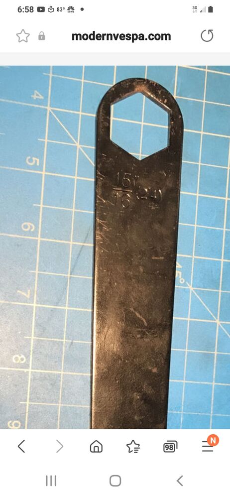

You do not have to remove your exhaust, but there are reasons why it might be a good idea.
I changed the oil in my et4 without removing the exhaust. I leaned the bike against a wall and did everything from under it.
Luckily, i had this wrench from some old power tool, maybe a saw, and it is a 24 mm perfect fit for the drain plug but only and 1/8 inch thick. It came in handy. If you don't remove the exhaust you'll need something like this because it's a tight fit between the drain plug and the exhaust pipe.
JimC is always right on with his advice. I wouldn't be afraid to remove the exhaust. Having done it a few times now, it's actually fairly easy. Just takes a bit of touch. It'll make the job easier but it's not necessary.
24mm slim
24mm slim

Can we find the architect of the et4 and ask he/her why they would even put the plug and oil filter so close to the exhaust lol 😔

That looks like a table saw wrench. Thanks!
I'm pretty sure it is!
