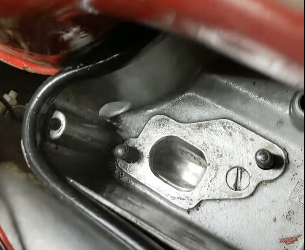

I suspect your carb has a built in air corrector and needs the pilot jet without a hole.
Popping on rundown means lean.
Post a picture of your carb to confirm.

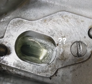

Is this one?

xperimental21 wrote:
Is this one?
Yes, your carb must use the pilot jet without a hole. 42 should be ok but may need bigger.

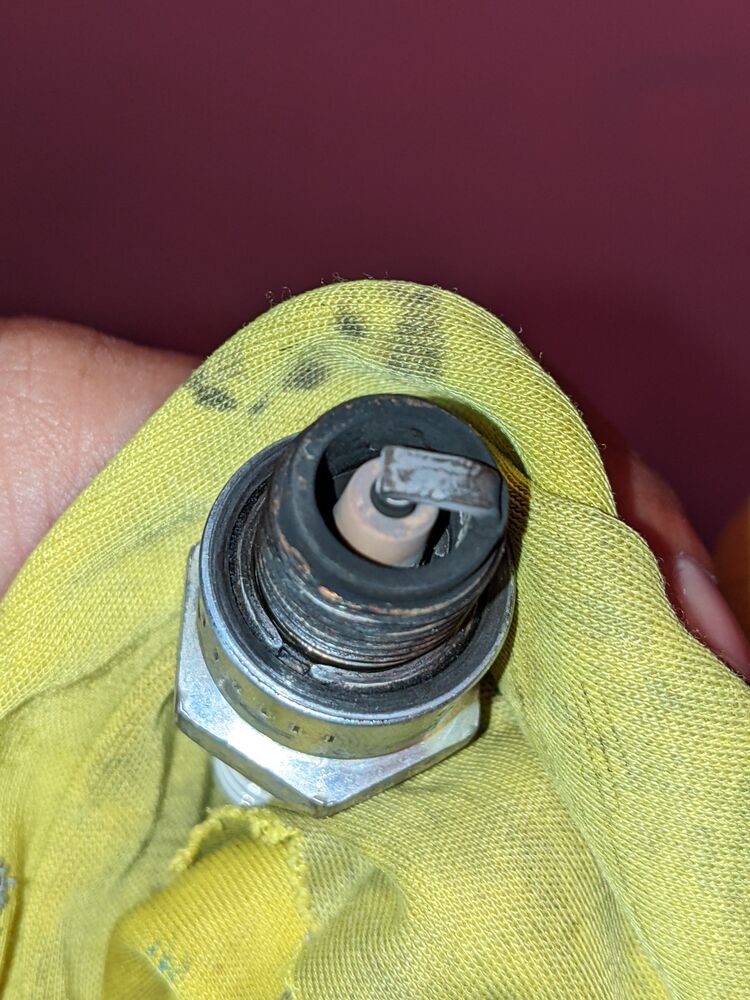

yes thank you. Anyway, need advice. This is the result on WOT, Is it lean and need to up the main jet or I need colder spark plug?
I ride mostly 30 km, average weather temperature is 30 deg. celcius, I use B7HS plug.

Up the main jet. Increase the jet size until WOT doesn't rev out, then reduce jet size until it just about revs out. A jet that revs highest is too lean on the road.
Done! feels faster and great now.

Jack221 wrote:
Where did the jetting end up? Going faster is a good sign. When the jetting is good, if you roll off the throttle, then open up again the power should come back Immediately.
Points ignition is not much good for higher rpm. Leave the timing at 22. Plenty of scope for upgrading. PX150 head and vape conversion top of the list.
110 MJ is the best so far. I tried to up the idle jet from 42, but only 50 and 48 sizes were available for my old carb. Unfortunately, the idle jets were too rich, it kept idling when the mixture screw fully closed/tighten and too much smoke.
