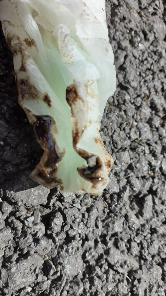

Hello again. Thanks for the reply. I checked the sump oil and it looks really clean, no obvious signs of mayo type gunge in there. It was changed recently and still looks fresh. I soaked up the black oil in the header tank (pic) and ran the engine on tickover for 5 mins. It cutout once but restarted straight away and sounds uk. I wonder if oil is getting through at high temps/speed while compression is high? I'm leaning towards pulling the motor and getting my hands dirty to investigate. Any opinions/shared knowledge appreciated.
Black oil with coolant!

Waterpump seal would be another possibility
After sitting for some months, the seal will stick to the shaft & tear when you start it
Posts: 474
Posts: 474
Water pump first. It can be easily serviced and doesn't require engine removal. Replace the seals and see if the issue persists. If it does, then tear it down and replace the head gasket.
