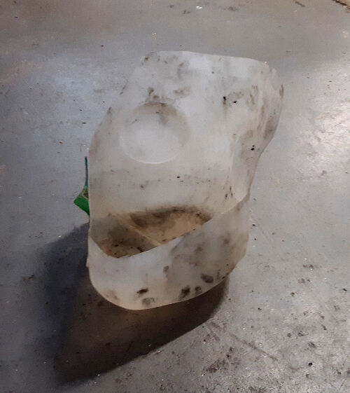

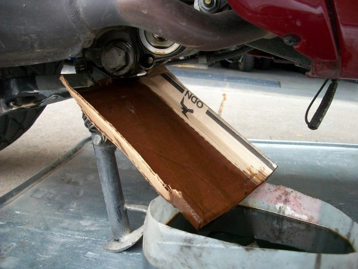

I use one cut out of a gallon water jug. Leave two sides tall. It fits up against the center stand and guides the oil in from the drain plug. I fold a C out of an old cereal box and clamp it to the side stand. One end tight up against the engine block, the other end inside the water jug.

I fully approve of the used milk and water jugs. The cereal box funnel is another great hint. I was a KLR owner too.

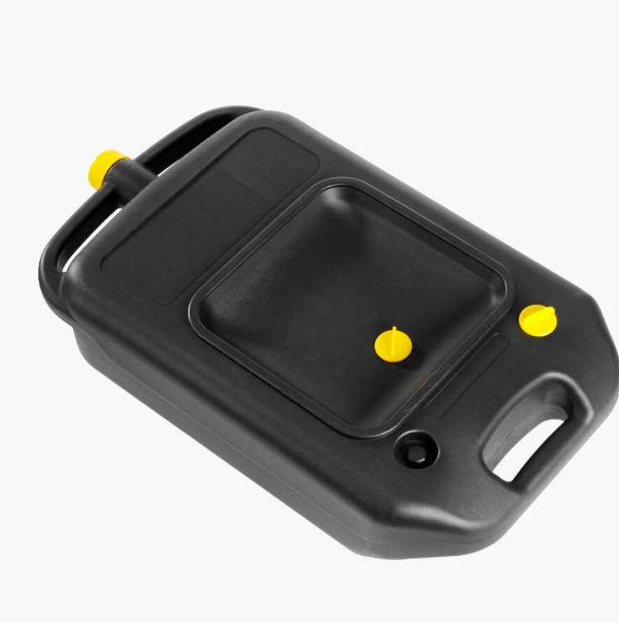

I got one like this for my lawn mover.
Once I realized how handy it is, I started to use with bikes too
Can't remember how it was with the Vespa, but this obviously works the best when there is a clear 'stream' of oil, not multiple streams from here and there...
I just pourt the contents into a nearest waste oil collection point. No other cleaning required than wiping the collector surface with a rag/paper towel etc. to make the container easier to handle.
I got this somewhere from internet ...can't remember the price, but this one was cheap.
