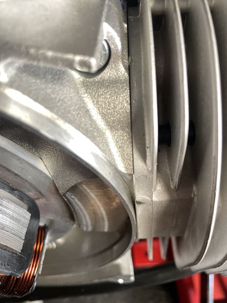

They just showed up today. Unfortunately, it seems like the new BGM 177 kits that are supposed to be compatible with the electric start are not. There's 2.4 MM of material in the way. Anyone else had this issue?
There are two versions: the first version does not work on electric start flywheels. if you try to take material away for the gear to fit, you will break through. The second version is reengineered to allow the electric start flywheels. i wonder if you received the first version. i've installed several of the 2nd version and never had an issue with the electric start flywheel rubbing.
maybe someone has decent photos of V1 and V2 side by side?? that would help to see what you received.
Posts: 10
Posts: 10
I'm in the same boat with you in thinking the wrong cylinder was sent. I ordered scooter center PN BGM1770NE, which is outlined as the one for the ele start. I just shot them an email, wait to see what they say.
