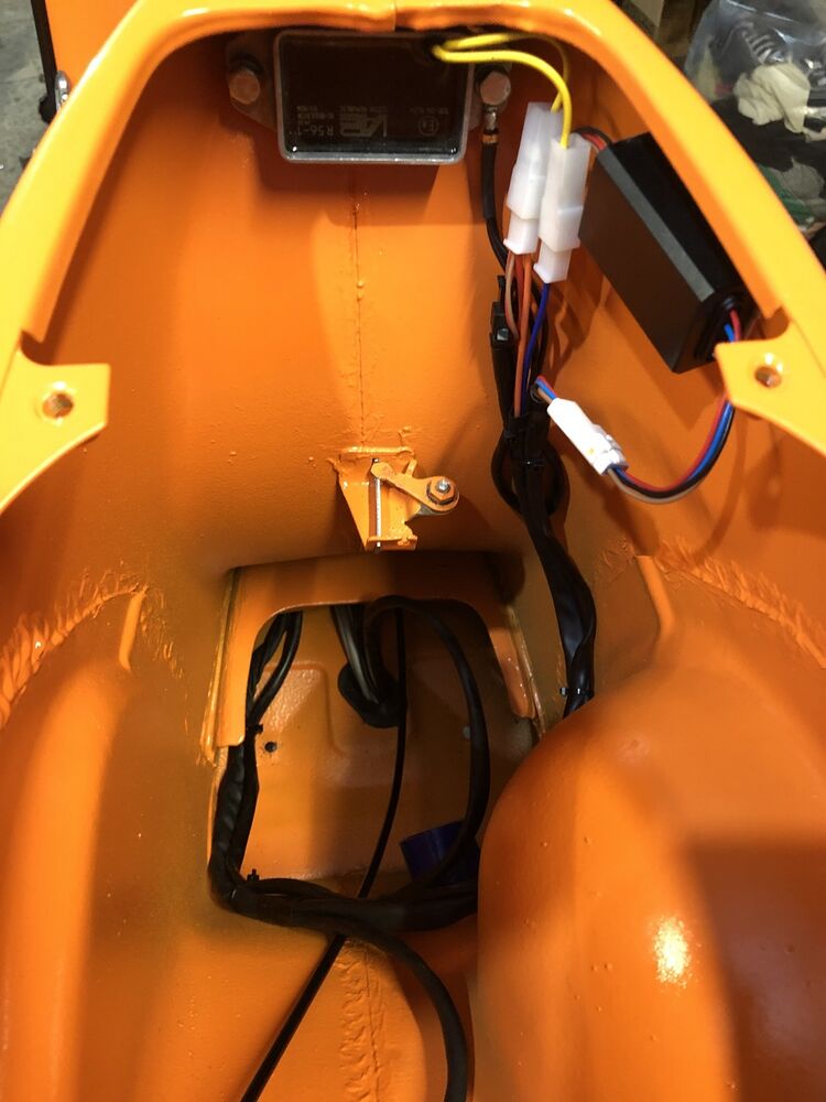

I used a SIP Vape regulator and made a bracket under the seat's hinge. For the CDI, I bought the following bracket that mounts on the existing coil holes. Comes near the shock…

Hey SaFis, did you mount the regulator to an interior brace? It looks like it's through the front of the frame and I'm too lazy to go back out to the workshop and look right now Razz emoticon

Of course. It's a bracket that's held by the seat's bolts…
I figured, but it wasn't clear from the picture and, like I said, I'm lazy right now.
