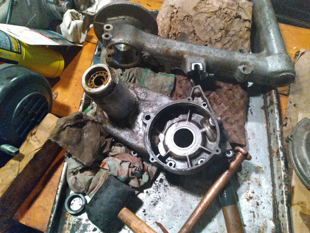

No real exciting updates, but the original motor is going to be used and I am starting to plug away at things.

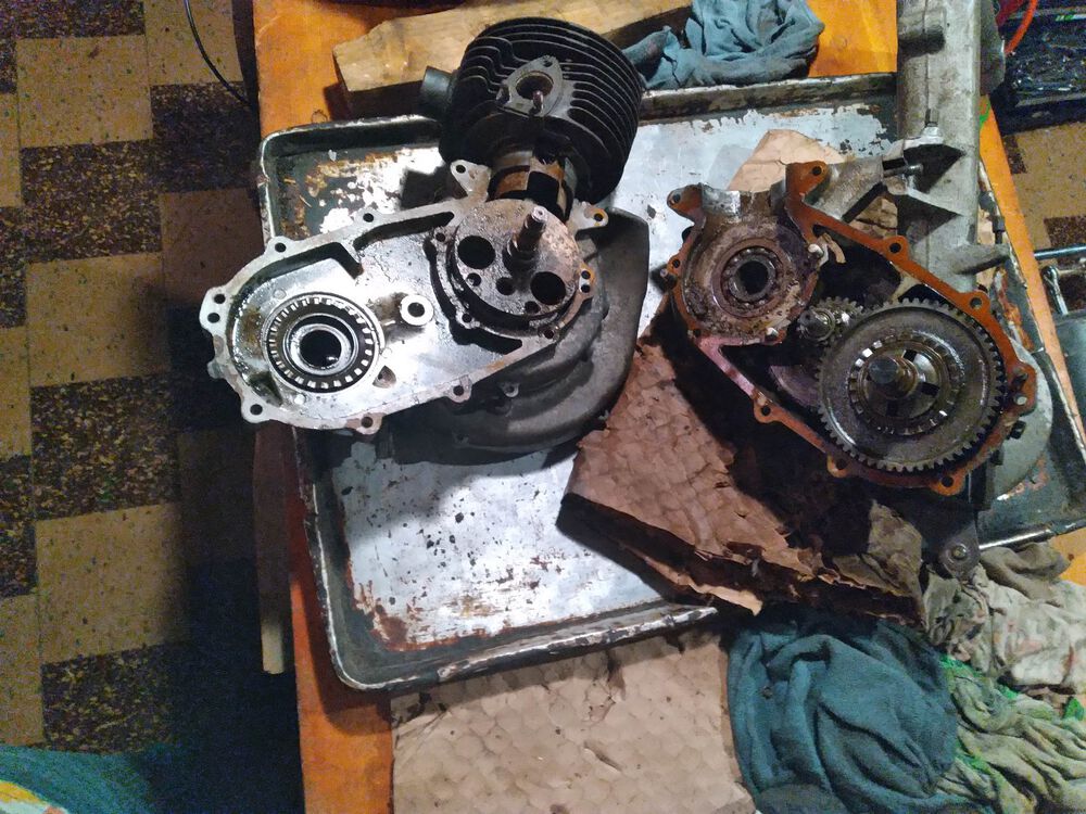

I dropped the motor and started disassembly. PB Blaster, a torch, some sage advice from more knowledgeable people, and more patience than I normally practice have gotten me this far.

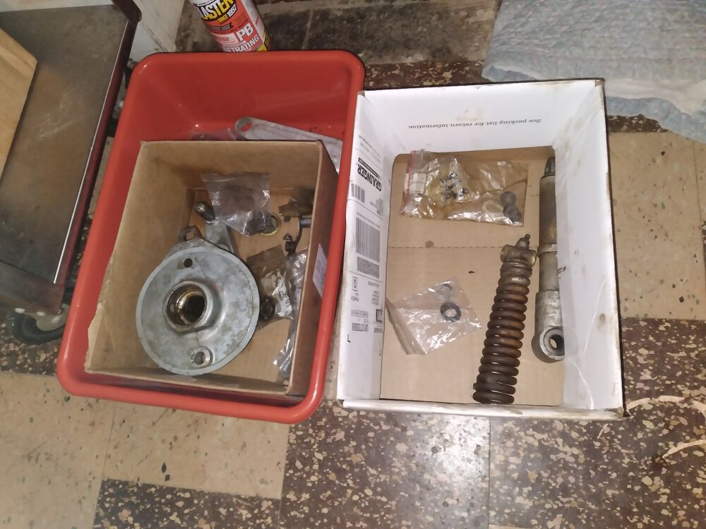

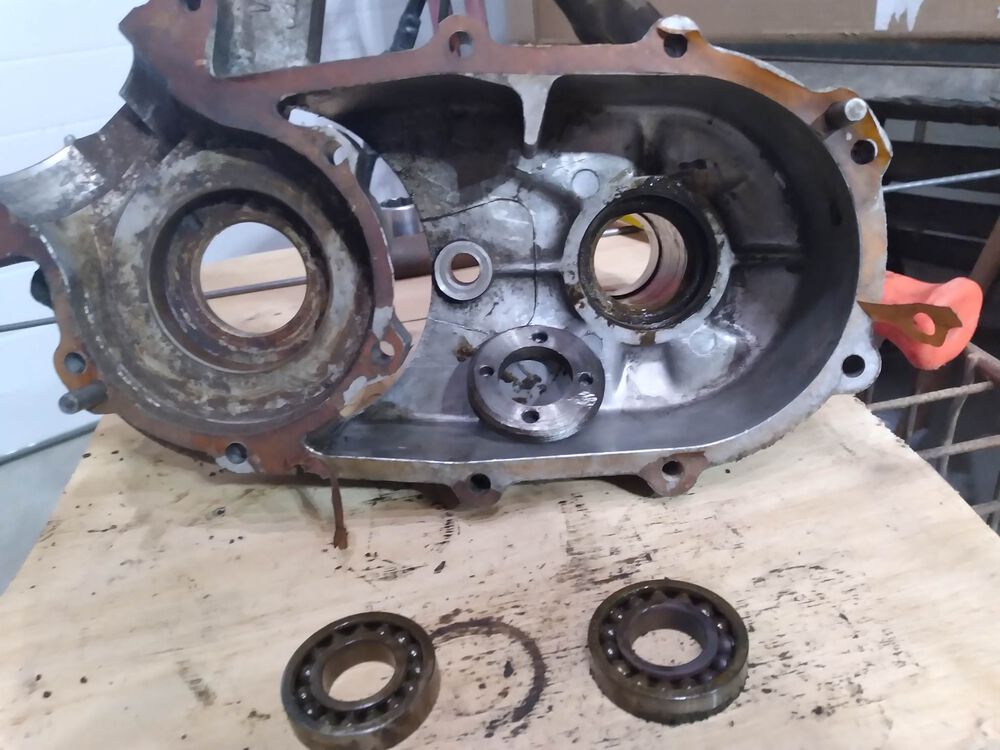

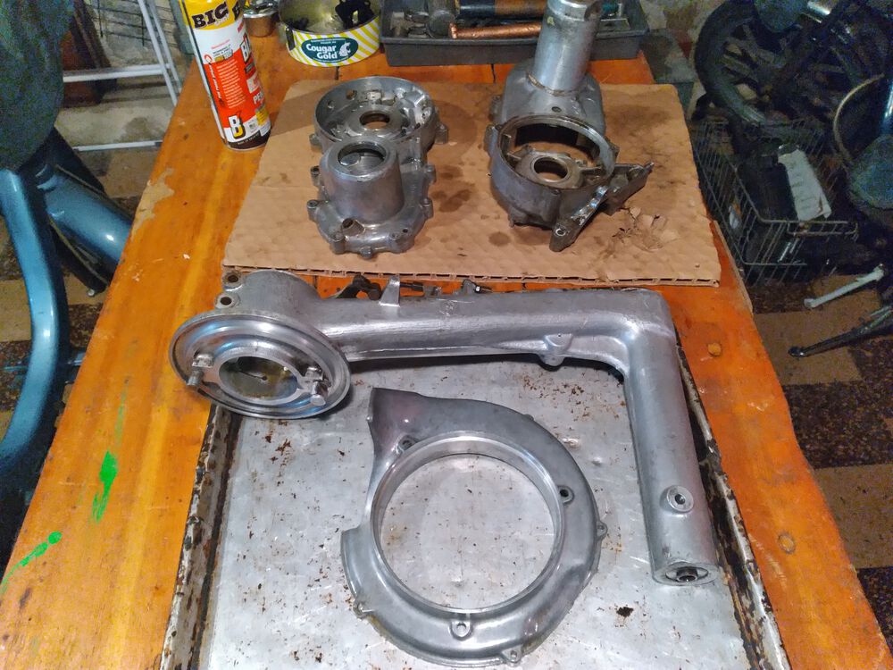

Motor is disassembled, ready to clean and begin rebuilding.

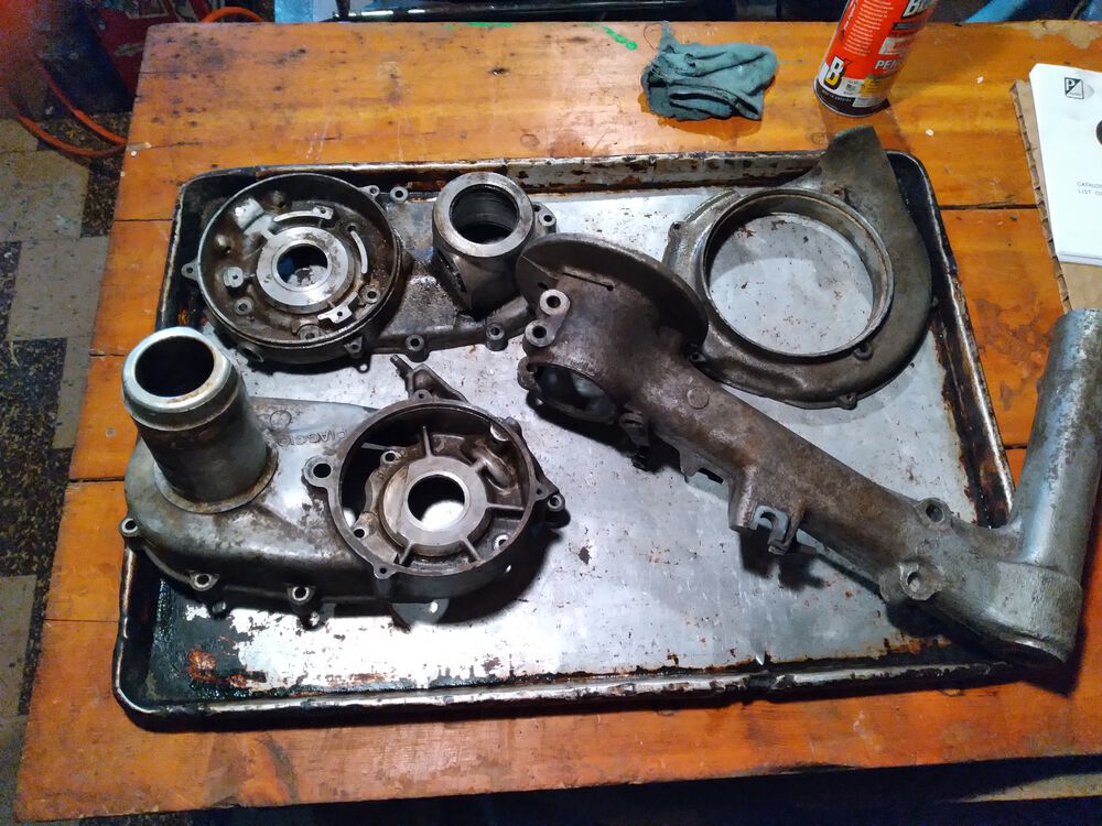

Cases need more scrubbing, but my hands are pruney and I need to get more scrubby pads.

Boy, that is looking good. I never get mine that clean except on the inside. Kudos!

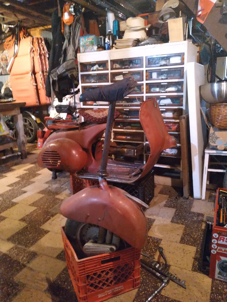

Lots of work to do to the rest of the bike too.

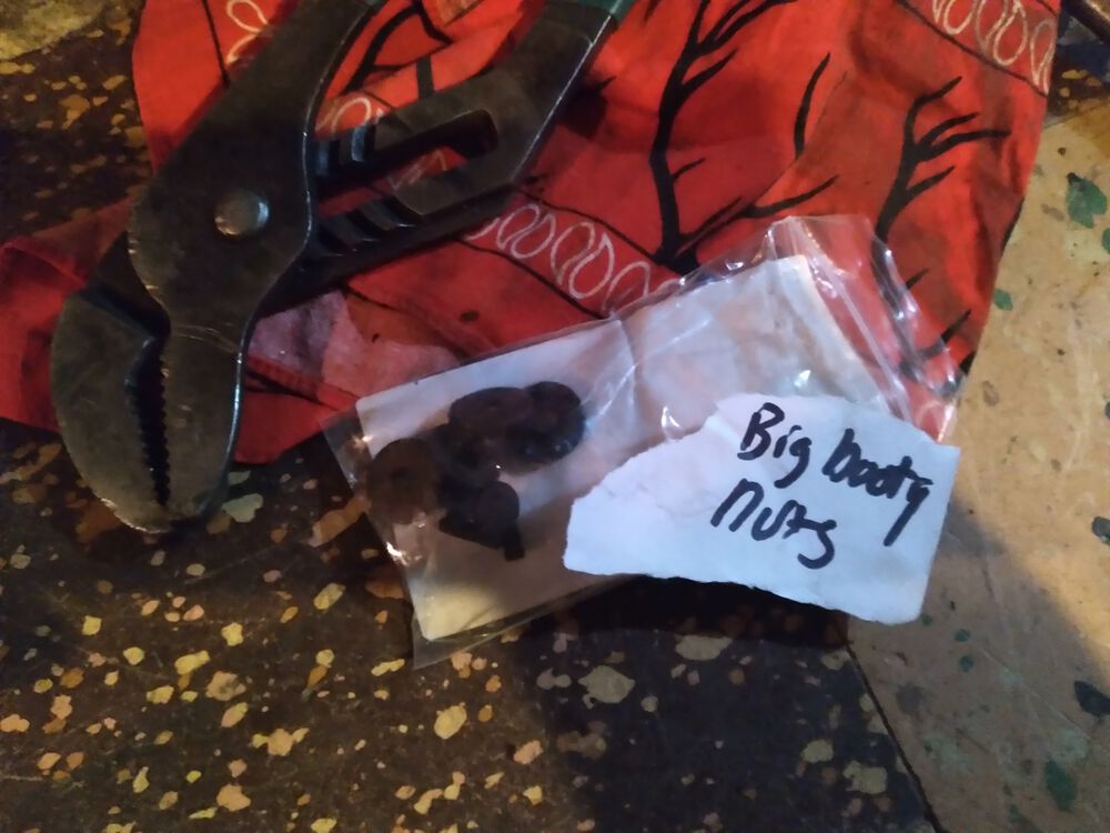

More disassembly and carefully labeling bits and pieces.

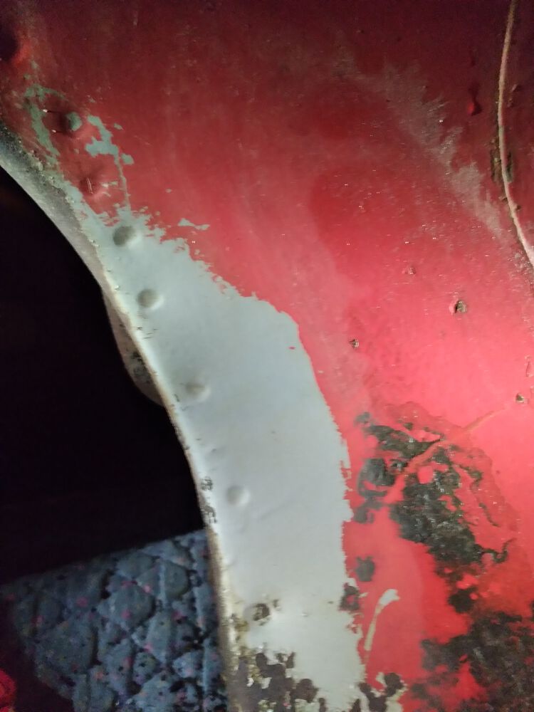

More progree, the fork hadbeen disassembled.

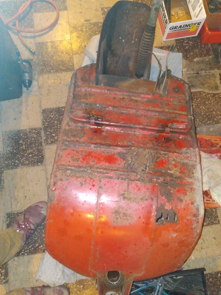

The bad. Floor board is worse than I initially thought, I considered patching the bad spots, but under advisement of a friend I am going to replace the whole floor. SIP carries a panel that looks like it wraps up far enough to help take care of this bad spot o the lower legshield.

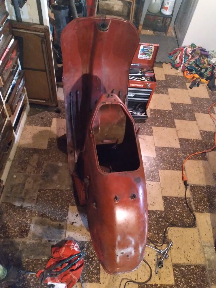

There is some original paint under all of this red.

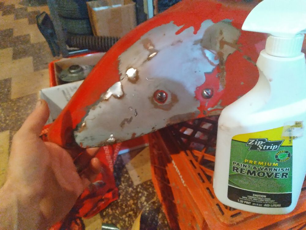

I am experimenting with some different strippers and tools for removing two layers of red paint. I finished the fender shortly after snapping this picture. I am going to try acetone and MEK and see if either of those is a bit faster than oven cleaner or the low odor stripper I tried.

Any tips?

I gave up on stripping my 200 very quickly. The original paint might have been decent under the respray, but stripping it was really slow. Hardware store strippers just suck now. Back in the late 80's I stripped the factory paint off a set of cowls in my girlfriend's driveway. Took the paint off in about 5 minutes before it went straight to work on the driveway. Her dad wasn't too happy.
Maybe aircraft stripper? I ended up using a fiber disk on an angle grinder and a wire wheel with a drill to get into tight spots. It's the easiest, fastest way, but it takes it down to bare metal. Citrus strip worked ok on smaller parts when covered with plastic, but required many rounds of applying and scraping. Most strippers leave factory paint intact.

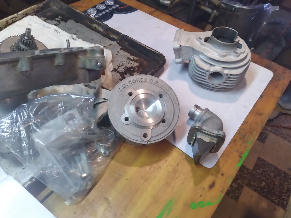

Still lots of work to do to the frame, bit I am getting close to putting the motor back together with some updates.

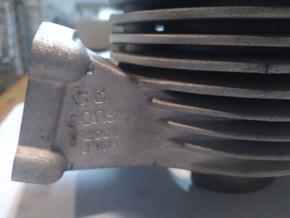

Very cool! That cylinder will be exact what the scooter needs to keep up with the times. I have a second VB1 project that i'm thinking about doing something with. The stock crank and cylinder are rusted together, so it's either spend a LOT of $$$$ on transforming the wideframe engine to something faster, or swap in a PX150 EFL autolube engine. I'd prefer keeping the wideframe engine, but good golly, if i went with Pinasco cases, 4 speed conversion, and all the others accoutrements that i want, it would be around $4k! I'll definitely be keeping a sharp eye on this thread!

For stripping paint….
Try citrus stripper and coat it on thick. Then cover it with plastic wrap (Saran wrap at the grocery store kind of stuff) and let it sit for a day. Should be much much easier to remove then.

Awesome, I will give that a try. I actually just grabbed some of that and haven't opened it yet.
Posts: 1805
Location: Philadelphia
Posts: 1805
I used that method on my bare metal bike. It was painted with a brush in sea foam green. There wasn't much original paint under it but it only took off the green. Then I removed the last bits of blue.
Keeping it wet is key. Once it dries out it stops working so the wrap helps greatly.
