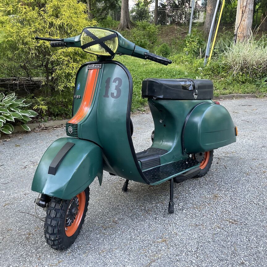

I have a 1983 Vespa P150S ( Indo. model). WAS running but very poorly. would kick over and rev super high. could not get the carb adjusted with turns. I switched the carb, then kicked over and ran a few times very weak and would stall. Then I prob. flooded it. Would not fire up at all. for 2 days. Then- Totally cleaned my orig. Dellorto carb.- jets and all- and put it back on. Will not fire up at all. Has good spark. getting fuel. Tried starting fluid etc. Tried putting it in 2nd and bump starting- for another 2 days. Has mildly low compression- 90 psi. Any help as to how to get this fired up would be greatly appreciated! Thanks
