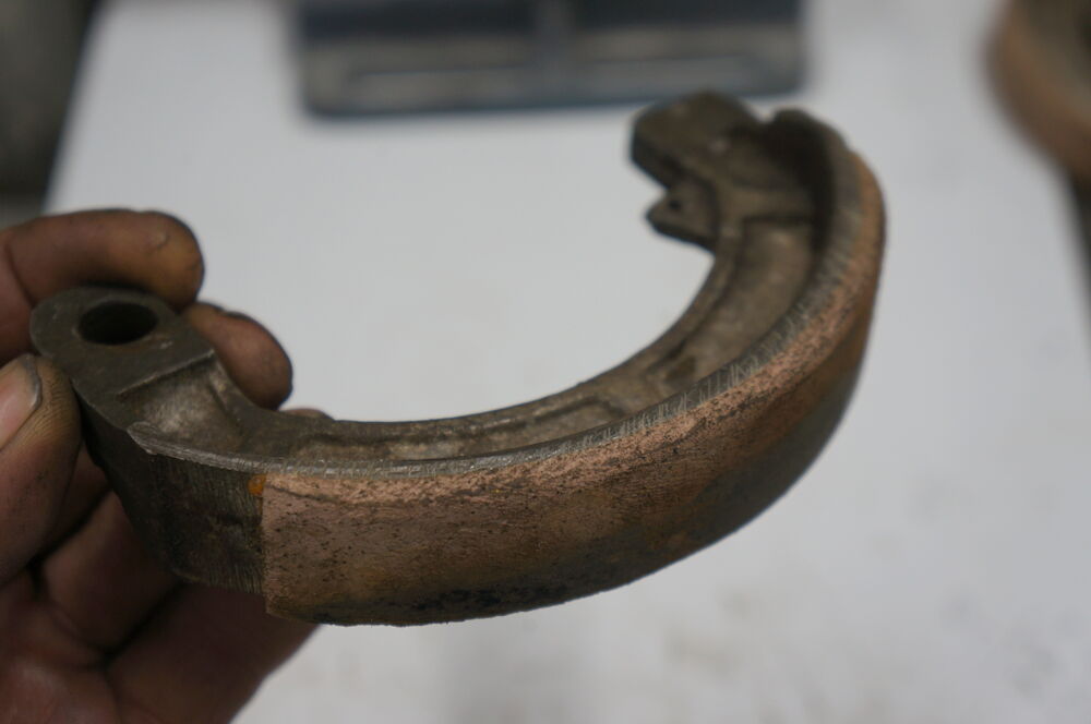

Check out these quality levers ! That's the casting not pitting.

The crankshaft : Maybe good, maybe not. Replace or reuse ?
It appears that the sealing surface on the inner web might have built up and re-ground and the pad on the case as well. The fit was correct but I don't know if it's to spec or just ground to fit, and I am afraid that a stock web will have a different radius and not fit properly. I measure the diameter of the inner crank web and at 98.65mm / 49.325mm radius ? Can anyone tell me if this right ? If a replacement crank won't fit, this one's going back in.
There was a .25mm washer under the CS bearing which stayed in the case. The inner web, along the opening, has contacted the case.
The conrod has been bushed, sealing the lube holes.
The odd casting of the piston pin bosses allow 3.5mm of lateral bearing movement. But maybe also more lubrication ? The cylinder is PAIJIFA : Taiwanese Bajaj.
It is my understanding that the owner's friend shipped this here from VN 20 years ago and the motor, which detonated, was soon sent back to be rebuilt and was never re-installed.

It was clearly a typical, worn out, old Vespa with with a worn out motor to begin with.
Some parts have been bushed. The throttle tube was brazed and ground but is still loose. They swapped the fork and the new bearings fit perfectly in the indents on the races.
The only possibly relevant mileage is on the repro speedo and I am guessing the thing ran for 240 miles before the motor crapped out.
What about that crank , anyway ?
Still loose. I can't imagine how it was before they fixed this.
still loose
Cap repair.
Maybe you've seen the video...

Crank's toast. They welded / filled and machined everything that was worn out or rotten. Cases too, looks like they pressed and pinned "new" bearing seats but looks like the bearing still rotated inside of it. And then there's that other stuff...
Personally, I would return the money and say goodbye to him. That thing will always bring trouble...
