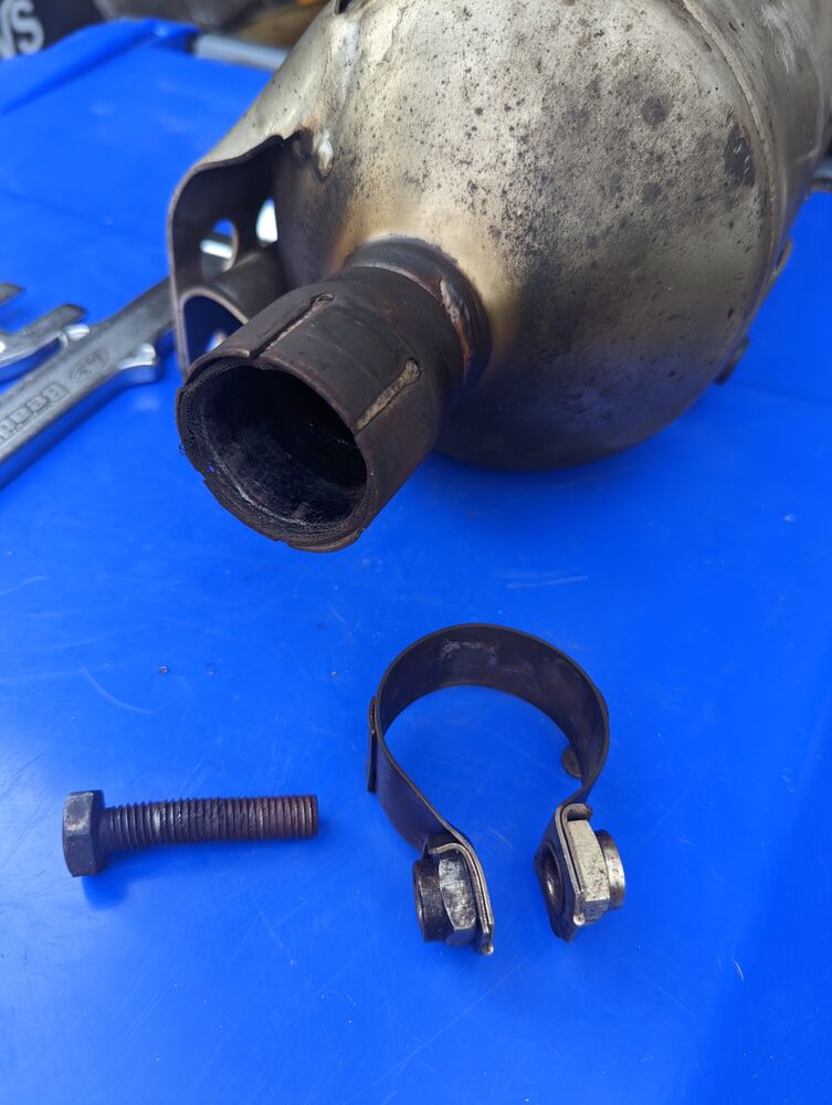

Used a crow bar and fulcrum to push it off. There will be an issue with the clamp for the muffler. The bolt is bent, it unthreaded but I will need to replace it. Can I match it at Home Despot?
Is this The graphene gasket and is it in good enough shape?

Very nice, Thank You.
The wheel is off, this was the first time changing a rear scooter tire. It's off the rim, which was quite difficult for me, I hope the mounting goes easier.
Are these different lengths? Is this HD Link 80mm in length and the Piaggio doesn't really mention it. I will bring it with me. I would appreciate being able to get one locally.

I believe the HD picture is a generic one for every M8 length. But this is HD - the item maybe wishful-ware and not exist at all!
