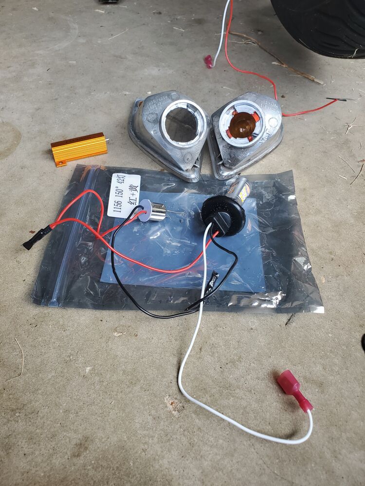

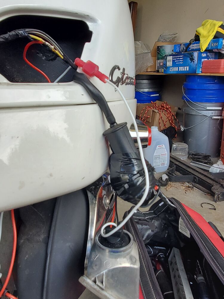

Hey guys, I did a euro turn signal conversion kit on my own Vespa... kinda.
I just ran some wire from the turn signal connectors (by the headlight), down the steering column, to the back of the running light. Then I swapped my running lights with my turn signals.
Obviously this will only work as a turn signal, no running light, but hey, it didn't cost me anything and I needed to do it (new headlight cover I got didn't have the holes).
So for now at least, I have working signals, though I've lost my running lights
Does anyone have any ideas from here or is my project done?

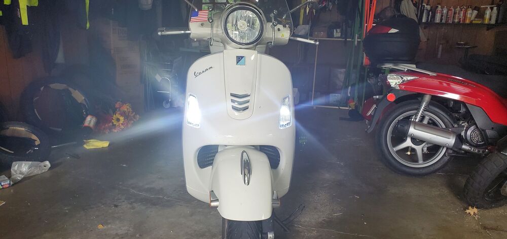

I have switchback LED's mounted on the front of my 150 and they work great. They mount where the pods used to be. They are a "shimmering" white all the time unless that indicator is on, and then they switch to yellow.

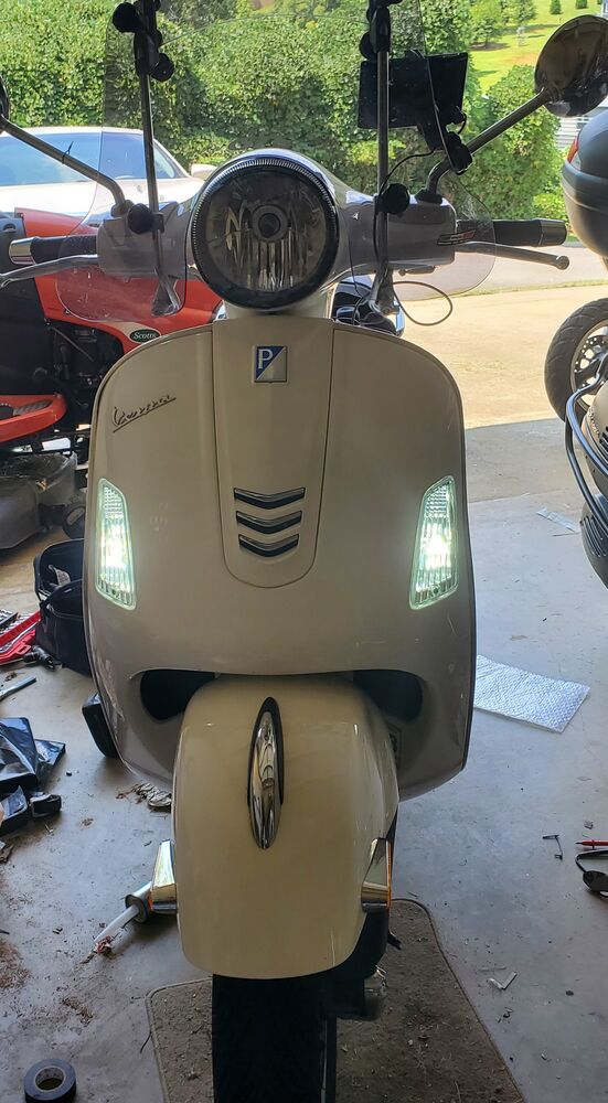

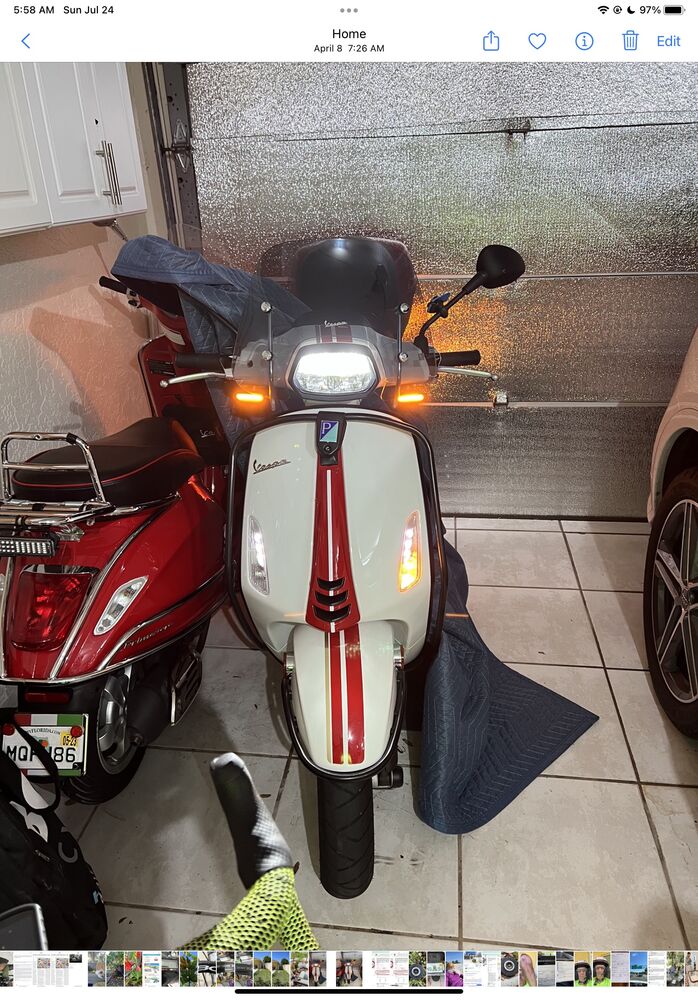

My front extra lights are made by Skene.
https://www.skenelights.com/online-store
Mine are called photon blasters. I waited a long time to order these because they are so expensive. The wiring diagrams are on their site and I think specific to their units.
But these are bright and I believe make my bike more visible from the front. They are DRL's until I turn on the indicator light. Then they turn yellow and blink. Very nice IMO
But others make switchback lights.
Is your goal now to add back running lights for the front. I have a suggestion if so.
Front running lights which replace the pods
Closeup of skene photon blaster. Mounts where pod light was

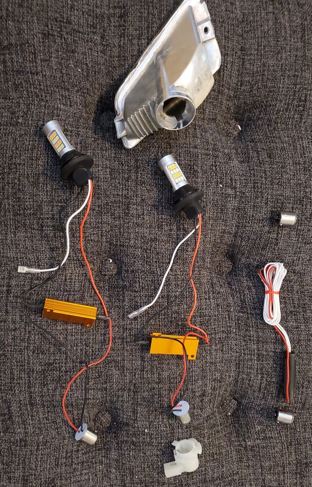

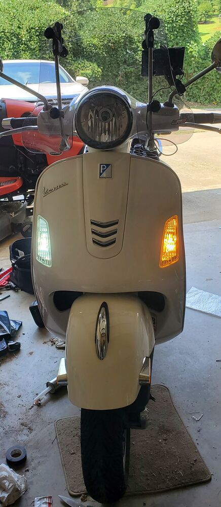

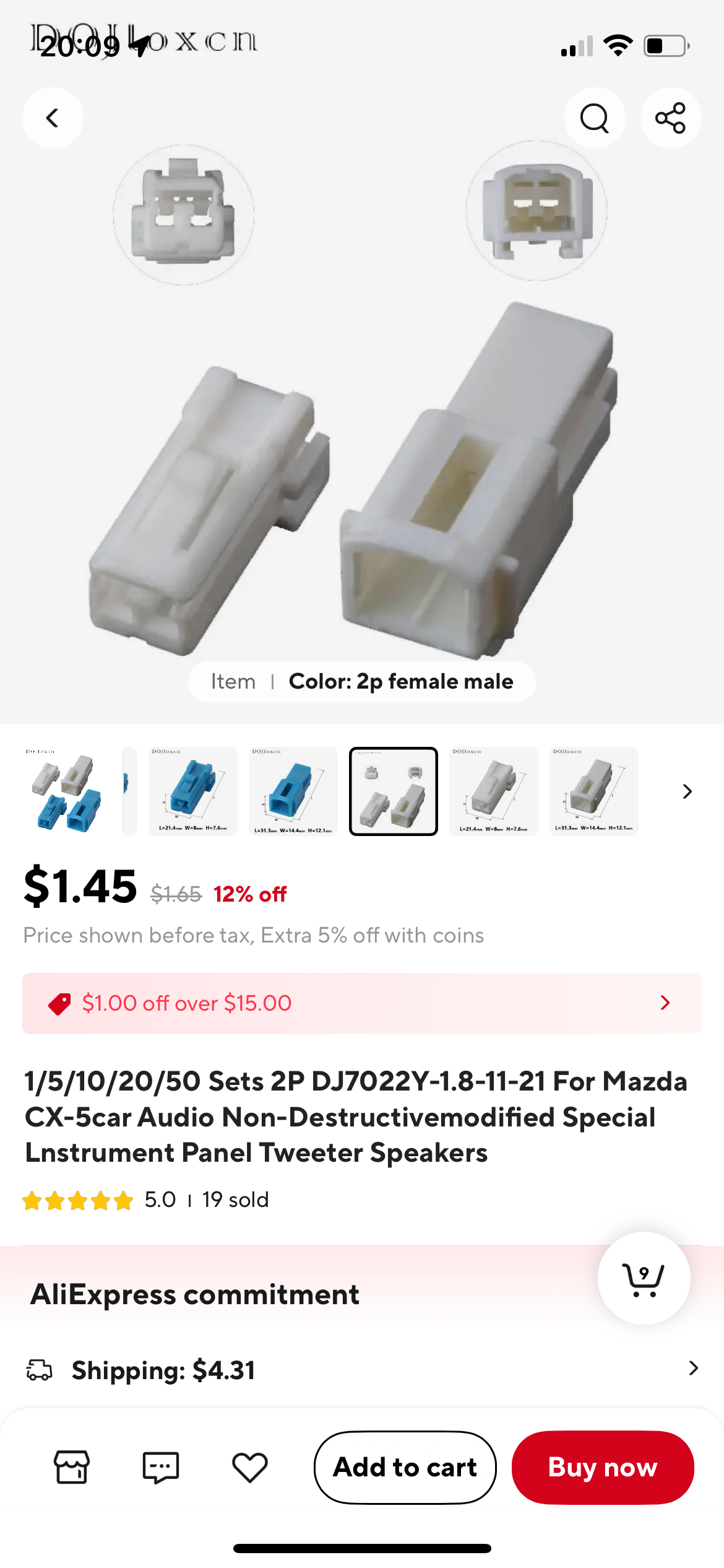

They make bau16/bsu16s switchback LEDs that fit the Vespa socket. Google it. Maybe start there?
What puzzles me is how you supply flasher and separate power on a two pin connector .

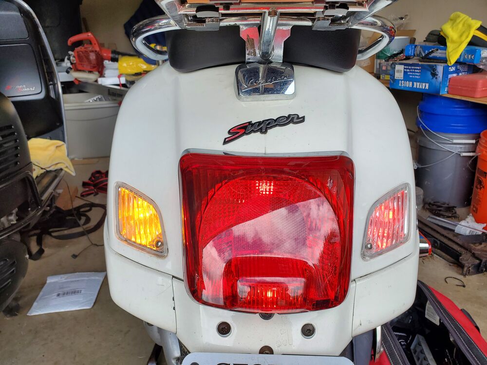

I just put on a set of front and back smoke lens lights from China. They required a bit of modification to run fronts and backs, but I have it all up and running. I had to remove the original 33ohm resistors and put in some 6ohm. Total price front and backs plus 6ohm resistors and SAE connectors was $142. These plug into the original harness. For running light power, I tapped the add a circuit line that I put in for the kneepad electronics. The resistor plate is mounted to one of the empty relay slots behind the horn cover. The resistors COULD get hot if one left the blinker on for an extended period of time. You could hold it in my hand fir about a minute of blinking before it got too hot to hold. The resistors plug into the LED harness via an SAE connector so that any part of the assembly can be removed at any time without cutting anything.

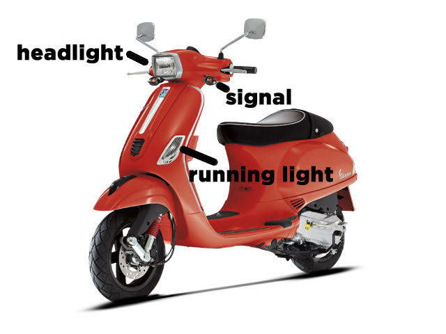

I have no idea if this is what they're really called, but this is what I call them.

Dear Adri,
The drawing really helps.
In your first post of this thread, you say you ran wires down to the running light. You don't say you removed the right and left signals(you label just the left signal).
1. Did you remove the signals? (AKA PODS)
2. Did your scooter have rear signal pods?
My primavera 50 came with working running lights (4 led bulbs) but the light fixture also had an empty hole where you can snap in another bulb holder. That bulb is for the blinker light. I believe European versions of my 50 ship without signal pods (these are just for U.S.specs) and the running light (aka DRL FOR DAYTIME RUNNING LIGHT) had the blinker bulb wired in.
My 50 had right and left rear signal pods too.
3. Where is your rear running light located originally.
Sorry for the laborious explanation but we have many labels and the U.S. version and rest of world version. It gets confusing! (To me anyway)

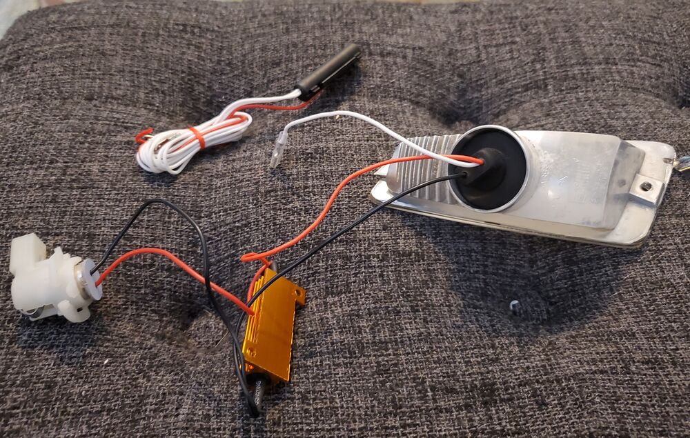

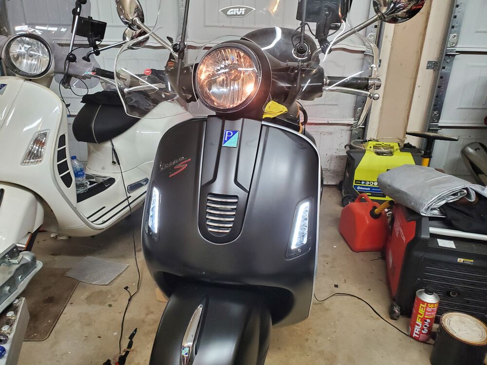

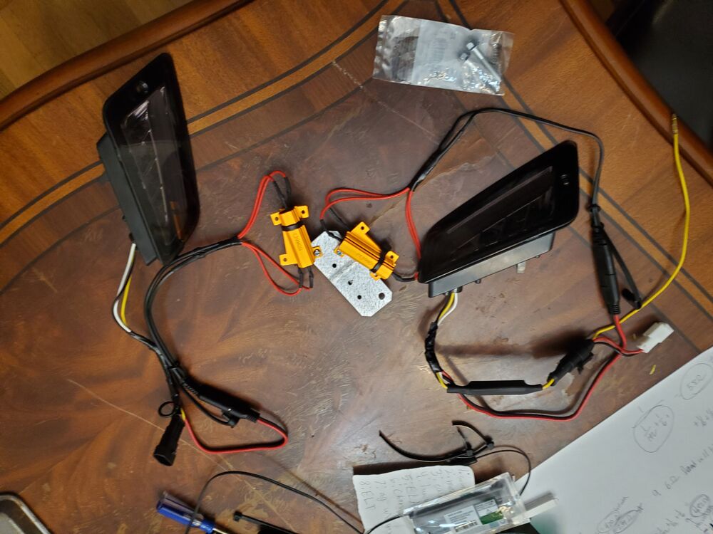

Parts arrived tonight, it's 2:30 am, just got in from the garage, time for a little update...
Bad news first. The parts I got were functionally good, but the application wasn't relevant to our Vespe so I needed to cut one part of the factory harness. Bummer. I really didn't want to do that but oh well.
Good news now... It works! I have no more pods, and what were my DRL (day light running lights) are now both DRLs UNTIL I hit the turn signal. THEN one stays a white running light while the other flashes amber.
When I started doing this I wanted to create a shopping list like I do for most of my how-to content ("here's what you need, here's how to use it"), or if I could find the connectors Piaggio uses I thought I could even premake little wiring harnesses for people that would work out to a lot less than what scooter west charges. Unfortunately this turned out not to be plug play after all.
I was really excited when I came in. Now I'm just exhausted. I'll give more detail in the next couple days and some basic instructions, and then I'll do a detailed how to with a detailed article and a video after that.
First, sleep.

I just got this ebay kit in: switchback bulbs/ resistors/ ba connector plus a fused power cord for running light power. The bulb fits good (see pic). I'm going to install this weekend or next and I'll let you know how it went.
@adri avatar
Atypical Canadian
Posts: 2319
Location: Toronto, Canada
Atypical Canadian
@adri avatar
Posts: 2319
Your kit has even more than mine (I don't have the extra wire and 1156s on the far right).
Mine required me to do some splicing, which was a bummer because I wanted to make something really easy that anybody wouldn't be afraid to do and I know that will turn some people off... but I also lost the "pods".
It looks like with your kit your might be keeping not have to splice anything if you can run the wiring out of the way.
I'll take some pics or shoot a quick video if I can motivate myself to put some shorts on and go to the garage later.

And here it is installed one pic with running lights, the other with one blinker on...of course you can't see that, but I caught it in the "on" portion of the cycle. BTW, I tapped into the power that I ran for the knee pad, no splicing into the original harness. This was the Item I purchased, it was $17.73 when I ordered
https://www.ebay.com/itm/283950567935?mkcid=16&mkevt=1&mkrid=711-127632-2357-0&ssspo=JnXzYf4WSCa&sssrc=2349624&ssuid=5hcLMq5XR1C&var=&widget_ver=artemis&media=SMS
If I can get the same kit in amber/red, I'm going to do the rear lights.

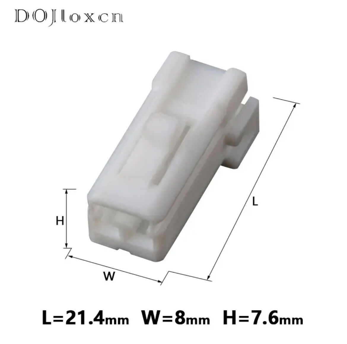

I'm psyched this worked for you! I'm glad even though I couldn't figure out a cheap plug and play alternative to the expensive Scooter West options, someone else did!
Mine works identical to yours but came with less parts and wasn't plug and play though it cost about the same so yours is a better solution.

I installed the ScooterWest kit for front running lights and amber turn signals.
Worked great but the amount of light was poor.
Bought switchback bulbs from Amazon---MUCH better
https://www.amazon.com/dp/B01M26IHAR?psc=1&ref=ppx_yo2ov_dt_b_product_details
I also replaced the flasher, makes it much easier.
Amazon bulb vs ScooterWest bulb

Amazon bulb looks so much better and more full.

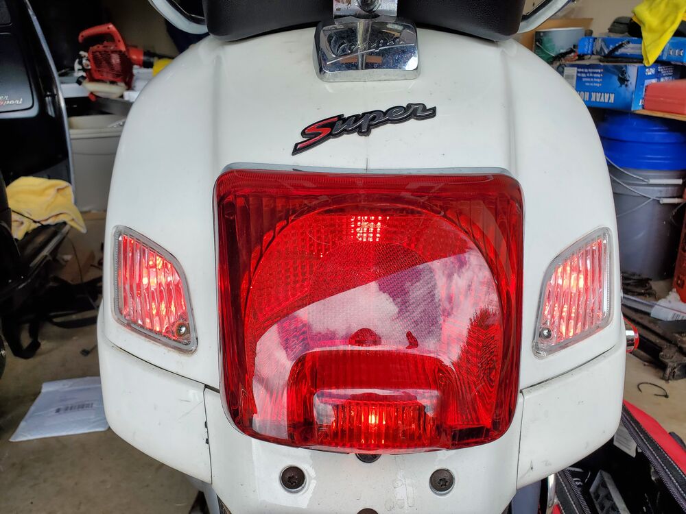

Okay. The rear kit is in and installed. Power resistors have been removed. This wasn't completely plug and play...
The rear lights have an amber dome built in so that the user can use an amber or clear bulb. In order to remove the amber dome, I took a Dremel and sanding drum and took out just enough plastic to allow the dome to drop out. I left a lip for the LED bulb to grab. I soldered and taped the power connection, and tie wrapped it in.
Posts: 432
Location: Dahlonega, GA
Posts: 432
So, to do the whole bike,
Front kit was $17
Rear kit was $13
LED flasher was $8
I had to irreversibly modify the rear lights. I had a spare from the smoke lens kit that I installed on my other GTS, so it didn't bother me to take s Dremel to them. Go slow, and grind in little bits. You want to leave as much lip as possible. The dome should barely slide out.

just installed led turn indicator bulbs and new relay in my supertech (australian - doesn't have those funny US pods).
all cheap from aliexpress
front https://www.aliexpress.com/item/1005002664281392.html
rear https://www.aliexpress.com/item/32833851193.html
led relay https://www.aliexpress.com/item/1005002982539917.html https://www.aliexpress.com/item/1005009496330264.html
bulbs I used are the 120 degree BAY9S with one pin filed like somebody else here mentioned. (instead of the correct BAZ9S)
why different front and rear? cause I couldn't make up my mind the front turned out to be definitely brighter than standard and rear similar / slightly brighter to standard.
getting at the relay was a pain as it's tucked behind the pmp2 (bluetooth) module so had to take the glovebox half off and then swear and curse a bit while squeezing my hand in

These will fit a 2021 gts turn signals. At least the housing fits. I'll get around to wiring it when the weather cools and I find where the relay is located. [/img]
