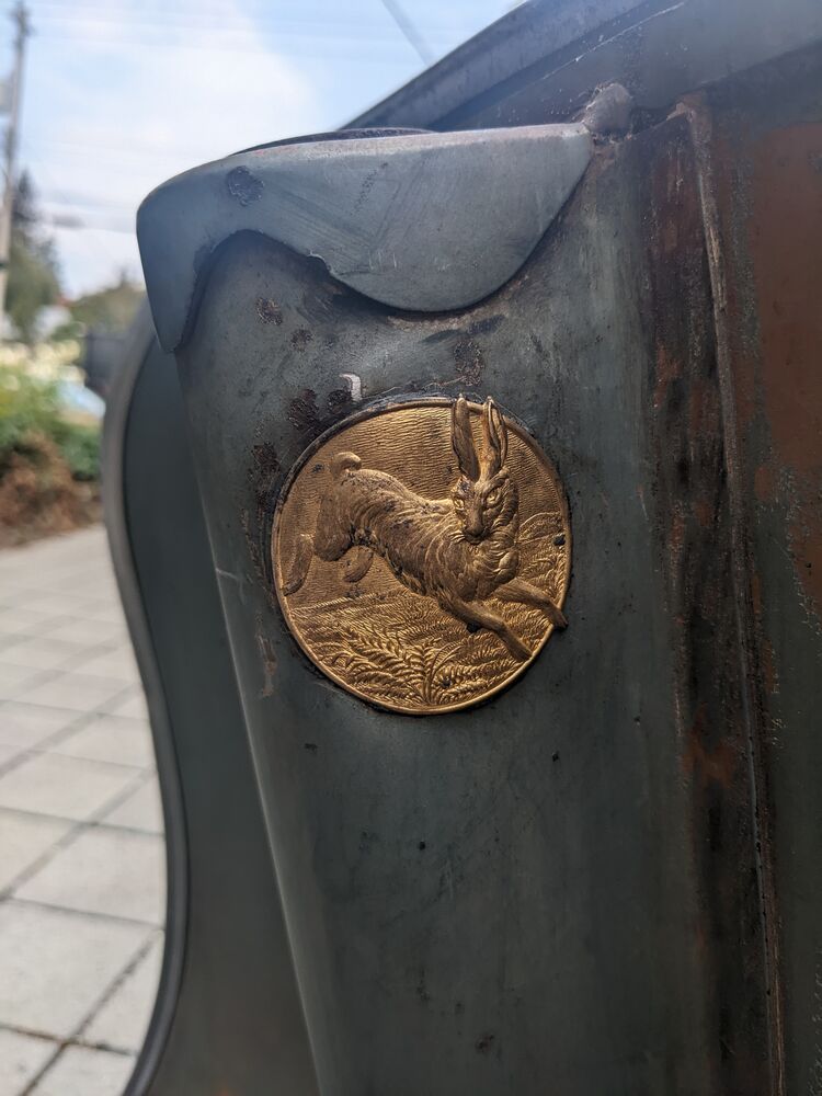

I picked up a new winter project yesterday from Voodoo, although at the rate I've torn into it, I don't know if it will last me the winter. Its a 1959 VBA1T with a 1961 150 motor. I'd first stumbled across this scoot about a year ago in his basement and then while I thought about whether I actually wanted to buy it, V started fixing it up. I had to promise to not paint it but that was always in agreement with my aesthetic as well. The goal it to have a mechanically pristine scoot with a time-capsue preserved body. So this morning I woke up and got to work stripping everything back to a heap of parts. This scoot spent the majority of its life sittng in the eastern WA high desert and except for one tiny pinhole on the underside I cannot find any real through rust or areas of concern. So while I wait for a big parts order, I'll work on the body. Today having it stripped, I then went over the entire bike with a scotchbrite pad and a 50% CLR solution. I'd read about this on some car patina forums and its supposed to strip back rust that has covered the remaining paint. Then a thin coat of boiled linseed oil for some surface protection.
Everything else gets vapor blasted, sand blasted, painted,replaced, or somehow restored to pristine condition.
Oh yeah, and this came to me with a WA title and a collector plate. Only took me 15 minutes to get the car registered. Thanks Voodoo!

They look fantastic when the surface is like that, rustic but not rusty.

Voodoo did you right. Fantastic project with just some mechanicals to work out.

That. Is. Beautiful.
Omg. You lucky SOB.
That hub does look like someone rewelded the studs.

Oh my... it's perfect...

That scoot has got amazing patina! Hard to believe the year of vintage and the rugged yet still attractive physical condition go together. Kinda like Tom Cruise in Top Gun Maverick….. never mind.
