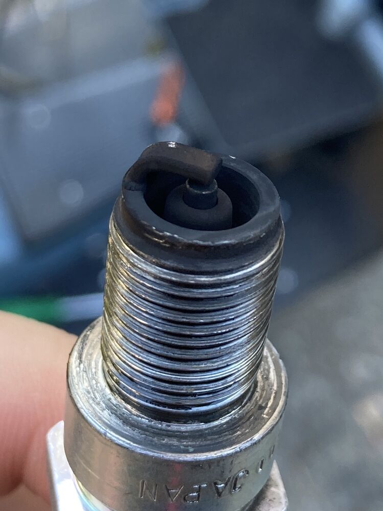

Hi there!
I'm really don't wanted to start this thread as I thought that I can figure out all by myself.
But I can't.
I hope someone can help me with right jetting.
Prehistory:
P150X not matching ports with DR 177 and Malossi cylinder head.
Rotary intake
SI 24/24 E drilled 2.5mm: AC 160 - BE3 -125 MJ and 55/160 idle.
Original air filter with drilled holes above jets
Mazzucchelli racing crankshaft 57mm stroke
22/68 primary
SIP Road 2 exhaust
SIP Touren flywheel 1.6 KG
SIP fast flow fuel tap.
I ride on that setup near 7000 miles short in town and really long hard runs on the mountain roads. Everything was fine, plug colour is right, I can easily hold 55-57 MPH for a really long time and temperature holds on 275-285º F.
Then I change exhaust for Polini Box and like it more than old despite I lost 2-3 miles of max speed. Still runs perfect without any other changes.
And then I put new SIP T5 air filter and Polini carb case cover. Run for a long stretch and I see that the temperature is growing faster and already at 50 MPH it easily reach 300ºF and continues grow up. Obviously jetting is too lean.
Then I change idle jet for 50/140 and main jet for 128. But it seems that it not helps really.
So its time to play with air corrector and mixer tube?
I don't understand anything at all, please help me understand. Maybe there is some links where I can read about SI carb settings? TIA.

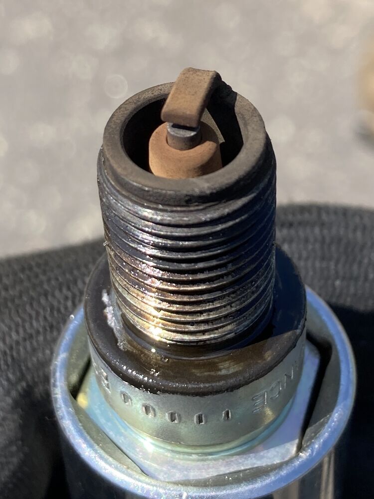

Start with a 120AC this will richen things up. I tried a 110AC but went back to the 120.
You can try a larger mixer and see how that does. It's going to be some trial and error to find the best recipe. Think the higher temps could indicate better air flow with new filter. How does it feel?

AC120/BE4 and work from there. Usually about 115
It will be quicker once jetted better. With the polini exhaust it would pull a 23/68.

Comparing your spec. with mine:
You
Rotary intake
22/68 primary
SIP Road 2 exhaust
Me
PX150 with ports enlarged, matched DR 177, cylinder raised 1.0mm
VMC Super G cylinder head.
Rotary intake (inlet enlarged)
SI 24/24 E drilled 2.5mm: AC 120 - BE4 -115 MJ and 52/140 idle.
Venturi (OopsClunkThud/Shapeways) and stock autolube box top
Jasil racing crankshaft 57mm stroke
23/68 primary
BGM BigBox Touring exhaust
Stock flywheel 2.2 KG
BGM fast flow fuel tap
Very similar setups, although I have done some porting/enlarging/matching and raised the cylinder for better port timings. For a DR177, it has really good power and ~62 mph/100 kmh top speed. It is very solid and reliable.
I agree with others that AC120 and BE4 is the way to go, especially with a venturi, or in your case a T5 filter and increased air box volume. Also, if you have the power, the 23T clutch is a good move to get the best top speed.

On next three photos is spark plug colour(as camera distorts in reality colour is more dark) with:
Polini Box exhaust
Polini carb cover
SIP T5 air filter
AC 160 mix BE3 mj 128 ij 52/140
There was near 12ºC(53ºF)
And for comparison on last two photos is spark plug colour with old set up:
SIP Road 2 exhaust
Original low carb cover
Original 20/20 drilled air filter
AC 160 mix BE3 mj 125 ij 55/160
There was near +25ºC(77ºF)

And here is plug colour with
AC 120
Mix BE4
Main jet 122
Idle jet 52/140(2.69)
Mix screw 2.5 out
AC 120 BE4 mj 122 ij 52/140(2.69) mix 2.5 out

Thu, 06 Oct 2022 11:34:04 +0000 quote
Ray8 you absolutely right. But it is boring to do nothing. I like to spend time with my Vespas And I also want to learn more about SI carb settings, not only how to change main jet.
Checked plug today. It is after 150-170 km with:
AC 120
BE4
MJ 122
IJ 55/160
Mix 2.5 out
Obviously too rich.

Thu, 06 Oct 2022 12:33:41 +0000 quote
Keep generally the same but change to BE3. Adjust the main jet down starting at about 128 to confirm WOT is still rich.
It's a nice feeling when the SI carb is as smooth as factory stock but a lot faster. Saves loads on fuel too.

Thu, 06 Oct 2022 13:16:23 +0000 quote
So I stay with AC120?

Thu, 06 Oct 2022 14:13:38 +0000 quote
Yes, AC120. Once the main jet is set correctly at WOT, the size will determine the next steps.

Thu, 06 Oct 2022 15:06:15 +0000 quote
@roland87 -- I'd followed Jack221's advice there on jetting and am very pleased with the results. This factory-like smoothness is immensely satisfying. Keep going!
(I'm on a 120/BE5 stack on an SI24, except with a Malossi 221 setup, and landed at a 128 main jet.)
