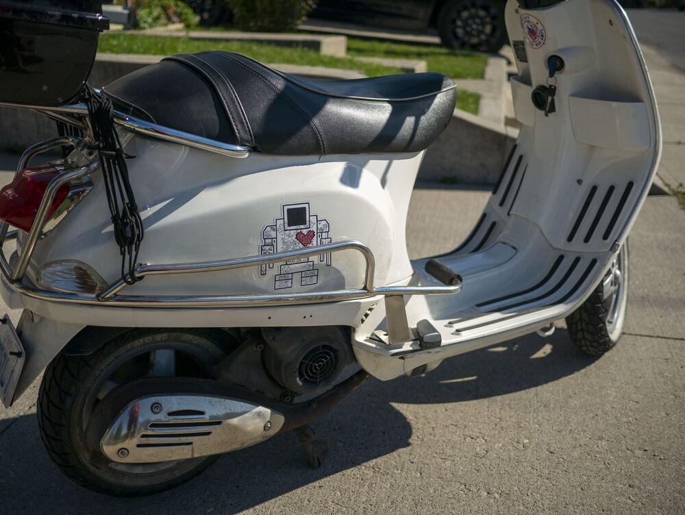

Issue #1: On my current Vespa S, my topcase's padding comes to BEHIND the end of the seat. Passenger can use all of her seat and then a little more behind it.
On the Primavera, the topcase and the backrest hang over the rear seat, so the passenger can't use all of her seat, gets pushed forward into me, and we are more cramped.
Is there a way to mount the factory topcase BEHIND the end of the seat, rather than over it? Any parts/suggestions/pics welcome

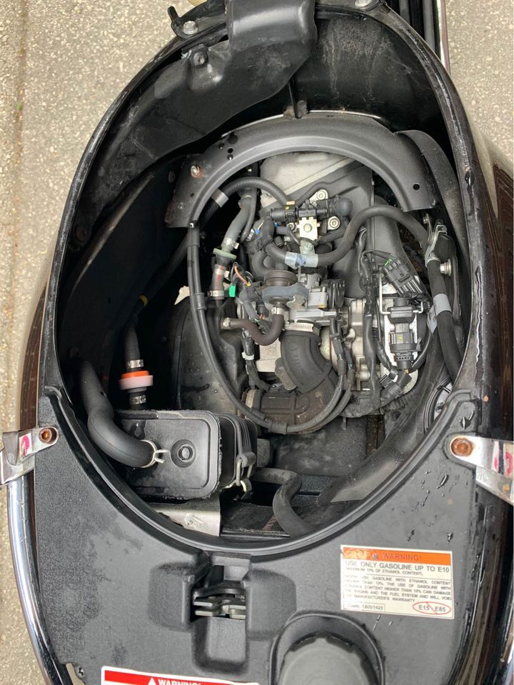

The Primavera's under seat storage has this notch in the pet carrier. It's a cut out for what I believe is 1B0045715 - PIAGGIO VESPA - FUEL FILTER CANISTER.
I'm assuming that means it's the charcoal cannister for the evap system? Is it possible to eliminate the evap system, then get a pet carrier from another region that doesn't have that notch, and therefore have a bigger storage space under the seat and at least carry store one helmet?

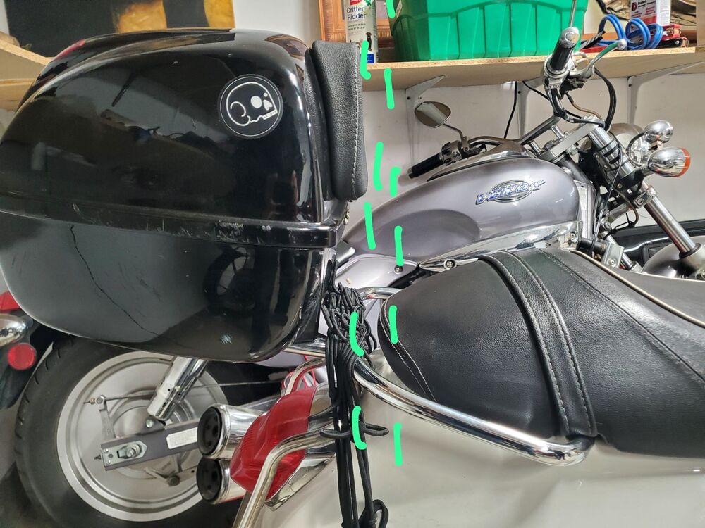

Pic of the current Vespa S mount for clarity:
On the Vespa S, we have a nice little gap for my passenger to slide her fine booty all the way back and give me lots of room. On the Primavera the top case takes up room over the seat and pushes her forward making us both less comfy. Any advice?

Yes trash the evap and get a pet carrier from a country that doesn't care about the environment. Or NZ.

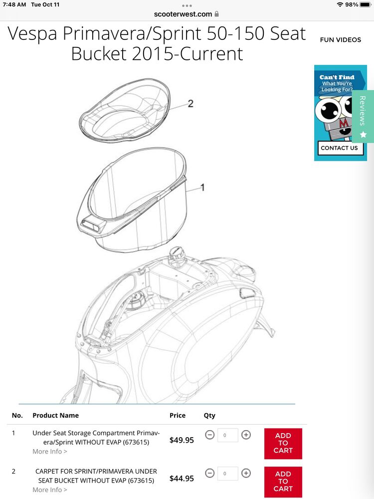

I'll look for a thread with info on this, thanks! Looks like ScooterWest will sell me the bucket if my local dealer can't... but I'm sure he probably can if it's available from Piaggio.

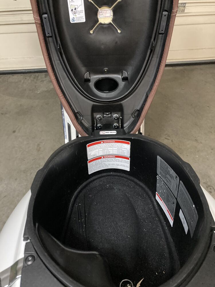

Additional seat pic if this helps.

Had a lot of success finding info on evap system removal for the older LX motors, and the GTS300, but nothing for the Primavera or Sprint. Has anyone done that before?

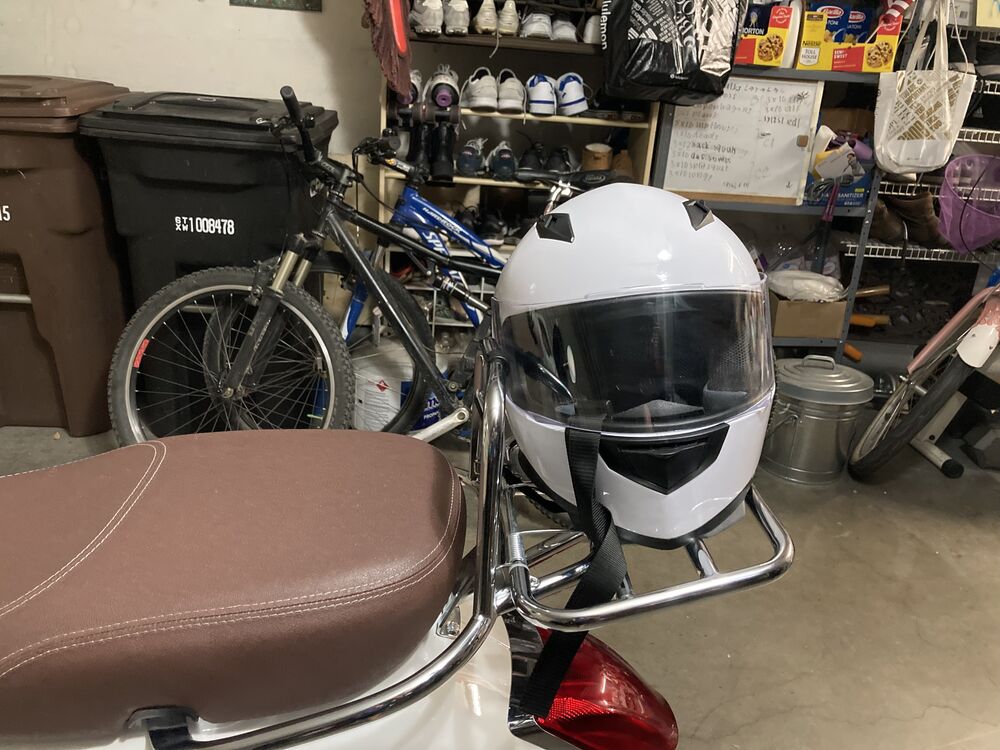

Pretty sure this is it from scooterwest, insulation sold separately.

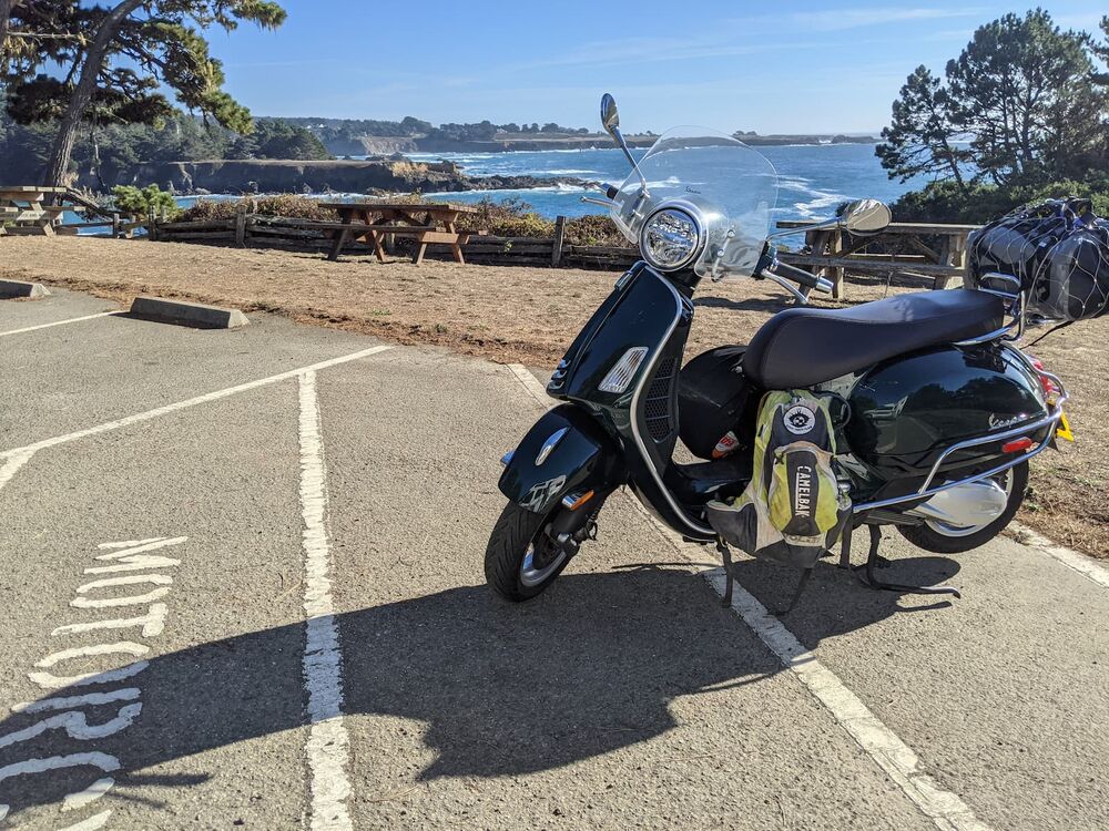

Also OE rear rack makes the perfect backstop for my passengers on my 2018 Primavera

Hey CC - does your rear rack's cushion overhang over your rear seat, or does it stop well behind where the seat ends like on my S:

Yeah you got it. That's the right part number. Bigger issue is just the CO box that sticks out would interfere so that whole evap system needs to go. (pic below)
I'm also wondering if our helmets are going to be too wide to fit under the seat even if we switch the bucket to the 673615 no evap bucket... I'm going to ride down to the local dealer as they're closer and get their input.

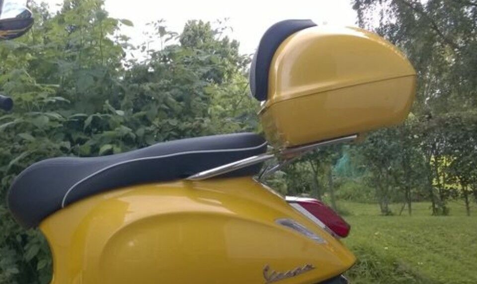

The top box/back rest in my Sprint looked like this.
I believe Primavera has excatly the same set up.
It is closer to the seat....but the useful part of the seat is still useful, no major difference there
A word of warning - I had the Euro spec pet carrier, no evap hump.
Still, my full face Arai, size M, did not fit under the seat...nor did it fit to the OEM Sprint/Primavera top box

I thought about putting a rear pad on it but my main passenger said it's good the way it is

I think RRider is right, bucket and cut out on seat bottom is pretty shallow compared to the Buddy 125 I had that fit my extra large full face helmet fine.

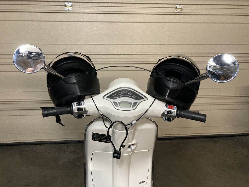

Here is what I do with my no D-ring helmets but they are $80 helmets and I live in a low moisture area
