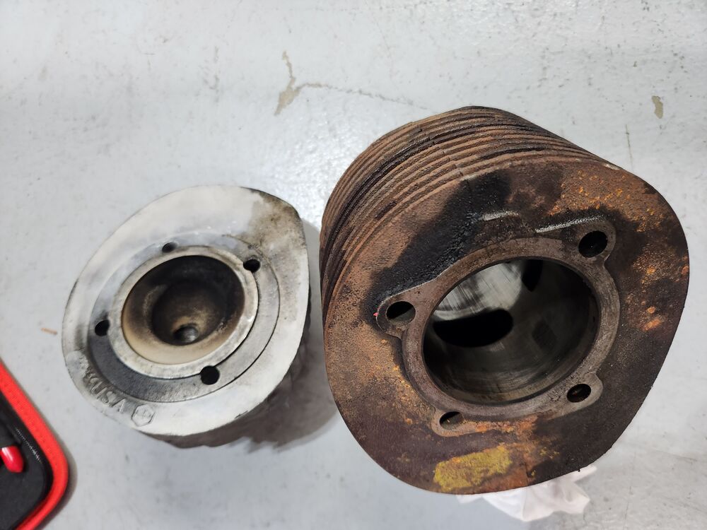

3) looking at this picture...do cylinder and head look ok to you? The piston has a black carbon patina at the top and the ring look fairly loose and rotate freely (but maybe that's ok)

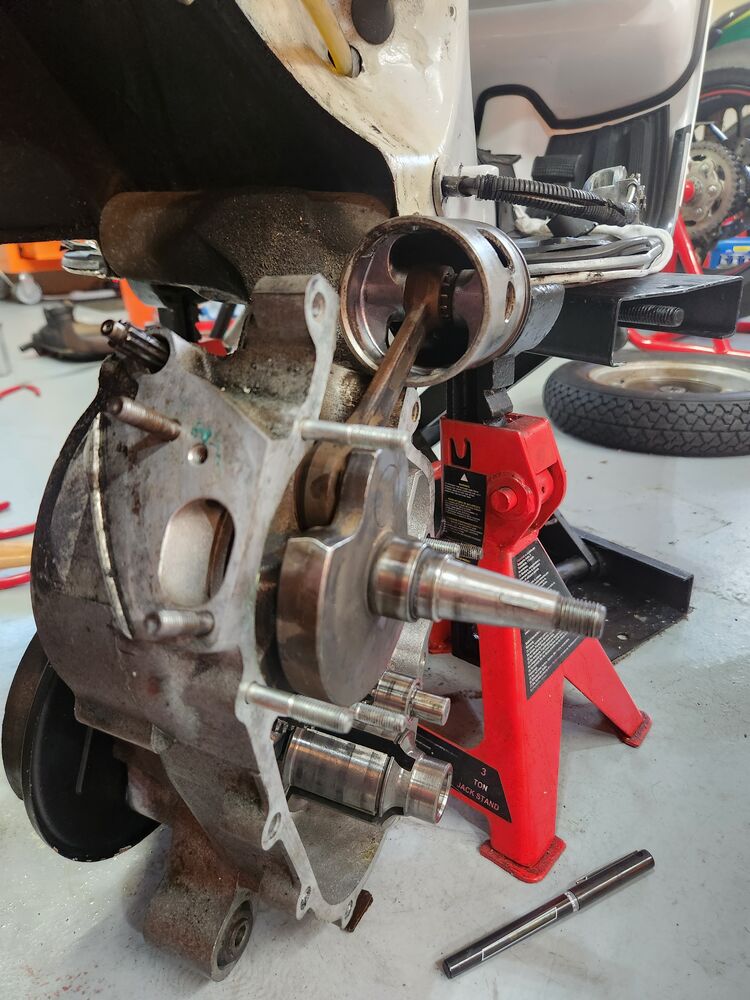

Piston
Piston

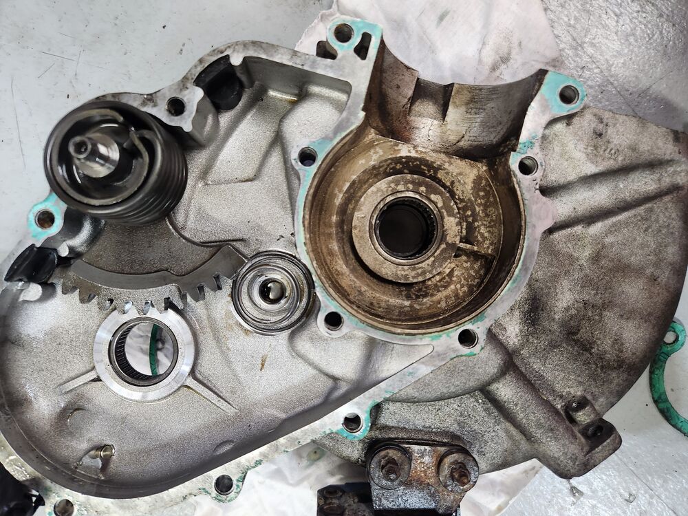

Case

first and foremost, did you get out what you dropped in?
90psi is low, you may be able to bring back the compression with rings and a hone. check and see what your current size bore and ring gap are.
I use gas and a parts brush to clean cases. because they're aluminum you don't need any oil on them. WD 40 will protect and of the steel parts.
when you're this far in at minimum you should be thinking seals, cross and soft parts. check the gears and what not. but if it's not been opened before or it's got mileage it may be due for a full overhaul.

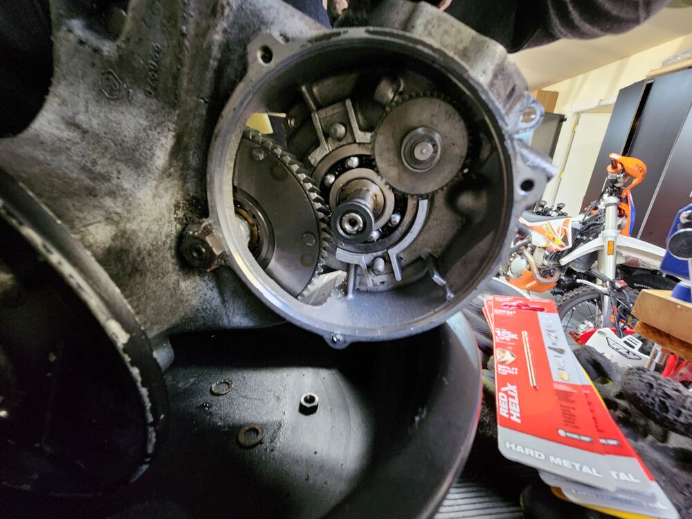

Regarding your question whether I got what fell in...yes and no. Yes because I did find a spring sitting there. No because the crankshaft / bearing seem stuck: they dotm rotate and I could not push the crankshaft our of the bearing (i was using hammer beatinf lretty hard but it barely moved - , I now also ordered the proper tool).
I am afraid something went wrong around there....waiting for the crankshaft removal tool to have another go

.... because the crankshaft / bearing seem stuck: they dotm rotate and I could not push the crankshaft our of the bearing (i was using hammer beatinf lretty hard but it barely moved)...
does the crank not rotate but you're able to wiggle the rod? then the webs are probably jammed up into the case (bad news, probably)
the whole shebang doesn't move at all, probably twisted the crank beating on it and pinched the rod.
something is borked. the crank should come out of the bearing fairly easily with a few love taps from a hammer.
