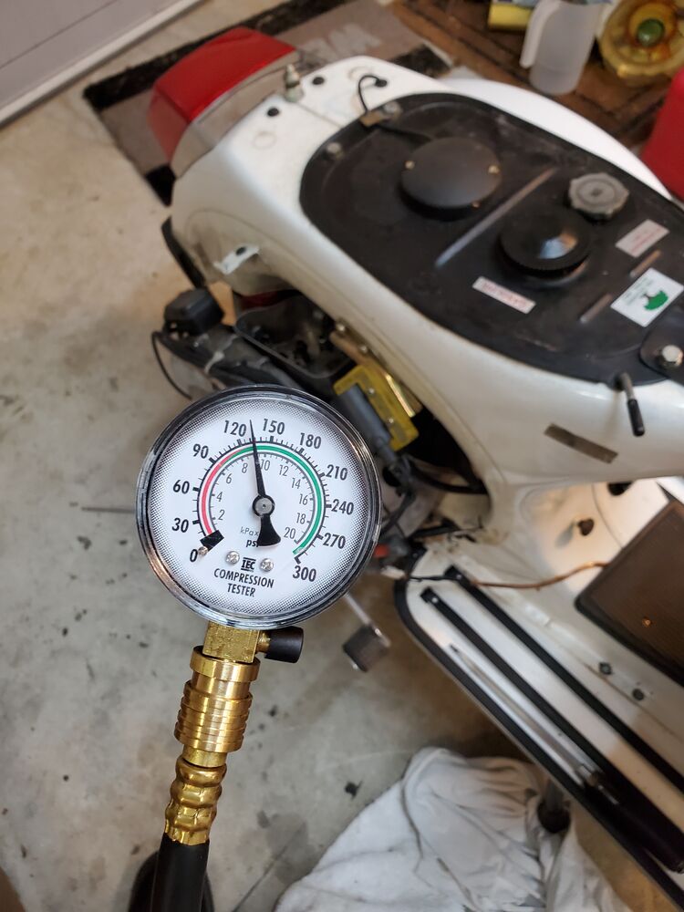

Cold compression is 135'ish. About five kicks.

that's good, your kit is in good condition, just a leak somewhere to track down then.

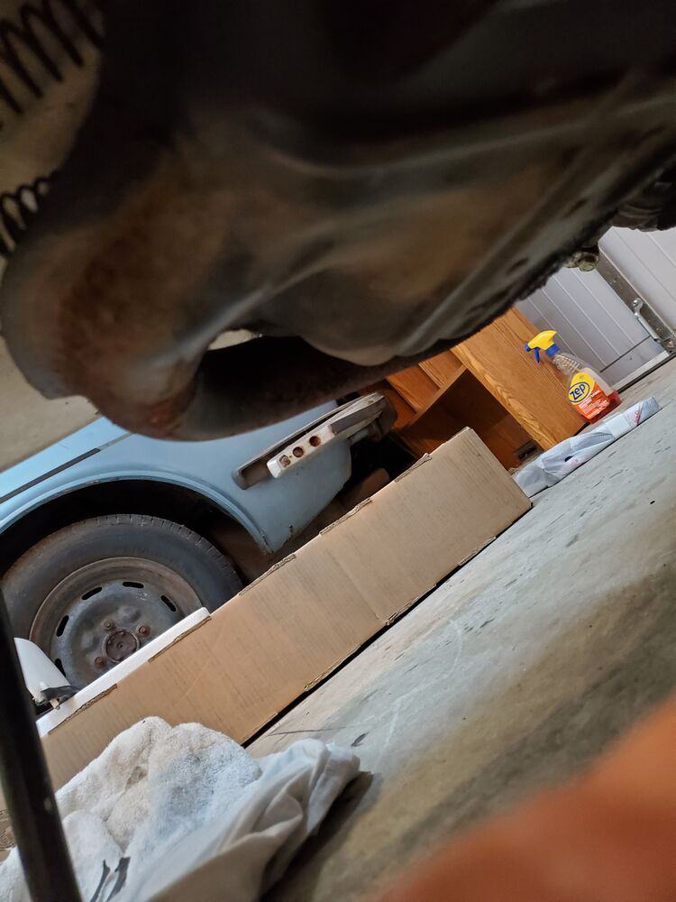

The 24/24 carb slide was binding when it was torqued down. Also, the float chamber was binding the pivot point on the float, it was hard to pull apart or put it back together. I think someone cranked the living shit out of the carb bolts. I replaced it with the 20/20 and re- jetted, and I have the initial dial in done. Idles good and the blips settle down fast. Going to run her around the block a few times to see what it feels like at 3/4 throttle and check the head temps. No legible numbers on the main jet, but it looks like a 116 or 118 maybe?
Also: pulled the tank and drained the old fuel and oil. Refilled the gas tank with 92 octane and the oil tank with Motul 710. Two new Mich S83's and tubes. New 12v/9mah battery. Had to replace the brake light bulb. Bled the brake res and refilled with fresh DOT4. Paid the ad valorem and got my tag/ title done.

Mon, 24 Oct 2022 15:47:27 +0000 linkquote
Both the 20/20 and the 24/24 are warped, they rock on a flat sheet of glass. Getting a steady oil leak right under the mix screw. Lapping those tonight.
I pulled the head and replaced the washers/ nuts and retorqued. I was getting leak at running temps that was causing an awful whistle. I have a base setup of 55/140, 160/Be3/112. Pinasco all alum. kit. Any thoughts?
Mon, 24 Oct 2022 16:26:41 +0000
Lucky
76 Sprint V, 63 GL, 62 VBB, 05 Stella, 66 Smallstate, 08 Stella (for now)
Joined: Thu, 16 Jun 2011 14:59:35 +0000
Posts: 6825
Location: Nashville
Lucky
Posts: 6825
Location: Nashville
Mon, 24 Oct 2022 16:26:41 +0000 linkquote
if you've lapped the head & cylinder face and they're still leaking, try hitting them with some copper spray seal before you reassemble. I started using it on DR's, which are notorious for head leaks, and it made a big difference.

Tue, 25 Oct 2022 15:27:54 +0000 linkquote
Lapped the carb and head, the carb leak is definitely fixed, heat will tell on the head. It only seemed to leak when it got to op temps and then it whistled like a kettle.
