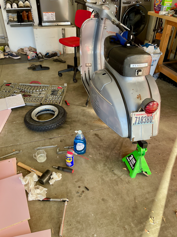

So I got a tire on today. Slow going since it was my first time changing a split rim tire, but I think next time it will go significantly smoother. One challenge was reliably jacking up the rear enough to get the tire in and out easily. May either get a floor jack or a bottle jack that will allow me to lift by where rear suspension attaches to the case or maybe next time just carefully lay it on it's side for the rear. And a chock for the front wheel seems like it would help a lot.
By far the biggest challenge was getting the large half of the rim to seat on the tire so I could get the smaller half attached to it without pinching the tube. I was able to tap in to my dad-strength to remove it (surprisingly very little rust) but getting it on just was not happening. I finally came up with the idea to use some extra long 8mm bolts and thread them through the holes that mount to the hub. This way I could put enough air in the tube to keep it out of the way, and then slowly guide the two halves together by tightening the nuts on those bolts. Then it was easy to attach the bolts that hold the rim together and inflate the tire to get it to seat all the way.
I'm hoping to have my registration runaround taken care of this week so I can actually leave my street!
Even with the big guns (dish soap, WD-40, lol) I couldn't get the first half of the rim on the tire. Ignore my crappy set up!
Extra long bolts to help guide the rims together.
I even managed to get the valve stem relatively straight. I'll take it.

Not bad!
There's a much easier way though. I just went through this with all 3 wheels. Get big zip ties. 4 per wheel. Put the tube in the tire and slightly pump it so it's outta the way and set in the tire slightly. Zip tie the tire shut as much as possible. Slather tire paste on both tire bead and the rim. You'll be able to just push the rim onto the tire with light pressure. I was actually amazed at how easy it was. Then once the tire is one you cut the zip tie and pull them out, tighten the nuts and then pump it up.
Hardest part was just pulling the zip ties back out, which still wasn't much since they got a little tire paste on them too so they get pretty slick. I can take pics or a video to show if you'd like.

Progress! I love it!
The trick when jacking up a scoot like that is to have a block of wood that you can put under the centerstand. With the centerstand raised up 4", you can just hoist the rear end higher than your jackstand will hold it. I use a couple of pieces of 2x10" and stack them. You can even drop the engine in the frame with a stack of three.
As to getting the tire on the rim, I just use air pressure. Get the tube inside the tire by whatever means necessary, fit the halves of the rim together as best you can. I've always been able to do it with the stock bolts, but maybe I'm just luck. Then air it up. The tire will pop onto the rims just fine and you're good-to-go.
Lastly, there's a wealth of accumulated knowledge in Random tricks, share your best little tips & shortcuts. V oodoo and Ginch went through a created an index a few years back, so it's not as opaque as it once was. So much goodness and hive mind knowledge in there.

Thanks for the additional tips, guys! Yeah I was going to use a couple bricks under the stand to rock it backwards to be able to do the front tire tonight. I don't really like the feel of the bike up there with the frame resting on the jack stand. That area on my bike has been chewed up pretty good by a PO drilling the hell out of it to mount the license plate so I'm afraid structurally it's not as robust as it normally is.
FridayMatinee wrote:
…Slather tire paste on both tire bead and the rim…
I like your zip tie idea, Friday. I'll give that a go next time. But what is this tire paste you speak of? Specific lubricant to help the tire on to the rim? Because that's where I got hung up, getting the tire around the fat side of the rim to even be able to get the other side close enough to bolt together. It was just a super tight fit.
Also, I torqued the nuts to 15-16 ft/lbs (based on a Robot video I watched, but he was on a small frame). Is that generally the right amount? Seems like not very much for wheels but I'm a recovering Over Tightener so…

Yeah Tire paste is a lube specifically for mounting tires. Dries clear and doesn't eat rubber. I use it to run the wiring harness too. Super slick. The tire just slides right on. Just lube both the tire and wheel. It's ridiculously easy to mount with that. I've done it the cram it on there and pull the rims tight with the bolts on my 10" wheels. Wasn't terrible but this way was no work at all. Embarrassingly easy.
And 16ft lbs is correct for the wheel rim nuts.

15~17 lb/ft is totally cool.
you can totally get the front off with just a 2X4 under the left leg of the stand. just don't go too far because the motor is on the other side and it'll tip on ya! it's here when you find out quickly that you do not have the reflexes of a cat and you are, in fact, all elbows.

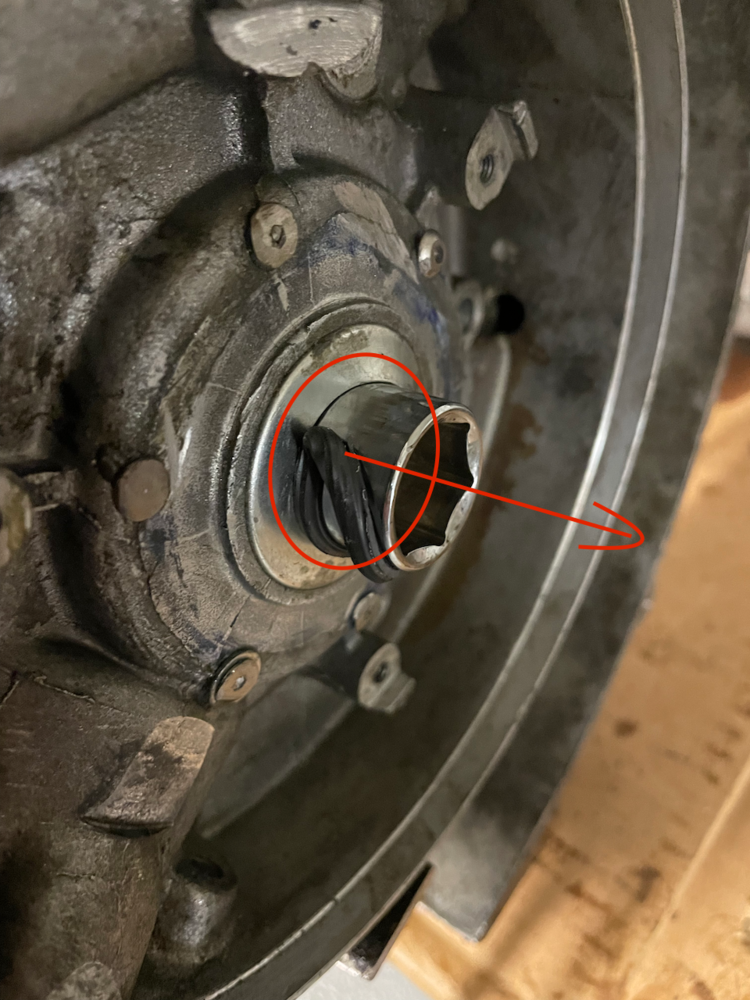

I went to change my front tire tonight and realized I only bought enough new hardware for one wheel. Oops.
I had the wheel off by the time I realized this so I decided to put it back on for the time being until I get the new hardware. When I was tightening down one of the wheel nuts (with a torque wrench) one of them would get reasonably tight but then just spin. From what I can ascertain from my online research, this seems to mean I'll need to replace that stud, correct? Is it worth running a die over that stud to see if it'll clean up or just plan to replace it?

I'd run a die over it and try another nut too. if it still doesn't want to grab try a different washer thickness and you might get lucky. failing that, R&R the stud

Thanks Greasy. I was going to see how it does with the new hardware and go from there. I'll try and clean up the threads on it a bit next time I have it off too. Maybe a little blue loctite on that one if it won't behave until I get chance to replace the stud. Unless loctite is a no-no on wheel studs for some reason…

Can you post a photo of the stud? If it's stripped, you'll want to replace it sooner than later. If the nut is stripped, that's obviously an easy fix...new nut. who dis?

Good new gents, stud seems to be fine. The old nut was stripped. Seems like a PO might have had some hardware store bits on there. I preemptively ordered a new stud so at least I'll have a spare on hand.
