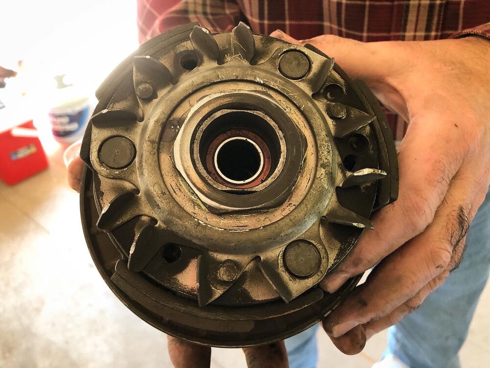

ohhh... that sounds like the nut that secures the clutch pack has come undone and it's rubbing against the bell.
pull the transmission cover and see what you've got going down.

DING DING DING DING DING!!
Greasy, you win whatever prize Andy is giving out.
My friend Paul and I dragged our sorry asses over to Andy's house this afternoon along with some tools and deconstructed the scooter. Pulling off the clutch bell it was immediately apparent that something was rubbing in a manner it should not be doing. Being old and slow it took some time to figure out exactly what to do. But eventually I squeezed the clutch together so Paul could tighten the nut.
Andy took the scooter for a spin and all seems as it should be. The belt is due to be changed in another thousand miles so I suspect we'll be taking everything apart again. On the bright side, Andy has a Harbor Freight lift table!
He took some pictures so I suspect he'll be posted them soon to show what was going on.

a scant bit of experience pays off on this one!
I can't help but notice, you schlepped yourselves and tools over so I hope he provided the beer!
you'll probably be okay with just knocking it back together but a little drop of red loctite is always a good idea on those clutch pack nuts!
good work though. top marks all around!

Greasy–you nailed it! Crazy to me that you could identify exactly what was happening by watching/hearing a video. Many thanks again to you for taking the time to write.
Here are some pics and video of Steve (VESPAsfw3) and Paul lending me their skill and expertise!
Steve and Paul, a.k.a. "The Brain Trust"
You can see where the metal was scraping on the inside of the bell
