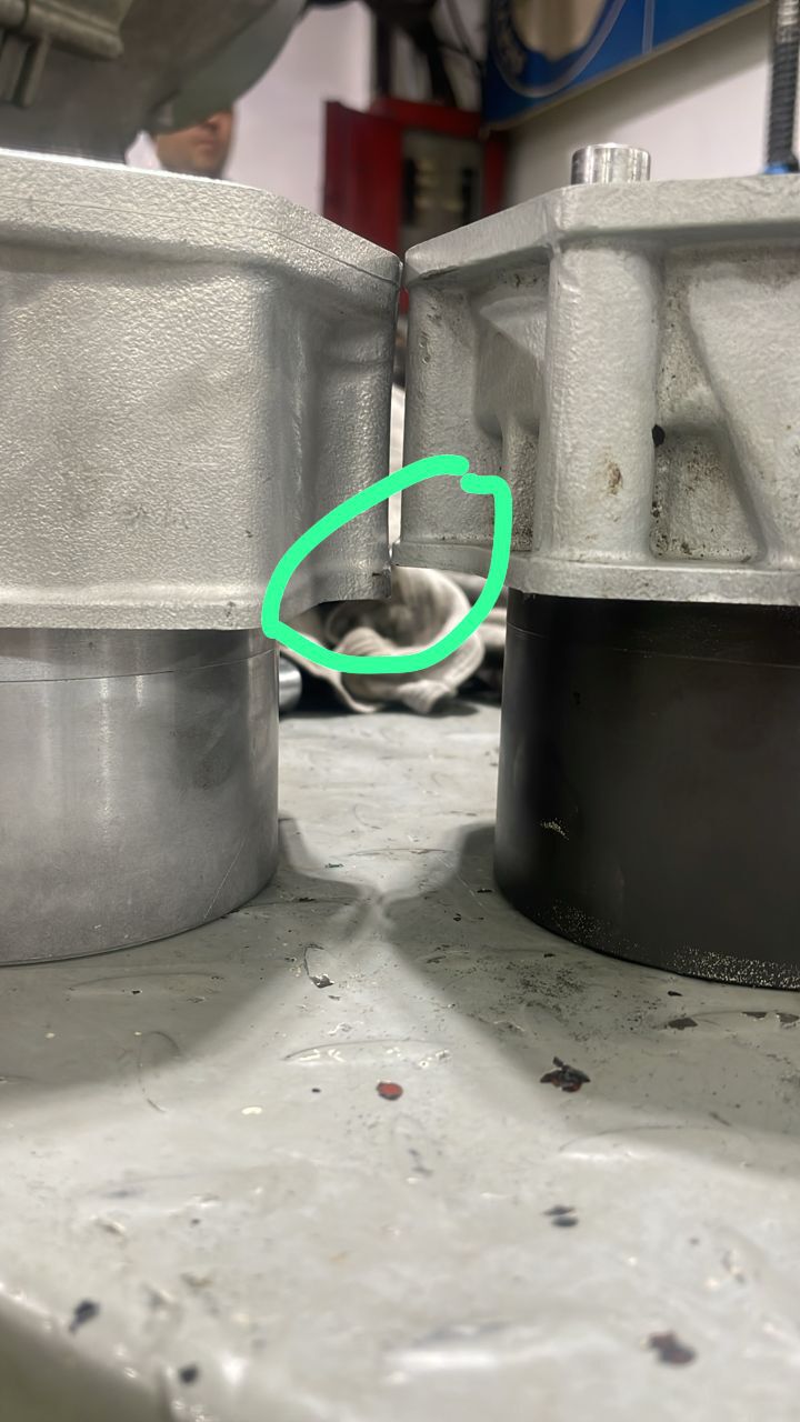

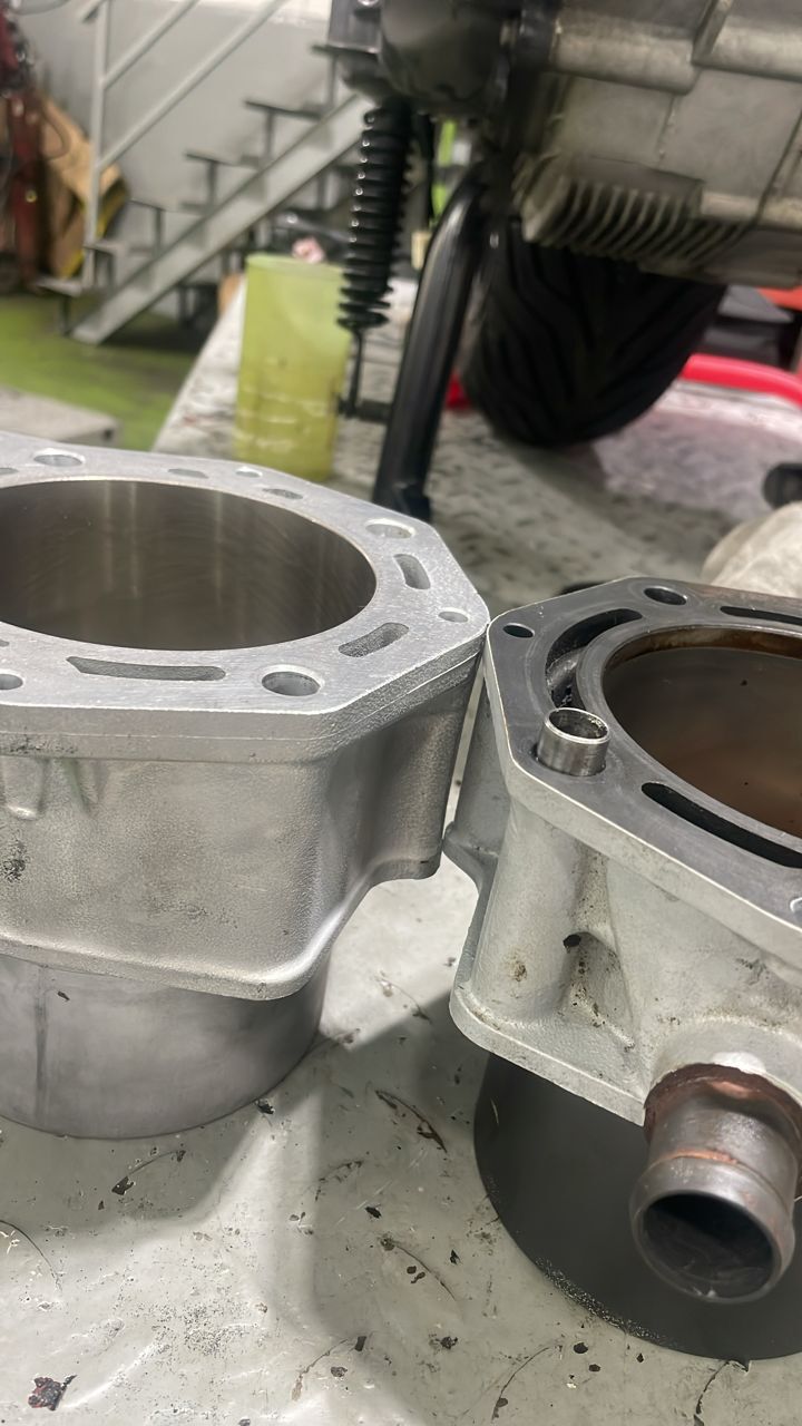

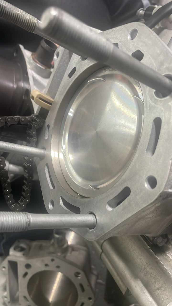

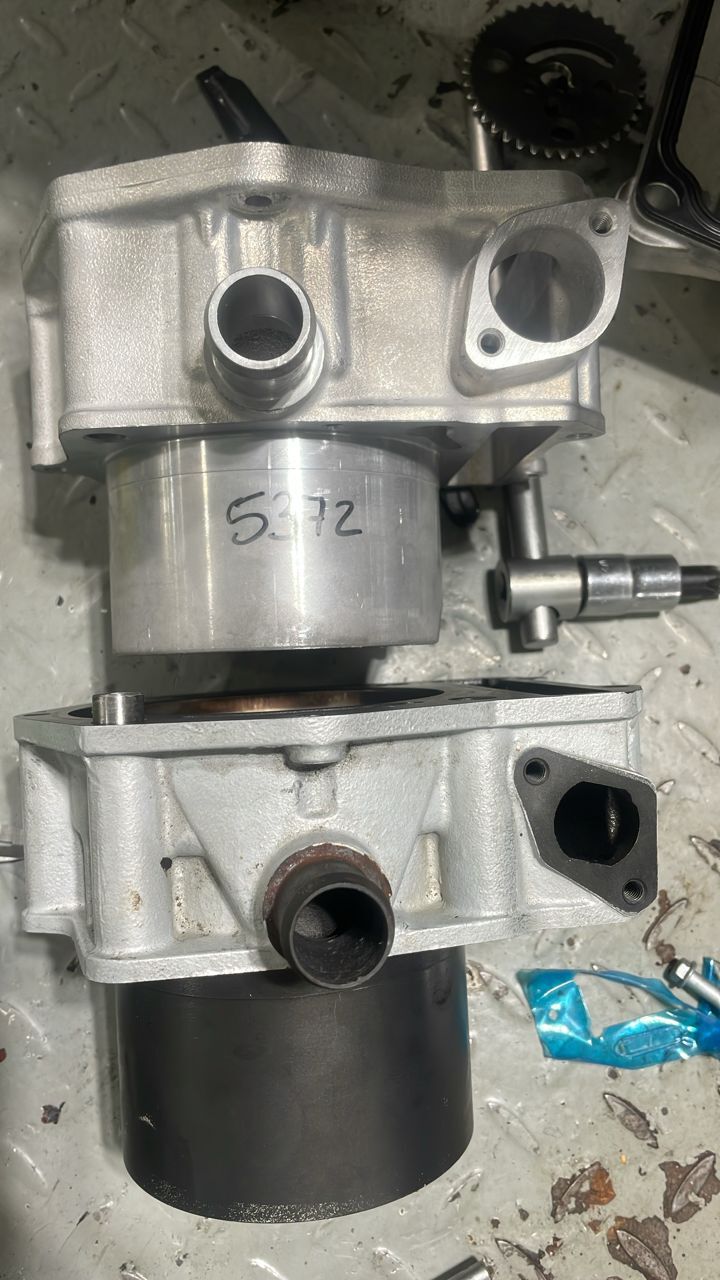

So I like to share some advances and finds after start the conversion.
After open the engine and remove the old cylinder my first Wha? emoticon is what the ones I removed look like (see attached pictures), with only 1000 km I don't expect this state, they don't look like 1000 km, but 15000 km, no idea why, but as the engine is opened I try to look for the reason. If someone have any idea and can share, are very appreciated.
Another Wha? emoticon is the difference in the weight between the 493 and the 530 cylinder. The 493 weight more that twice the 530 (see pictures). So it looks as the materials for the 530 are more modern/better and maybe better heat exchange.
Now after I open I realize that I order cylinder kit and the cylinder gasket, but I completely forgot to order the gasket between the cylinder and the valves, which logically being a wider cylinder is different, so I ordered it in Spain and I have to wait about 2 weeks to have it in my hands (Monday arrive Spain, then need to send to my country) meanwhile I will expand the space to so that the new cylinder can enter the crankcase.

Some updates that delay the project end again
Today we think that we can close the engine and install in the scooter, but not.
After we modified the crankcase, so that the new cylinder could fit in, all looks beautiful... but something caught our attention when assembling, something is not right Wha? emoticon the timing chain looks short and the piston in the most upper stage have some like 5mm remaining to come to the end of the cylinder, there is not enough compression, it cannot be that! it's very low! Facepalm emoticon so we stop to analyze what is happening (I'm adding some images).
So again remove cylinder from the crankcase and compare. They both have the same height, what's wrong? STOP, the bottom part is different Wha? emoticon Facepalm emoticon , here is the difference.
I think that the 530 crankcase have a slight extra negative space so the cylinder goes down more
I don't expect this at all Crying or Very sad emoticon
The main idea now, as is a not return process the change in the crankcase, is to mill the upper part of the 530 cylinder until the required measurement is obtained in the piston upper position (reduce it by about 4-5 mm, tomorrow I will take the exact measurements so I can take the piece to the turning shop). After the piece return I think I can archive the correct measures and solve the chain length and the distance between the piston and the cylinder head.
After making the height change we will probably have to modify the notches of the Chain Tensioner Rod a little, since they are going to be high, but that is a minor change.
But since we are with the magnifying glass, let's check again, what else could not be the same or fail? and we found that the chain tensioner is not the same Facepalm emoticon, it is possible to make a flange as the bolt pattern is the same, but we are going to do things right and order the 530 tensioner, so that it looks like everything came out of the factory like this...
Here some images to help illustrate the words, and to say, the adaptation of the 530 cylinder in a 500 is not a straight forward change as I expected as I start...
Piston not at top as in the upper position
530 vs 500 cylinder height at top
530 vs 500 cylinder height at bottom
And the chain tensor piece receptacle differences (upper is 530)
@safis avatar
Posts: 5411
@safis avatar
Posts: 5411
Maybe the 530 has a longer conrod??

I think this at first but don't have a way to check...
But yes, after a lot of check the better way to adapt nothing convince me for a reliable and safe change, so I decide to purchase the 530 crankshaft (the rod can't be purchase separated Facepalm emoticon ) and a longer timing chain and since I was already at it (shopping time) I decide to change the valves for the 530 ones (in case needs to breath better) and the valve springs and longest cylinder studs, all from the 530.
I expect receive all in maybe 2-3 weeks and start again, finger crossed I don't need any more and can start the new engine and enjoy

After almost 1 month of waiting, here I bring another update.
The day before yesterday we finally assembled the engine with all the parts in hand (I need to wait more that 3 weeks to receive), and I can confirm that the big difference in the cylinder high and at the top of the piston stroke was in the connecting rod and now everything fit perfectly.
Part of the implications of the connecting rod being longer, and therefore the cylinder, is that the timing chain shoes are longer and vary a little in their shape, and of course, the timing chain is longer, so was changed, and also the chain tensor, since the inlet mouth where the tensor goes in the 530 cylinder has a different shape than that of the 500 HPE, and I like to have all look as is always that way
Another extra are longest cylinder studs to compensate the longest 530 cylinder vs the 500 cylinder, but that's minor carpentry ROFL emoticon
Something interesting is that the diameter of the valves of the 530 and the 500 HPE are the same, so we decided not to touch the 500 cylinder head and leave everything as is.
Another interesting fact, the 530's camshaft has lower lobes than the 500's by approximately 2 mm, so I assume the 530's valves must be longer to compensate for that? Or maybe the angle change a lot? I'm not sure, but that's what I can speculate without physically having a 530 cylinder head to be able to compare well. Another reason not to touch the cylinder head.
Another interesting fact is that the injector on the 530 and the 500 are exactly the same (even the same part number) so I'm not worried about the fuel supply.
After we put everything together we realized that our oil supplier had run out of the 5W40 oil that we were going to put in and it was not easy to get it in my place, but this morning they shipped it to us and we started the new engine for the first time... the engine started on the first try, and was super quiet, much quieter than the 500HPE. I don't have an explanation for that, but it's something that caught my attention.
Tomorrow we will begin the process of bleeding the cooling system, putting covers, etc etc and doing some extra details that were on the list but were left on the back burner until the engine was finished to do the first ride to see how everything behaves in real use.
I will continue to inform and share my impressions when everything is operational and running.
