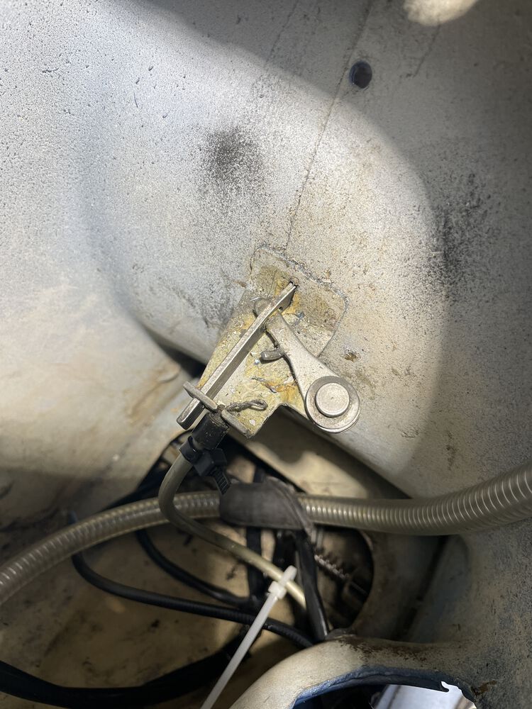

Lots of shenanigans Sunday. I had a few hours Sunday morning and all my hopes and dreams of kicking it over were dashed pretty quick.
Selector arm tested good, but when the box was mounted would only go from 2nd to 3rd and back to 2nd. Figured it just might be my old arthritic hands unable to move the batwing and cabled it up to see if leverage was needed. Naw. Still only 2nd and 3rd. Off came the cables and off came the box (and removing the box was not easy). Once off the selector arm easily went back and forth through all the gears? *scratched head*. Put the box back on and the batwing moved through all four gears also. At this point I decided new inners were a must as the old ones were chewed and screwed. And... well, of course I have no selector cables in the pile o' parts at the casa. Will check storage today.
In forward motion mode I did have a throttle cable and so replaced that. Painted the exhaust and worked on replacing old body rubber... and noticed I have to sort a solution for the choke cable too.

Gear cables sorted after a trip to storage!
Then I was off to sort the choke. Another peculiar feature of the Motovespa GT: small frame style choke.
Someone had trouble reassembling at some point. Sorted now.
Yeah, naw.
Still missing a washer… but better.
