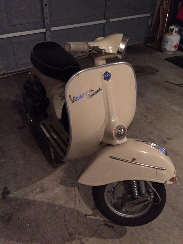

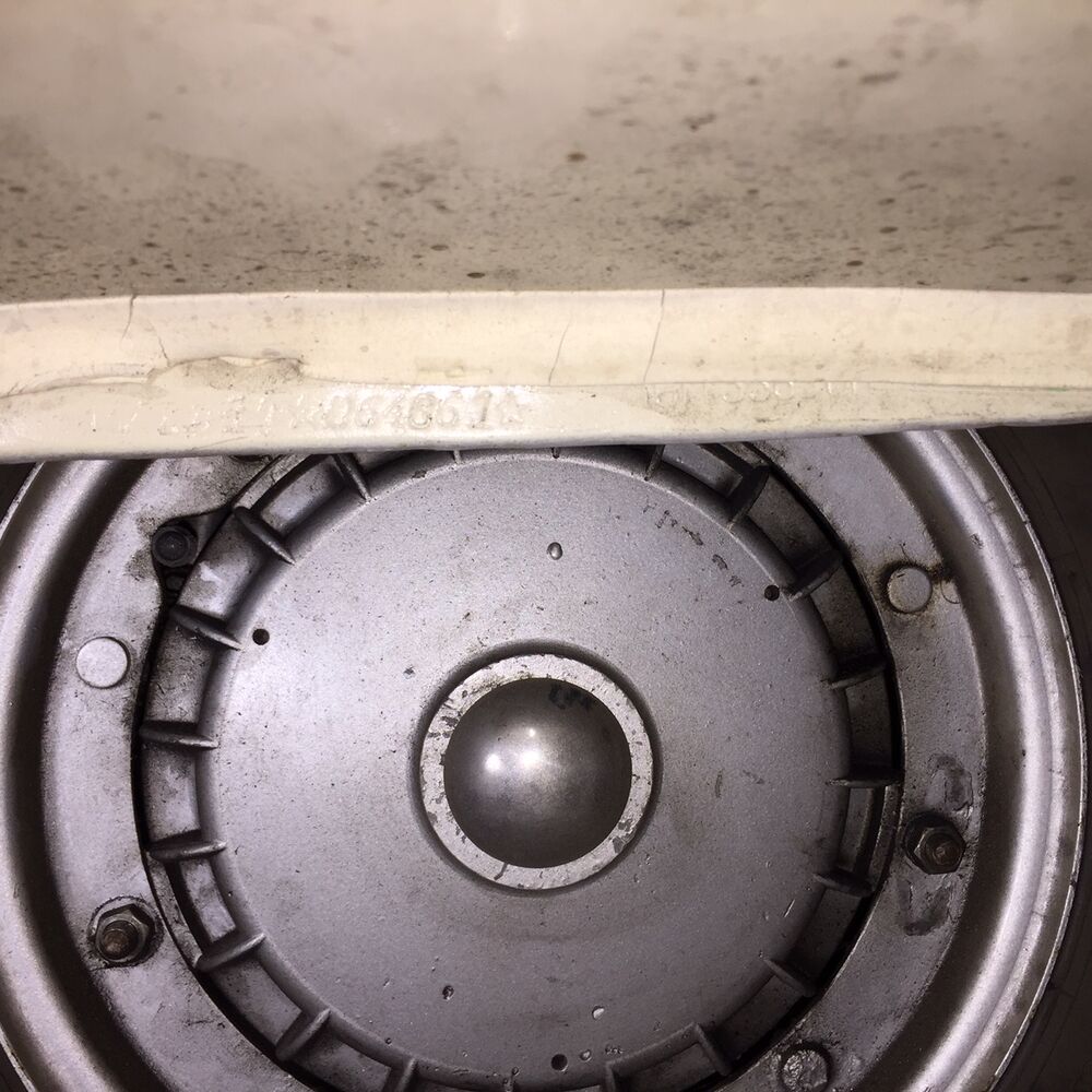

splash_wave wrote:
I can take more photos, what do you want to see? chandlerman
As Greasy noted, there should be a grommet on the hole where the cowl pin sits in the frame. Instead, you can see that there's a heavy skim coat of body filler that's chipped over time. The curve of the frame inside the motor also looks like it has a heavy skim of filler and the paint just has a certain "look" to it.
This is frequently a sign of a questionable restoration job (look at Bodgespotting to learn more about how bad it can be (but hopefully isn't)).

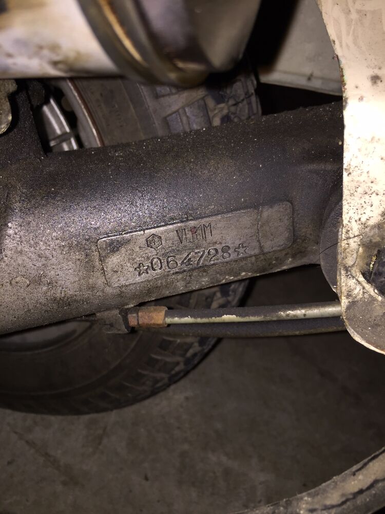

Engine number

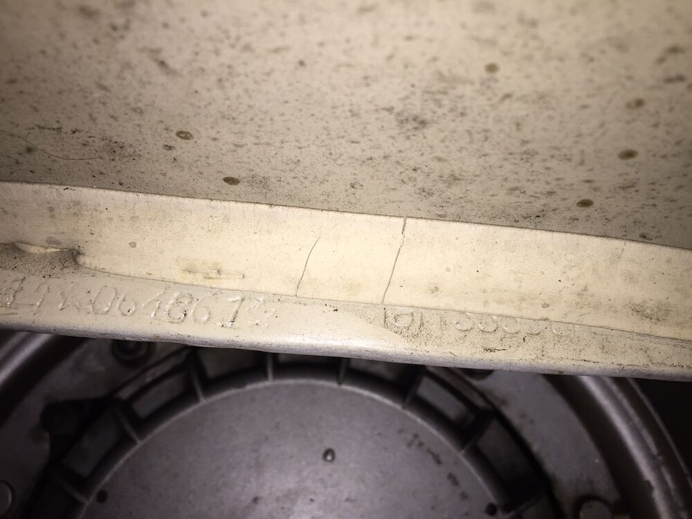

Poor work done here and brittle rubber cracking off

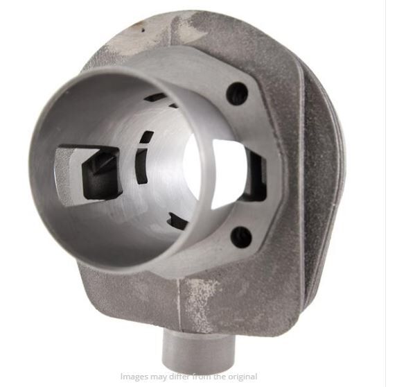

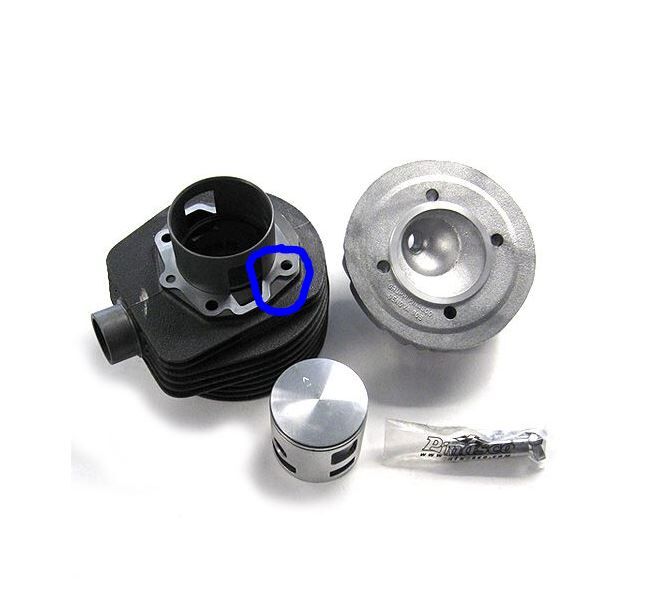

splash_wave wrote:
The one from scooterwest cuts in at the top studs.
huh? what do you mean "cuts in at the top studs"?
AFAIK pinasco only sells one 2 port 177 kit

SIP Pinasco 177cc 2-port kit
1968 Sprint 150
Posts: 249
Location: Vancouver, BC
1968 Sprint 150
Posts: 249
scooterwest Pinasco 177cc 2-port kit
1968 Sprint 150
Posts: 249
1968 Sprint 150
Posts: 249
There's more surface area between the bolt hole and the transfer port on the SIP kit.
Same cylinder. That is a gasket you're seeing...
Let's see pics of the entire bike.

1968 Sprint 150
Posts: 249
1968 Sprint 150
Posts: 249
front shot

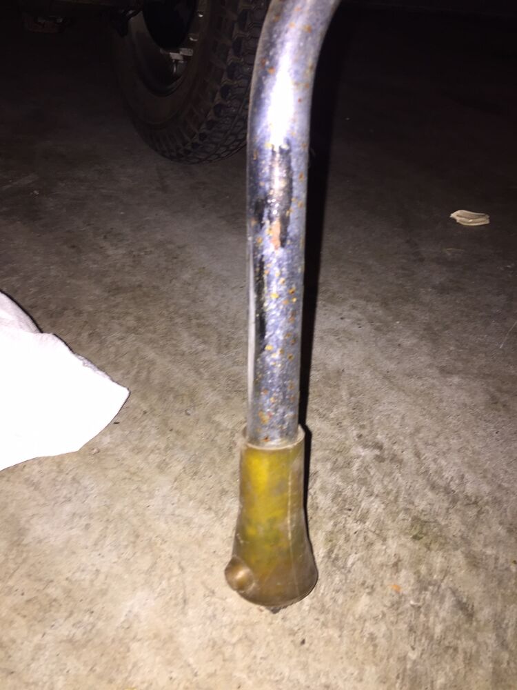

Is there a yellow center stand boot on this bike?
1968 Sprint 150
Posts: 249
1968 Sprint 150
Posts: 249
yellow boot

Forget the nuts and torque specs for now. Yellow booties = SEA bodge (bondo already cracking on mudguard also confirms it). I'd split the engine first before strapping on an expensive-ish kit...

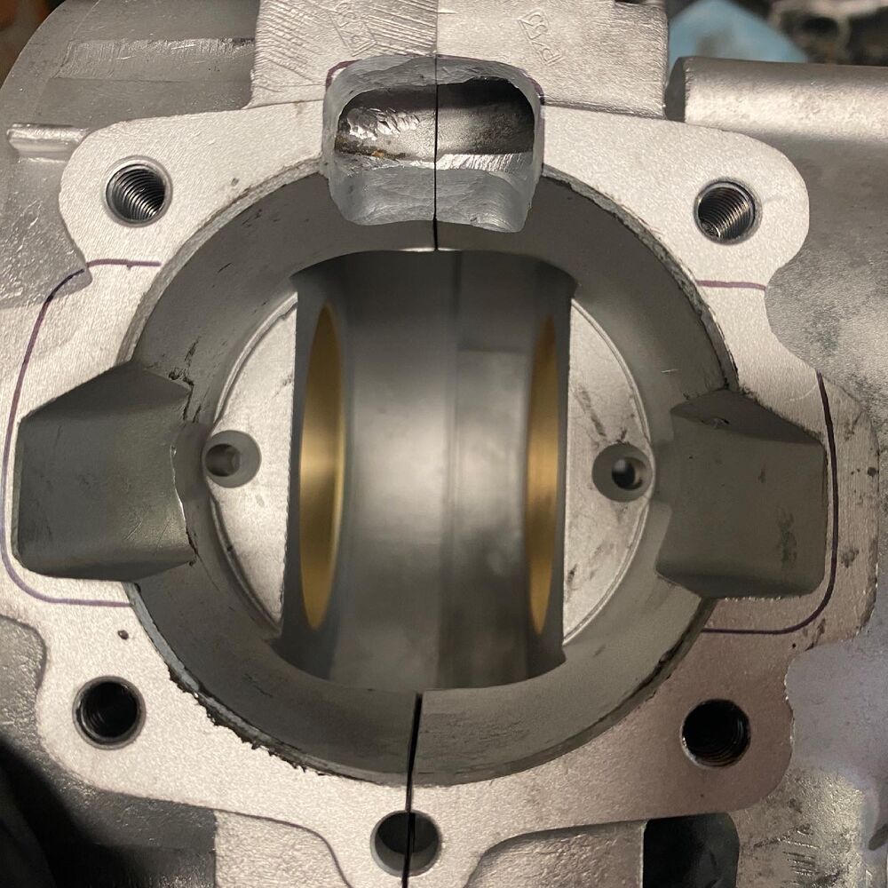

Well to go back to the bigger job for modifying port timings, is there a Pinasco 177cc 2 port data like sheet that will tell me port timing (not ignition) to do with intake and exhaust?
@socalguy avatar
bodgemaster
Posts: 7956
bodgemaster
@socalguy avatar
Posts: 7956
Short answer is no, there's no data sheet that tells you what your port timings should be. Port timings can be modified (within certain limits) to bring out different characteristics depending on how you want the engine to perform. It's equal parts art and science. There are some good books out there on tuning 2 stroke engines if you're interested. Lots of shared knowledge here on the forum on what modifications produce what result.
Generally speaking raising the cylinder (and the ports) puts the power band at a higher RPM range. The intake and exhaust ports of the cylinder can also be enlarged to allow for the more efficient (or earlier) transfer of fuel and exhaust. Lengthening the rotary pad opening and cutting the crank back a few degrees is also a common way to allow more mixture to be drawn into the crankcase and boost performance. There's a whole slew of other tuning tips if you want to start going down that route.
You're limited to some extent by your 2-port case. The transfers in the case really need to be enlarged or a 3d port added to get any really big performance gain. As mentioned it can be done with JB Weld if you're not interested in having the cases welded.
All that said, my two cents would be to just bolt the kit on and see how it feels for now.
