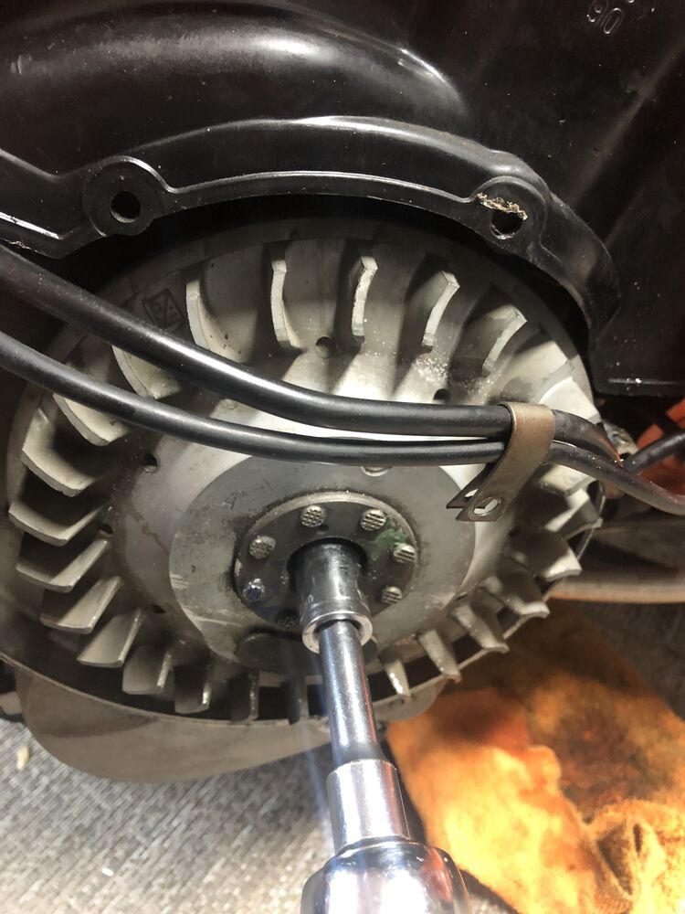

also, pull your flywheel cover and shroud. snap some pics of those and let's see what you've got under the hood. that flywheel looks interesting to me.
also carb and exhaust. I'm thinking there's more than meets the eye here!
ETA- never mind on the exhaust or carb, those appear to be stock

Ok
Elestart vibes maybe??
@greasy125 avatar
Posts: 15091
@greasy125 avatar
Posts: 15091
I don't know, it just seems "off" for that bike. heck, the motor might be something totally different for all I know!
but the finish of the face is what caught my eye. and the fins look different. granted, I'm not holding one in my hands right this second, but it doesn't look script badge 90 to me

Maybe it's not a 90 but a 50?
Shroud off but I can't seem to get the plastic part out
Plastic shroud is stuck
Carbs not great
Carbs not great
It's turning over

The plastic shroud has a bolt holding it down on the clutch side. It's obnoxious, and hard to get to. But if your piston is moving, you don't need to pull the head (yet).
I've seen worse carbs, but you should definitely get a rebuild kit. Is it a DelOrto 16/16?

What is the serial number of the engine? It's on the bottom of the engine as far back as you can go, by the rear shock mount.
While you are inside the carb, write down all the jet numbers.
