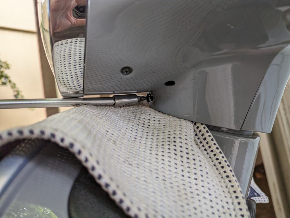

To avoid dropping the screw down in to the bowels of your scoot slide a rag in there tucking it like this photo.
Similar tucking to avoid dropping the screws that hold the rear handle bar cover
Great tip but from the looks of the 'rag' you gonna be in trouble

I use another method. I have a pair of tweezers waiting to seize the bolt as soon as it protrudes enough. Helps with putting it back too.

Magnetized screwdriver or magnet-on-a-stick works also.
It honestly never occurred to me to use a rag to catch that screw, and I've been going into the headset of my S150 periodically for more than a dozen years now. Brilliant!

I turn the headset then there is no place to drop.

jess wrote:
Which is nothing compared to the sounds that come out of one's own mouth when they drop a screw into the bodywork and realize they are going to have to take off the glovebox and possibly the floorboards.
I have dropped that screw into the insides of the scooter so many times I can't even remember. I think the secret is in the cloth that you use. Because I was using a square cloth but it wasn't enough to catch the damn screw from falling into the bowels of my scooter.

I've used both the rag method or long needle nose pliers method.
The rag method is a bit easier and keeps your off hand free in cae it's needed.

A variation is to use a "tack cloth" below, which is a sticky piece of waxed cheesecloth that woodworkers use to get the last bits of sawdust off a surface just prior to varnishing it. The cloths don't leave any deposits. Little screws, washers, etc. will stick to one, but anything over 1/4" diameter will probably roll.
As the Planck-Ruder law states, every tiny object that is dropped, will become invisible as soon as it hits something and makes a noise. a couple of months ago it finally dawned on me to buy a set of telescoping rods with different sized magnets. ($25). Uses go beyond wrenching. .

i just replaced my headlight with an LED. When I removed that screw under the headlight after, i had unscrewed it a bit, I lightly held it with a hemostat and that held on to the screws and also allowed me to fully unscrew and remove it. Did the same trick to replace it worked well.
