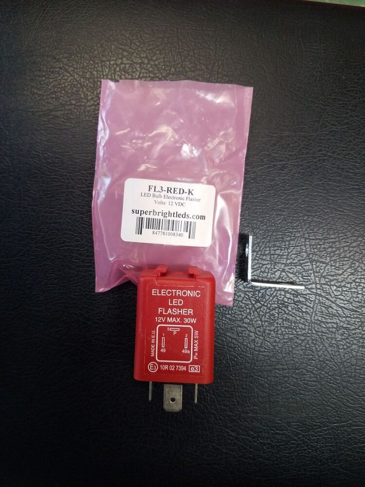

Hey ghiros - I replaced mine with an LED blinker module from Superbrightleds.com. it works fantastic.
It will work with regular or LED bulbs.
The blinker relay
The blinker relay
