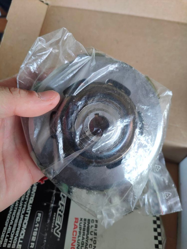

for the clutch i am considering this one
https://www.10pollici.com/en/homepage/classic-vespa/engine/clutches/smallframe/clutch-newfren-24-springs-vespa-50-90-125-et3-primavera-pk.2.1.34.gp.4011.uw
i ve found it in almost half price but i cannot find any info about that. i think it will hold easy the power of the malossi. dont know.
the thing i am really confused is about primary and gearing. i keep the pk50 gears and change only the cluster (10-14-17-20?) primary for that? or i have to buy a pk 125 complete 4 speed gear set and put an other primary like 27-69? i think in both cases i will have to put a cluster with at least short 4rth to avoid the gear gap from 3rd to 4th

also i purchased this clutch in about half price (posting included) almost new.
now left gearing, primary and exhaust. for the exhaust i think i am turning to VMC siluro. their new exhaust but its new and havent seen any dyno results versus other exhaust to compare
newfren 25 springs (race?)

just got the 24 springs newfren clutch today. also i found the cluster and gears including shift and cross. 10-14-18-22 and 58-54-50-46 gears. thinking purchase em and also with a 27/69 primary would be just what i need for a touring engine. only thing that left is an exhaust....
spare plates and springs

its time for a small update. the pk50ss i had it was in a really bad condition with lots of staff missing and not working. i found an other 1983 pk50ss with no papers but in better condition (frame seems not rotten and everything is on) but the engine is stuck. today i start dissasembly lots of parts to see if i can find why is nothing moving! also i took of the rear shock. i already have a bitubo rear shock. can anyone tell me if it will fit and what is it missing? i tried to search if this is the correct length for pk but no luck. maybe with a upper silent block and some kind of adapter will do the job..
