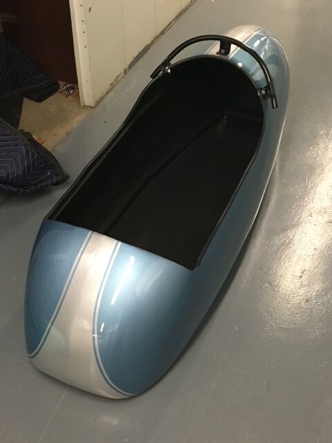

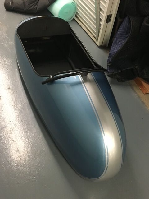

Picked up a sidecar and am wondering what make it is and if it's complete. Looks pretty tidy. As the story from the PO goes, he bought it new with a 2005 PX150 at Vespa of Hartford (CT)... maybe in about 2006.
He put 75 miles on the hack before removing the sidecar and putting it away in storage in his shed, covered, while he continued using the scooter solo.
It's very lightweight -- a fiberglass tub with steel frame. It has a Vespa style 10" wheel and suspension w/a simple dampener & spring like an early scoot. I don't see any identifying info on the sidecar regarding manufacturer, but based on the wheel components I'd guess it's Indian or Indonesian. Globe? Inder? Scooter99, etc? Doesn't seem like a California or a Rocket... but I could be wrong.
I want to install it eventually on my 64 VBB 177cc. Not sure if I have all the required hardware: In addition to the sidecar's steel frame, included are a squarish steel bracket that bolts under a scoot's floorboard where the centerstand attaches and some other bits. Suppose I could be missing stuff, but maybe I could make parts or source them once I know what it is...
I haven't found an exact match yet from any internet searches. Anyone recognize this make or have any familiarity with same? Thanks

It's an older version from scooter99. I have seen a few around Atlanta in the last 10 years. Only one was connected to a running bike and the sidecar frame had a lot of flex in it and made it pretty unstable to drive, you may have to reinforce it make it more stable.

Just looks like a scary sidecar off a bodge

Matt beat me to it - and has more up close experience.
Looks like a first generation scooter 99 out of Indonesia.
Perfectly respectable body.

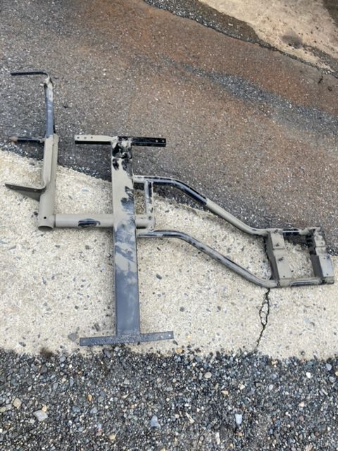

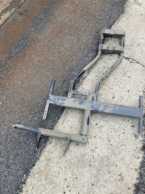

Frame is made of pipe rather than tube - so it's perhaps not the stiffest solution - but it could be stiffened if you found it too flexible.
Has become very expensive to import something like that - so not so many around.
Overall - I'd say - great find - if you wanted a sidecar. First glance appears to show it might all be there - including subframe that goes onto scoot.
You can attach the two halves while it's still off, and look for any play/ needed reinforcement, to stiffen.
Good luck and welcome!

Update! Adding to the record in case future members using similar Scooter99 sidecar mounts may find this info helpful...
I (finally) trudged through the snow to the barn and explored mounting options for this under-floor bracket with a few different old scooter model (project or abandoned) frames that I have kicking around.
This particular bracket presents a problem for VBB or GL era frames due to the middle box section/floor support getting in the way of the bracket actually touching the floor. The bracket can't sit flush with the floor's underside because of the middle floor support. And, a VBB's centerstand holes on either side of the tunnel don't line up with this bracket's thru-floor bolts. New drilling req'd for that.
Not the case with P Series frames/floors. They would be fine with my bracket -- it formerly was on someone else's 2005 PX150. I have a very roached out, rusted '79 P125x frame. These Ps didn't have a center floor support, and their front and rear supports nestle nicely with this Scooter99 bracket.
PITA, but I would need to modify any VBB era bike for the sidecar. I'd have to 1) remove the center floor support so the bracket can sit squarely against the underside of the scooter, and 2) drill new centerstand type holes. Could I get away with removing the middle floor support and sealing the floor up, then attaching, I wonder?
Or, I'd have to pad out the bracket itself somehow so it supports the VBB floor properly in the front and rear, and also drill new holes and use longer bolts. I'll give that some thought. Nah, it might throw off the bracket's swingarm bolt mounting too.
So I assume Scooter99 made/probably still makes a bit different attachment brackets that fit older 60s, 70s Vespa models' floors correctly.

Ok, you guys all seem like my best chance for answers to my question. I've been on these forums for a while, since I was restoring my '64 VBB.
When I originally purchased the scooter, I also got a sidecar and frame (see pics). Problem is, I'm having difficulty figuring out how to source a proper wheel hub, fender to mount an 8" wheel. I've receives suggestions about a trailer wheel/hub/fender, but ideally, I want the wheel to look like a vespa and same with fender. Alternatively, if I could find a complete frame and replace the one I have. any/all suggestions are welcome.
Thx, Josh
