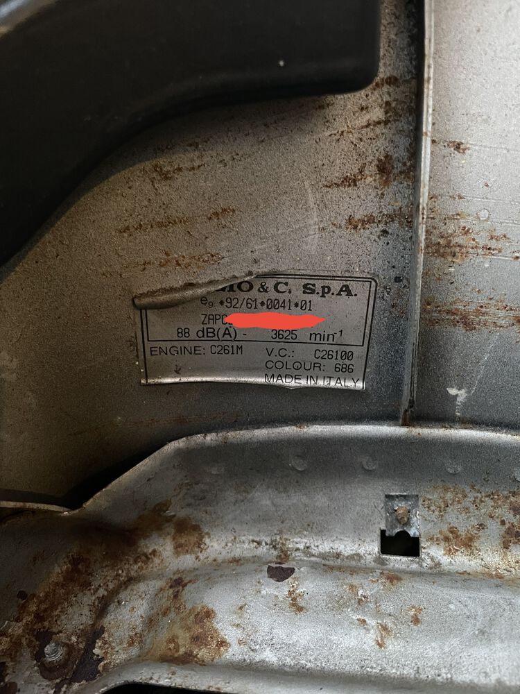

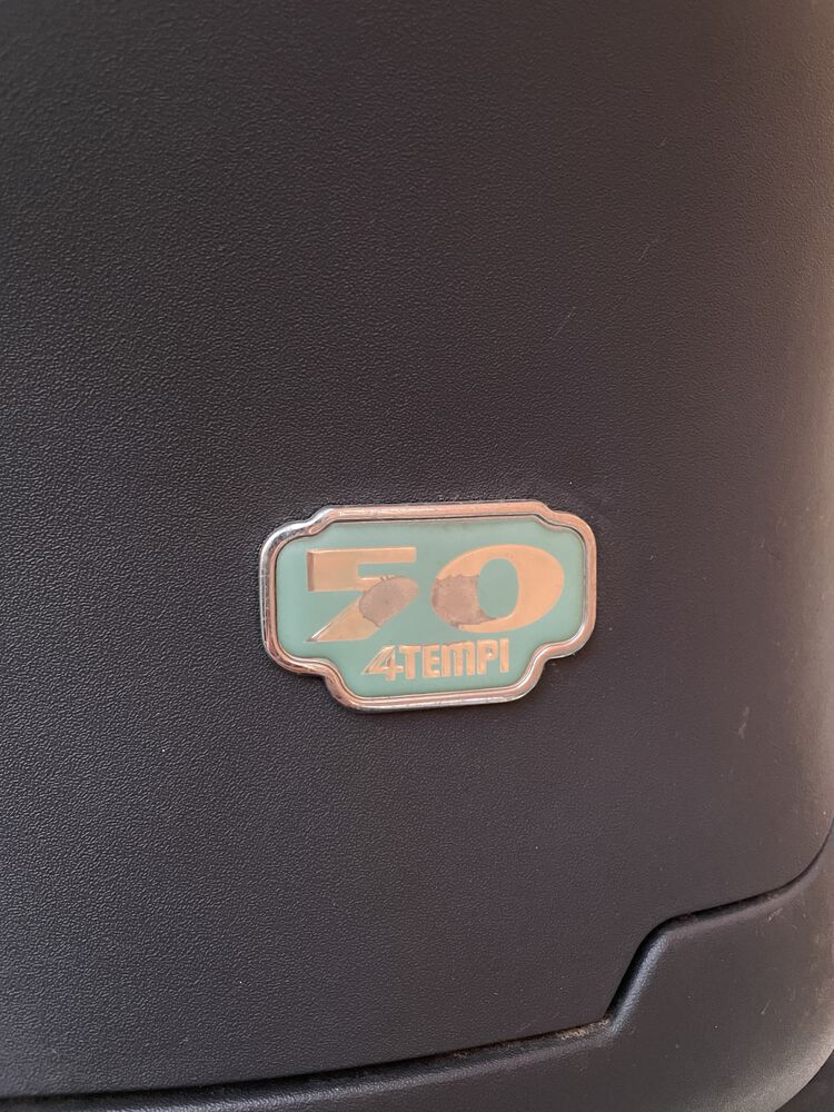

Hi, just picked my first scooter as a restoration project. Engine rebuild etc. The chassis is in great condition and the underneath all in tact, so pleased about that.
I thought it was a 2-stroke so I was looking for the oil tank refill cap which isn't there! Turns out it's a 50cc 4-stroke
I really wanted a 2-stroke so a little bit gutted now. What is this 4 Tempi engine like? Is it the same one in the more modern vespa's that gets less than positive reviews? Pressumbly, it's not the hardest thing in the world to get the 2 stroke engine and swap it out?

Thanks, I need to get a list together and then price it up.
How about this 4 Tempi engine?

Don't know about the tempi but what year is it. Is it the ET4 engine and is the tempi just the model name or does the 4 tempi mean it might not be a 2 valve model but the later 4 valve model. Pics of it would be good and the engine number which is at the back of the transmission casing. Does the reg doc state it's a ET2?
I had same problem once bought et2 off eBay but got there numpty didn't know it was meant to be a 2stroke and just assumed it was. Still had it was still a good price though.
ET2 + PX
Posts: 162
Location: London, UK
ET2 + PX
Posts: 162
Yes, my first time buying a scooter so my fault for not checking! The seller had it in a barn for the last 15 years and didn't have much knowledge of it. I never realised there was a 4-stroke 50cc in the ET2 either.
It's a 2003 and yes I'm UK based. Hopefully the pics help.

4 tempi just translates to 4 stroke

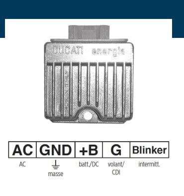

All looks decent but I'm wondering about the voltage regulator putting out the correct voltage to the igniton coil. I'm only measuring around 8v on the volant/cdi pin with 13.5v being supplied. I've taken the voltage regulator out and tested it on a bench power supply. How often do these fail? Could be a red herring....?
Posts: 46117
Posts: 46117
The volanti/CDI is AC, not DC. It's the main unregulated AC output of the stator. Use this LX50 4T circuit diagram:
https://manuals.wotmeworry.org.uk/Vespa/LX50/LX50%204%20Stroke/
