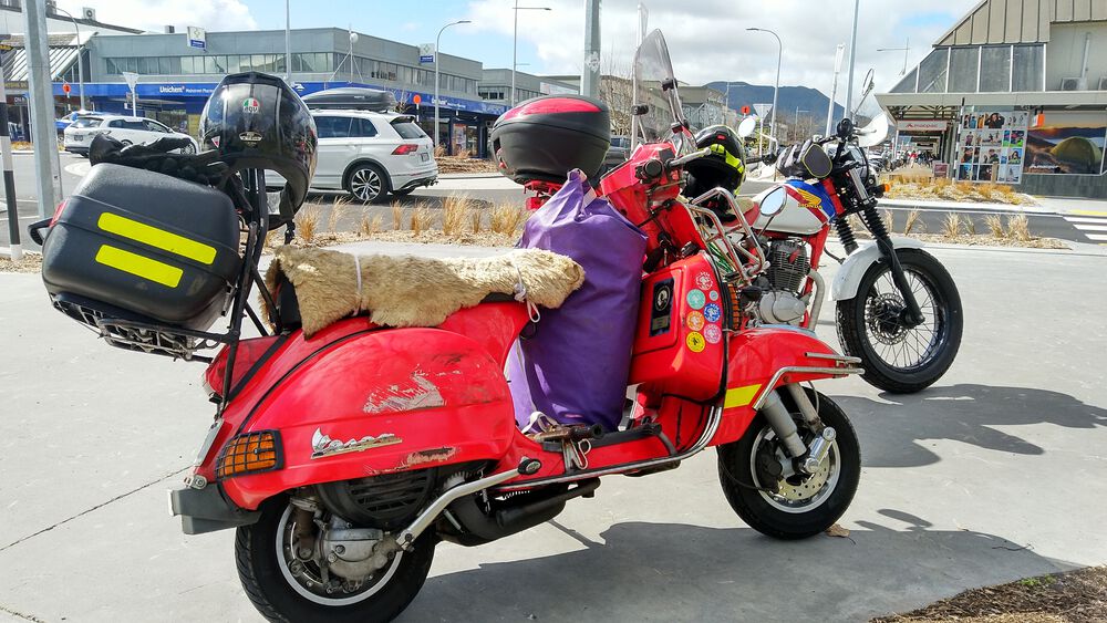

New kit delivered to air b n b after seize, back on the road next morning

^^^ That sure looks like it was fun.

It was! Got the kit on in a couple of hours, and continued on … didn't miss a beat.

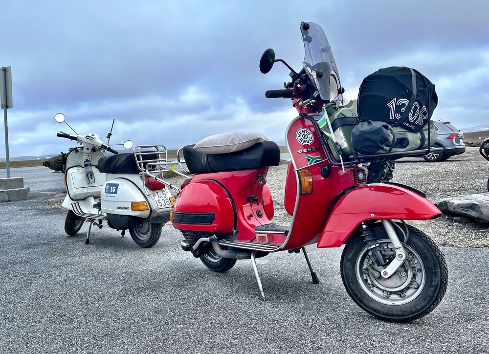

Bobo wrote:
What's a PX America?
The red Vespa is a 1983 and is the P125X America. What I was told is that the main difference at the time was that in order to sell in America they had to make it an autolube. Apart from that, I have not seen any differences. Of course, this is second hand knowledge, so I stand to be corrected...

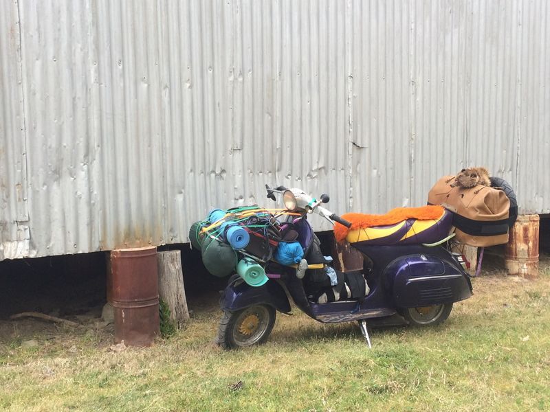

EDIT 2: I found a pic from a weekend trip from winter last year.
Big waterproof tube bag on the floorboards. Big is good. Its out of the wind and fills a void. Tent, sleeping bag, clothes etc. cram in here. Secured with ratchet strap and can be pushed to the side to allow easy access glove box. Give it a kick, at the bottom, and you can make room for your foot for the rear brake. It doesn't much get in the way of the handle bars. Put some hooks on floorboards using the stand bolts holes to secure it.
Top box for feedie and other kack (keep it light as possible). Make sure the carrier is a strong quality one and use big bolts through the number plate holes. Tools and spares in glove box helps distribute weight forward and low (heavy stuff). Heaviest stuff goes on non-engine side of glove box. Chuck in a packet of big fat strong cable ties.
I don't put anything much on the front rack (any weight / bulk here makes the bike shitty to ride and lift off the centre stand - just don't)- this is good, however, for quickly ridding yourself of wet weather gear if it gets hot, or for buying supplies (e.g. beer) when you are nearly there for the day.
Using a side stand is ideal for short stops. Don't fill up autolube or petrol using this. Can't leave bike idling on side stand either (spits oil out clutch breather) I don't park it up overnight on it either. Keep centre stand too.
The yellow stripes on the side is reflective tape stuff for extra safety / visibility. There are red ones on the back of the top box and and a small white one on the front mudguard trim thing.
The covers on the indicators just might save them if you have a spill so you can carry on safely. Torch and tape in glove box for emergency headlight. This bike also has heated handle grips.
If you put crash bars on the pods (removed here) you can bungy your tent to one side on top of the pod and a fold out camp chair on the other side. You can also tuck in a pair of converse sneakers. Bungies go under the seat so you can still gas up. You don't want anything on the seat you have to take off each time you get gas. It gets annoying very early on.
That's Karen on the seat.
Unforeseen things?: New Schwalbe (WeatherDeathMan) rear tyre delaminating after a few days (never ever ever buying anything from them again). Heidenau, supposedly, winter tyres were awful too (unpredictable grip on wet roads). Brand new front shock leaking oil (Escorts). Sandflies. Fallen trees, slips, gravel, etc. on the road around blind corners.

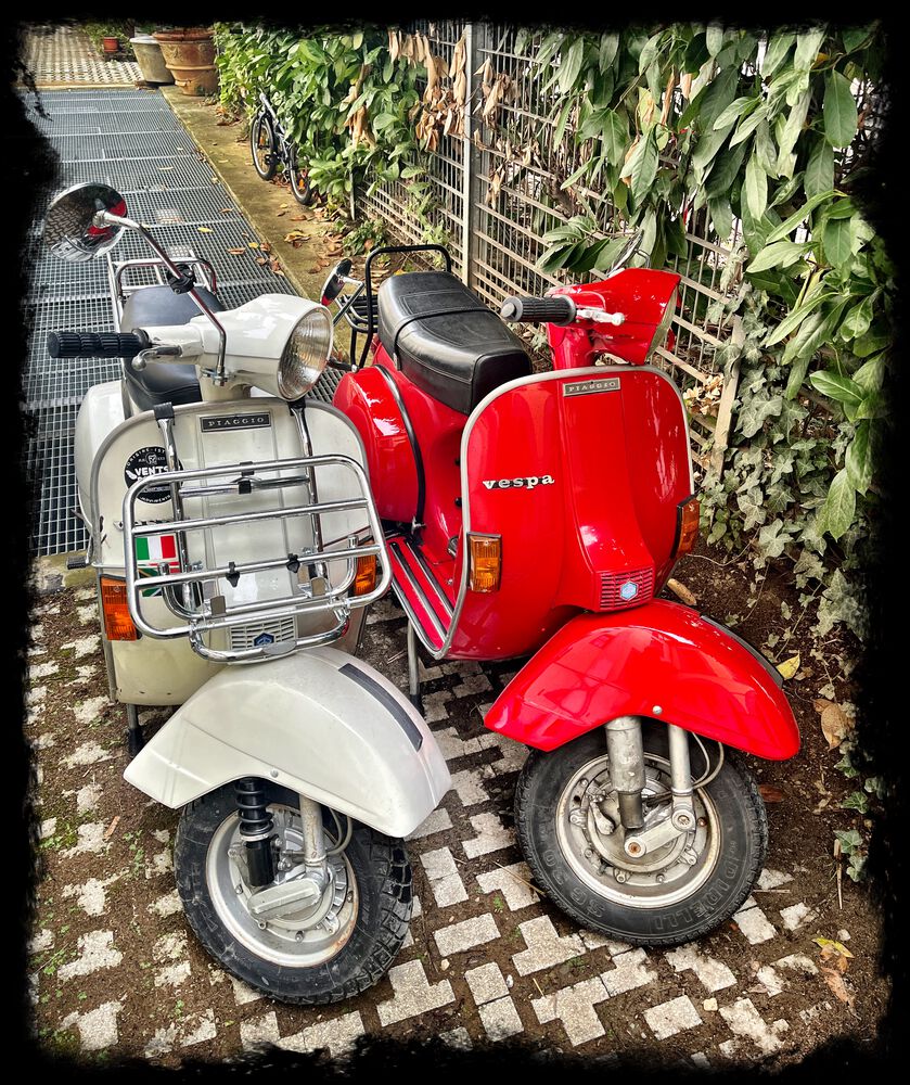

100 days out from departure, with the temperature finally becoming "outdoor workshop" friendly and following a lot of good advice, I started the preparations…
Nothing earth shattering - changed the remaining tires, new air filters, new plugs and adjusted the carburetors to see how far that takes care of basic performance issues.
Also took photos of coils, carburetors, etc. to make sure I order the correct spares. Fuel lines seem OK but will likely be replaced closer to the trip as well as the gear selector and seat on the red one.
