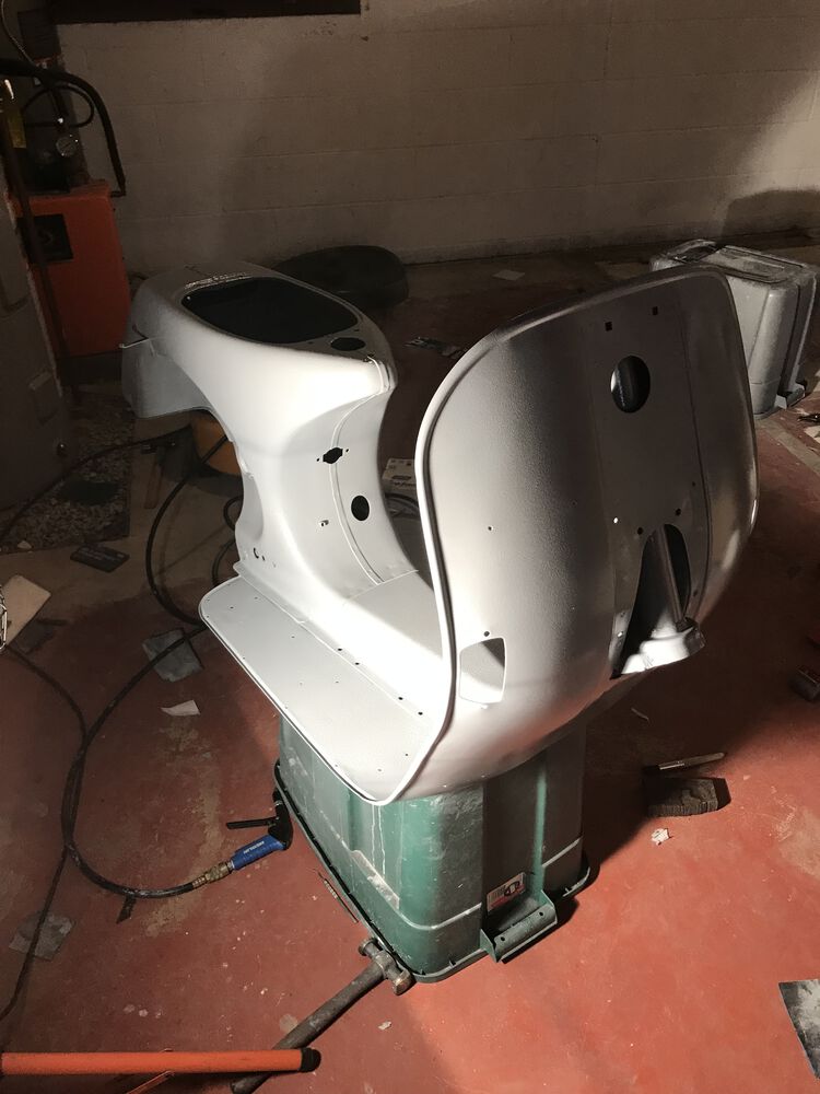

New to the site, overwhelming amount of info to sift through. I was hoping I could get some help with the ideal order of disassembly for tearing down a complete but inoperable scooter in order to replace all cables, redo wiring, replace motor, replace spedo, strip off rattle can paint job and repaint entire scooter. I have a complete 1965 Allstate that I have owned since 2010. It was running until 2011 when I managed to drop a spring down the motor which is scored the cylinder and could not afford to fix it but replaced the motor with a three speed the shop head lying around. It's not working around 2012 and has been sitting in storage since then. I finally decided it's time to get it working again and get it working right. I plan on doing a complete yet amateur restoration, replacing anything beyond restoring and replacing the motor. I have seen multiple YouTube videos that address various parts of the restoration but never one that says "Start by dropping the motor ... or whatever..." Can someone point me in the direction of the most complete videos or instructions that would help me out before I screw this up too bad? . Thanks
Partial disassembly before I was smart enough to ask for help

I'd start by pulling the tank. pop the cowl off. then yank out the motor and rear shock. followed by the headset and then drop the fork. from there you can tackle all the sub assemblies.
leave the harness and cables in it so that you can use them to chase new ones in.
bag and tag everything. throw NOTHING away, even if you think it's trash until you have completed the build.
good luck, and the search function is your friend. we'll help you along the way!

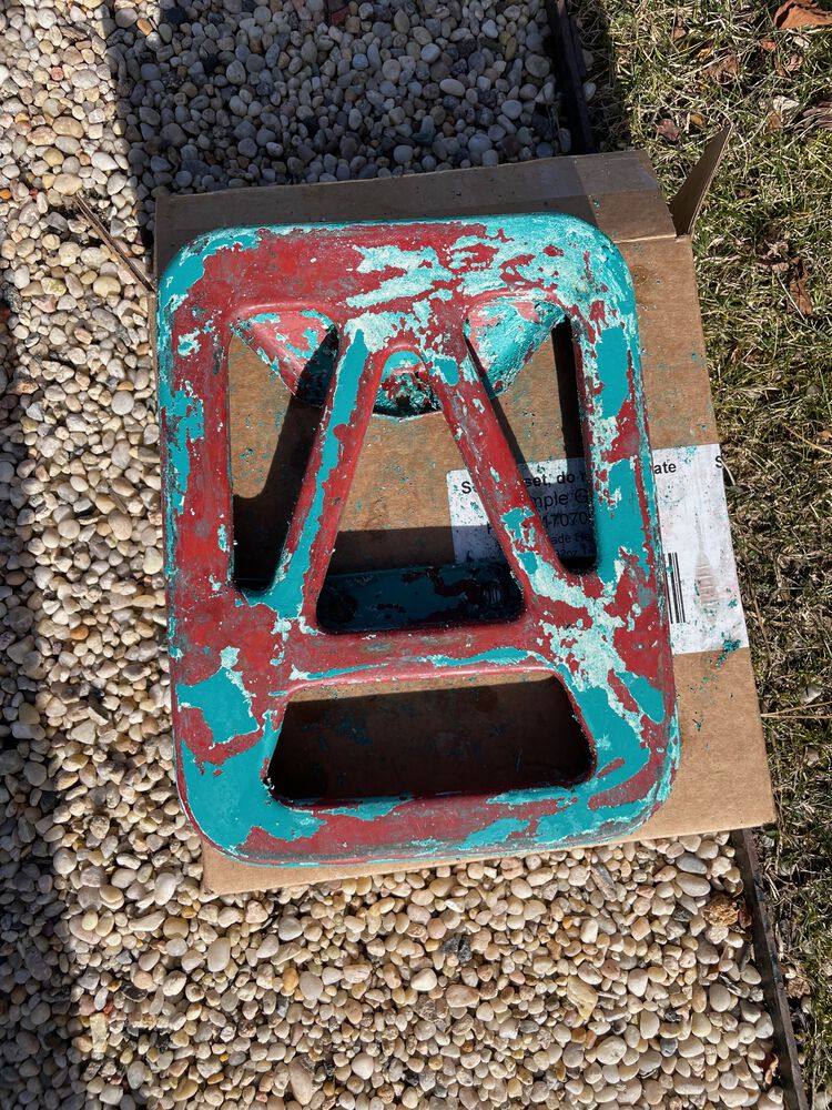

Ran a paint stripping test with the rear seat platform. Only takes off the spray and prep. The original red does appear indestructible. Anything anything better do remove the paint? A gallon of stripper was $60, seems i can get an orbital sander for that much. would that be better?

2 coats of Stripper, yea its messy.

For the paint removal. Use citrus strip and coat it on pretty thick. Then cover the stripper with Saran Wrap (cling wrap or whatever the non brand name is) and let it sit for 24-36 hrs. It'll come off very easily that way. I just stripped a scoot to bare metal this way. The outer paint was very hard and was brushed on. Wire wheel did nothing, did a test on the headset top piece and let it sit for a day or so then the paint came off easily. The stripper doesn't work as well on paint that's over filler though. For that you'd have to use a heat gun or torch to remove the filler as well as the paint.
