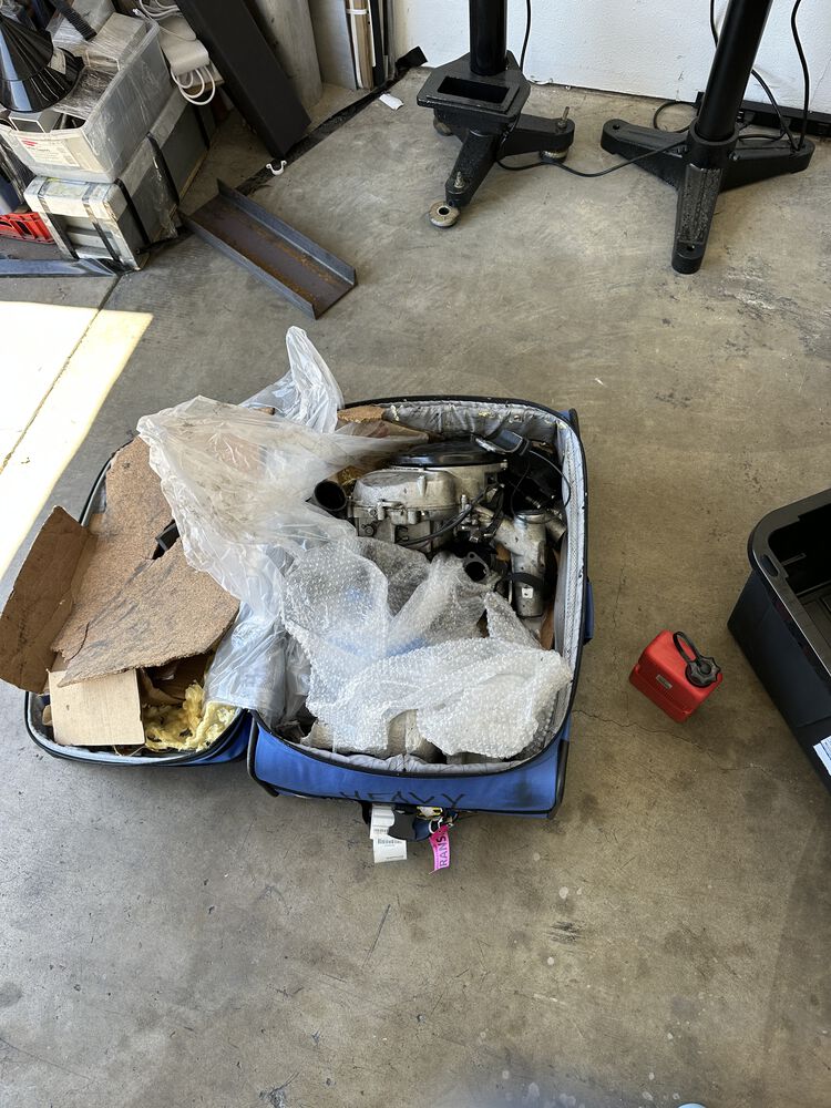

charlieman22 wrote:
Guess I better let the War Department know that suitcase isn't ever coming home... Razz emoticon
Thanks, CM2, for grabbing the bag from the TSA and getting it turned around to ship out.

That bag has so much fuel soaked into it, I'll be shocked if there isn't a dumpster fire before it leaves my place!
Dumpster fire bad.
Can't wait to see the small state up and running again
Oh, c'mon...who doesn't love a good dumpster fire? Razz emoticon
That bag was in our basement when it flooded during Nashville's all-time heaviest rainfall a couple years ago and was replaced soon thereafter. I used it as a cart/carrier to haul other flood-damaged items from the basement to the trash afterwards, so it's not like it hadn't had a long, full life.
More importantly, the motor is on its way home, so I can once again look thoroughly ridiculous while terrorizing the streets and sidewalks of Nashville like a cracked out chainsaw. Laughing emoticon

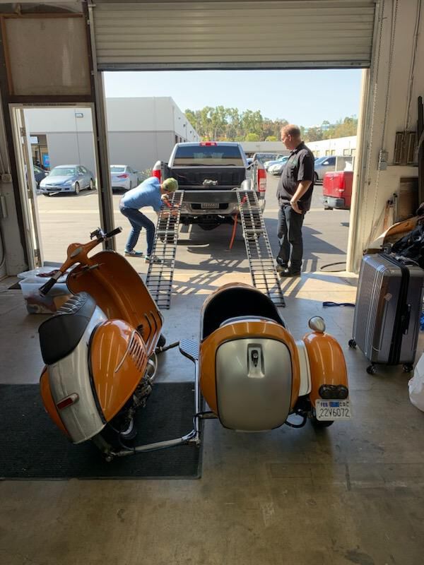

The Eagle has landed.
I haven't had a chance to actually open it up yet, but that'll most likely happen this afternoon/evening.
I'm certain from his photos that CM2 did an excellent job of packing it all. I know the UPS driver was extremely happy that I carried it from her truck myself. 70 lbs was a lot more weight to her, at about 5'2" and 120 lbs than it is to me.

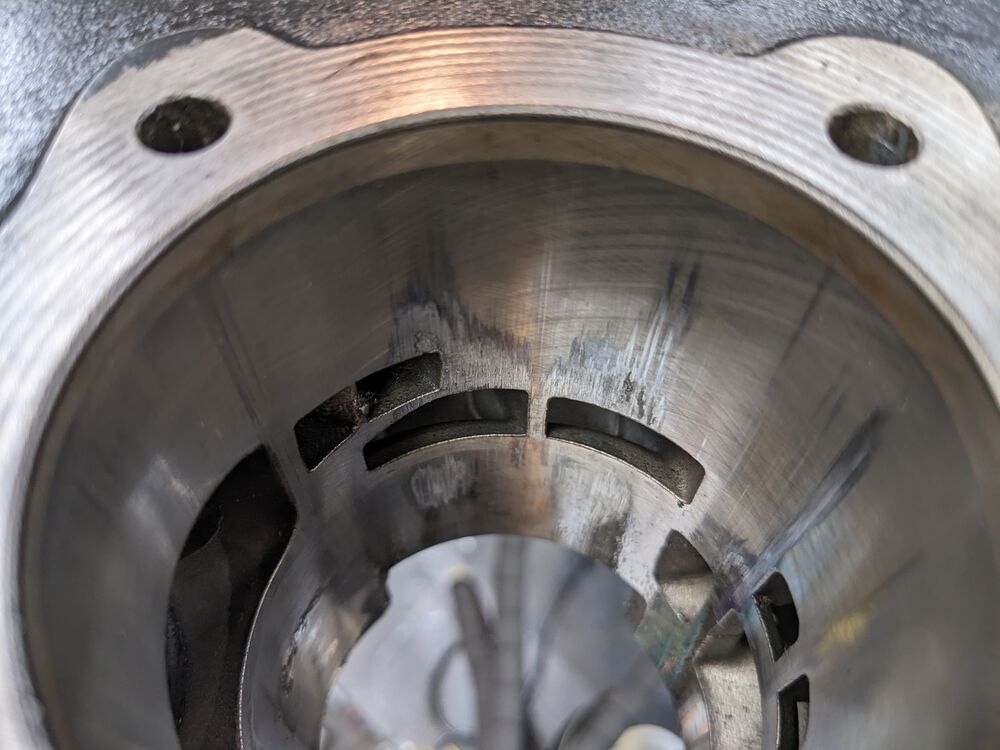

Just because I like to torture myself, assuming the Nicasil isn't completely trashed, I'm going to at least see if I can get compression back on the motor, if not pick the rings out of the piston and try to run it with the old jug on the stand.
I ran a BGM with Nicasil damage below BDC for years. Maybe still am. I don't recall if that's the one that's on the GL now or not.

I know the Nicasil is damaged and have a replacement top end on the shelf already. I'm just doing it for giggles. My plan is to send the damaged cylinder out for replating, which will run me about half the cost of another top end.
Either way, I expect I'll be back up and running by tomorrow afternoon.

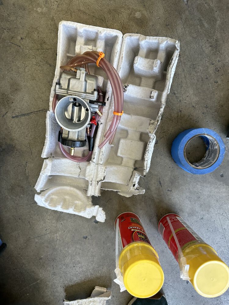

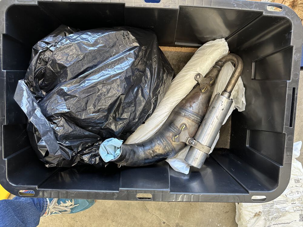

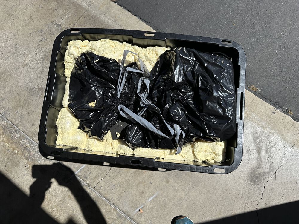

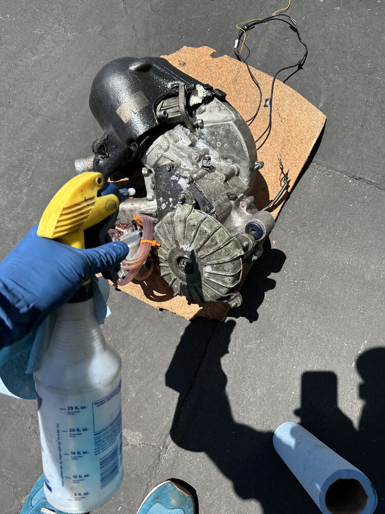

I used expanding foam - I've had two cans sitting around for about a decade.
The motor and exhaust are in plastic bags to protect them - with the foam sprayed into the bucket directly.
I wasn't sure if I was supposed to shake them first - because I didn't read the directions - and after I filled they didn't seam to expand much or cure.
But then, after a little sprits with water, they kicked off. When I realized how much they were expanding I closed it all up and put zip ties on. I'm pretty sure it was still expanding when I got to UPS.
I'm just glad the container didn't arrive exploded. That would have been ironic.
The spritzing with water thing is good to know, because it didn't expand much when I did it, either. I'll have to try that at some point.

And...it's back!
New top end on, it passed the pressure test, then first start and it'll go back into the bike tomorrow.
The old jug had enough Nicasil damage that there was no point in having a go at fixing it.
Ow.

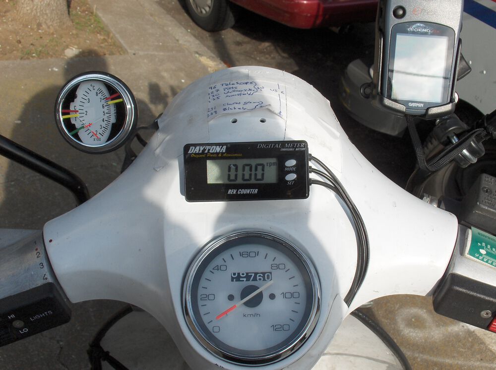

also, nice thing about analog gauges with a limit line is that there is zero mental computation, "is I is, or is I ain't over the limit"
I put a yellow line where I want to be running, and the red at here be dragons.

chandlerman wrote:
And...it's back!
Sounds good. Why on the stand? In the frame would save time.
That old cylinder is really torn up for a quick seize. Is the cost $300 plus a new piston?
Do those aux ex ports break into the studs? Will be some fancy casting if they don't.

chandlerman wrote:
And...it's back!
Ooooooooh yeah…!
chandlerman wrote:
The old jug had enough Nicasil damage that there was no point in hhaving a go at fixing it.
Ooooooooh no…………
Interesting there's no marks along the cylinder studs.

oopsclunkthud wrote:
I'd gladly take that old cylinder off your hands
My plan is to get it re-plated so I'll have a spare on the shelf. I have a spare piston already, so I'll be good-to-go for next time. Yay?
I have an analog EGT I've used in the past and 110% agree with your thinking. The reduced cognitive load of analog/visual vs. digital/value instruments has been pretty well-proven for a lot of years. It's one of the reasons I still wear an analog watch.
How far from the cylinder do you install your EGT probe?
I've seen recommendations from 1" to 5" and I'm thinking I'll install it about 2", which puts it on the exhaust stub (which I have multiples of) versus on the actual pipe. I have the probe installed at about 5" or 6" on my GL and it never really read all that well, so I'm thinking less must be better, but how much less?
It is, but I already have the piston on the shelf, so it's net $300 to me. Half the price of a new top end, even if it doesn't include the other bits, but I have all of those on the shelf, too, so that's a wash.
I blew up a BGM 177 one time when I mis-read the main jet and put one in that was, IIRC, twenty points too small. Came hard off the line with the CHT just over 200F at the start. I got to about the same place (back to WOT in 4th) when it seized.
I seized my Polini 177 when the oil pump failed and it also had a very similar look, but cast iron just took it and kept ticking.
I'll see if I can dig out some pictures for comparison. It's the lack of lubrication that does the worst of the damage, more than the heat.
