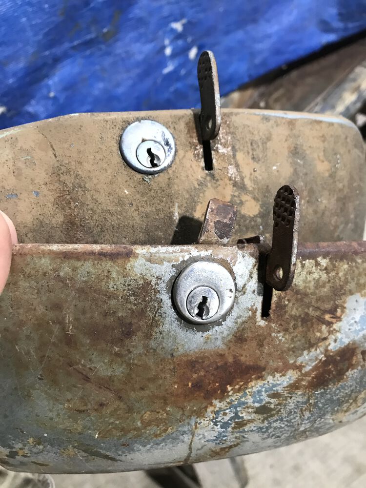

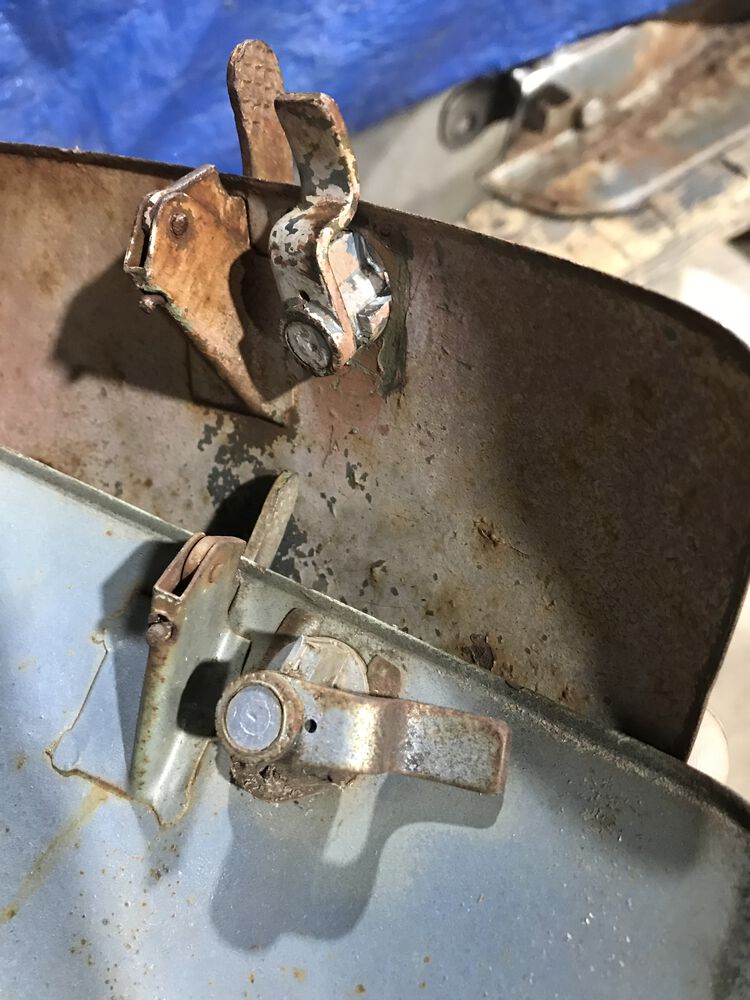

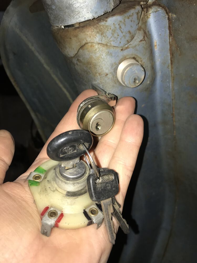

I have two different column lock cylinders and two cowl lock cylinders with no key for any of them. I'm also looking to get a new key cut for my about to break P200 ignition switch key. It's true that i can simply buy brand new locks with a key included, but i'm very unimpressed with the quality of the repops. Does anyone sell key blanks anymore?

I don't think any of those keys pertain to my lock cylinders. Especially any of the P series steering column lock keys as well as that 2004 PX key.

I used to have a separate key for steering column and side glove box, and I also lost both key once.
Rather than bought a new lock set, which was rare for 66 Super, I went to a locksmith. Fortunately, he could make a new key for me without the old key template. Also, He combined the glove box and steering column key cuts, so I just need 1 key to lock and unlock both.
I was very lucky, because the locksmith have dealt with Vespa key issues several times, and he also has Neiman key blanks.

The column lock keys can be found on ebay, original with "Vespa" stamped on them. or at least they could a few years ago. Just looked, price has gone way up.
https://www.ebay.com/str/klassickeyz
63V fits the GS column lock (not yours) (same as ilco 997x y6)
I think the R63V fits yours.
An oldschool locksmith can cut a key to fit the lock, and would likely have a blank that is compatible or close enough.
