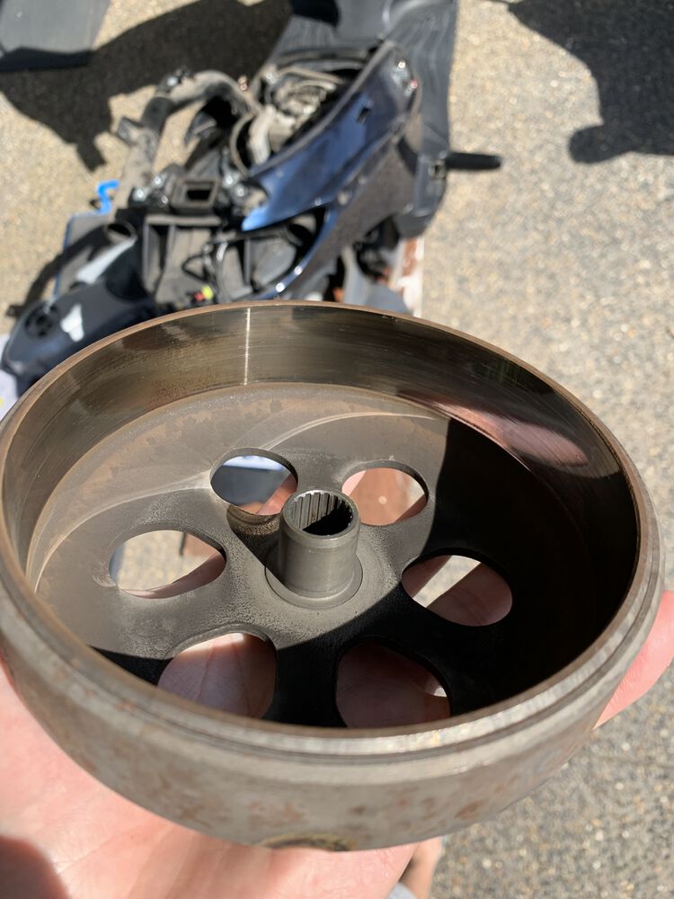

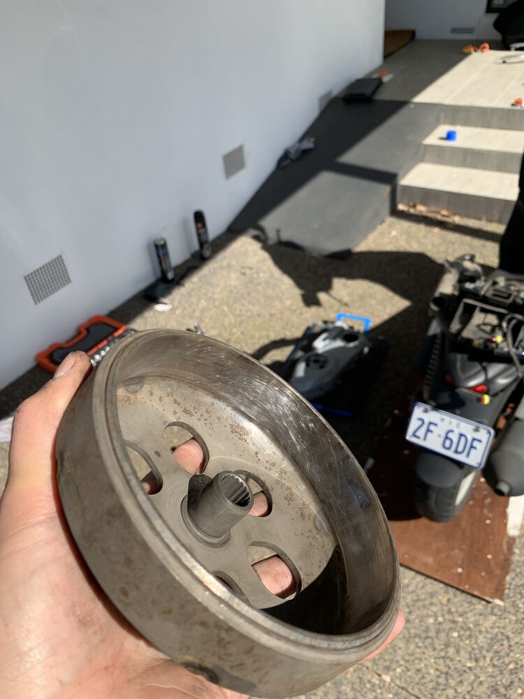

I unfortunately read your post after I completed the job but I'm happy to report that all is working much smoother now after takeoff!
I've uploaded before and after pictures of the inner side of the clutch bell for reference.
I Saved myself hundred of dollars thanks to the knowledge of this community.
Thanks again
Before
Before
After
After
