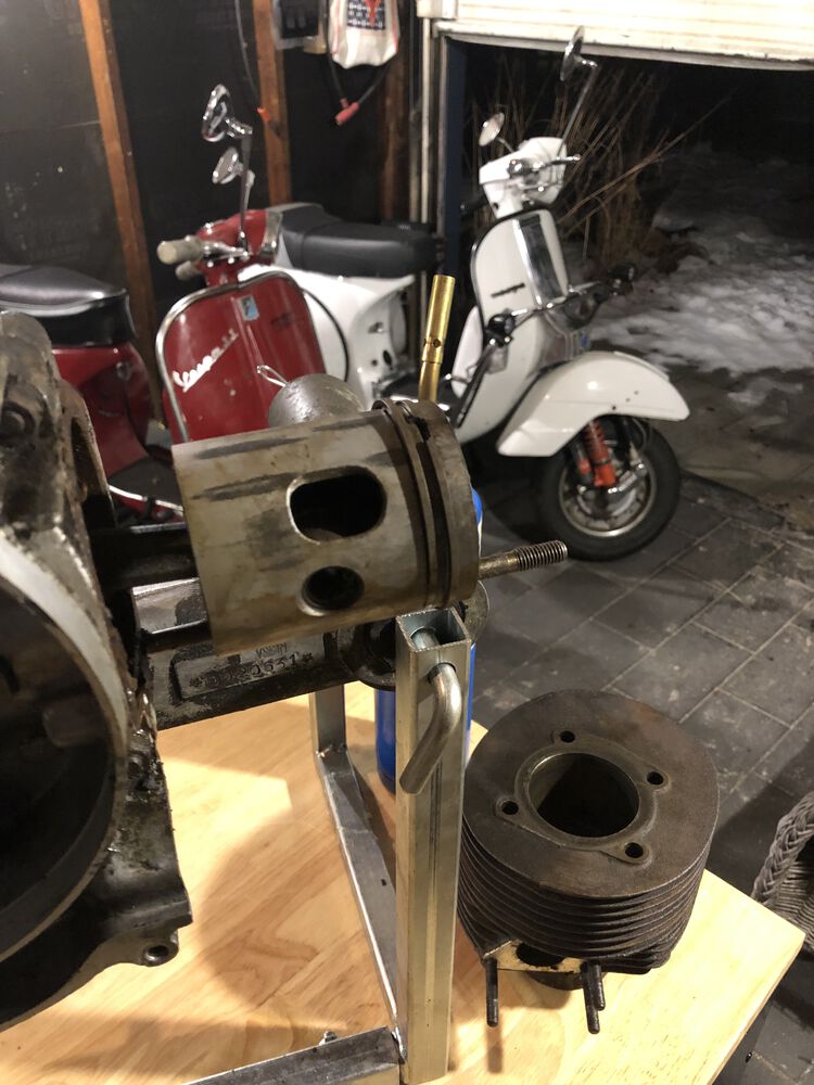

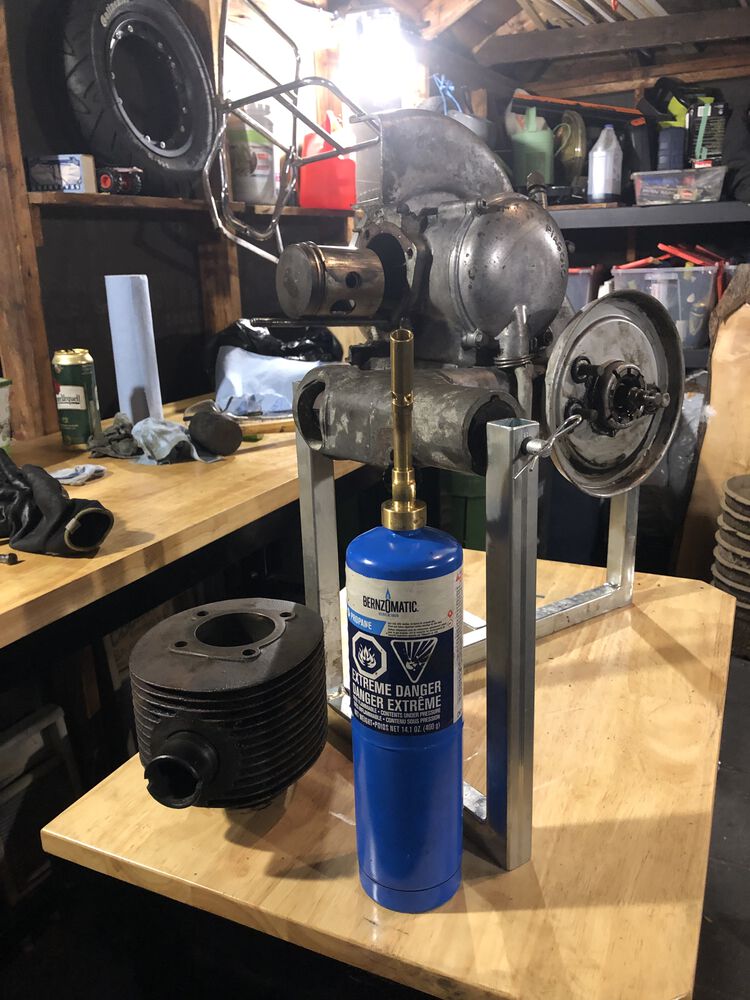

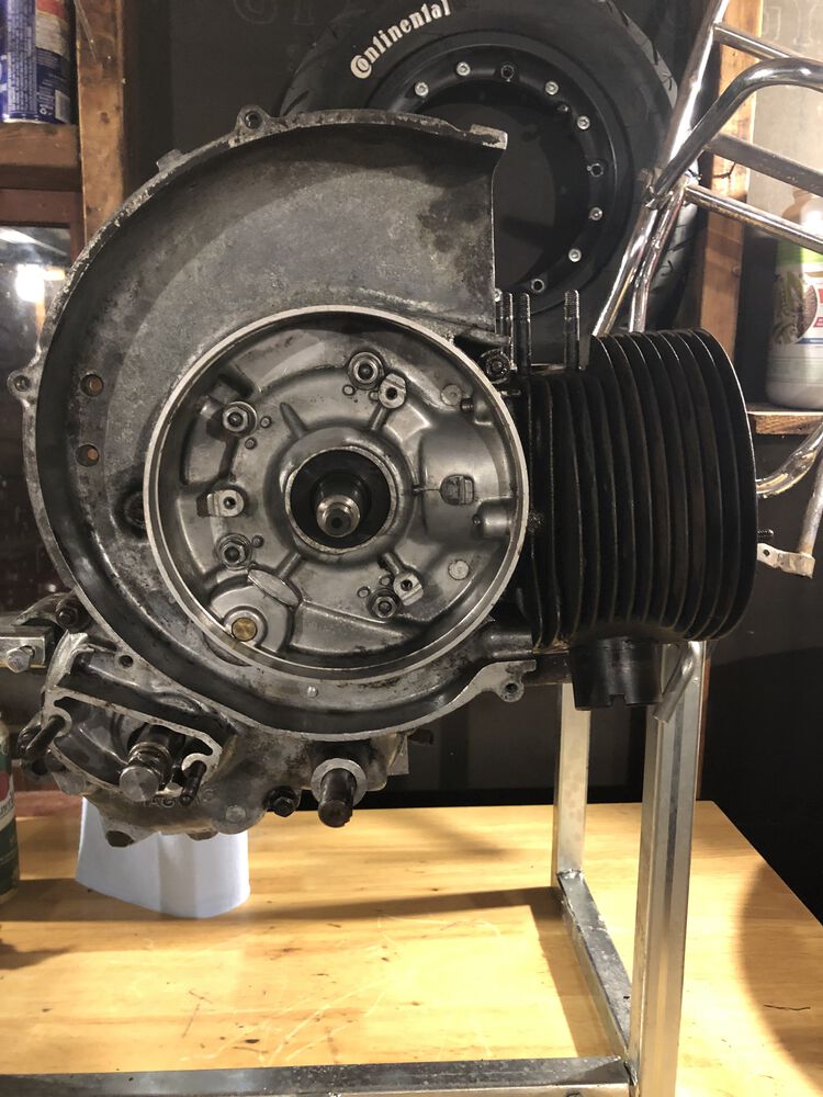

I sourced a SS 180 engine for my scoot and in the process of doing a rebuild. I'm finding it hard to remove the cylinder from the engine. I took off three of the cylinder studs off, piston travels freely in the bore, but can't manage to slide out the cylinder.
I'm thinking someone used super sealant on the base and it's superglued on the engine. Any thought on how to free it?
Mandatory pics of the engine:

Heat the joint with a propane torch? Might soften things up.
@greasy125 avatar
Posts: 15121
@greasy125 avatar
Posts: 15121
^^ 2nded
heat and tap around the barrel with a mallet, a soft face or even a small block of wood. and seriously just *tap* it around. all you're trying to do is introduce a little wiggle and then you should be able to work it around and get it off.
I've done this before, and I don't recommend it... but, if the piston is in a position where is is moving past the exhaust port you can put a wood dowel in there and try rotating the motor. piston contacts the dowel, jams it agains the exhaust, the movement of the piston pushes the barrel up and off.
but really, I'd just heat it and tap it till I got it.
worst case you could always crack the cases and pull out the crank and barrel/piston together.

First... Congrats on scoring an engine!
Second... All the above. Heat and some tappy slappy and you should be gold.

Thanks for the advice! I'll try some heat and will let you know how it goes

Happy to report that some heat and gentle tapping with a rubber mallet did the trick. Woo hoo!!!

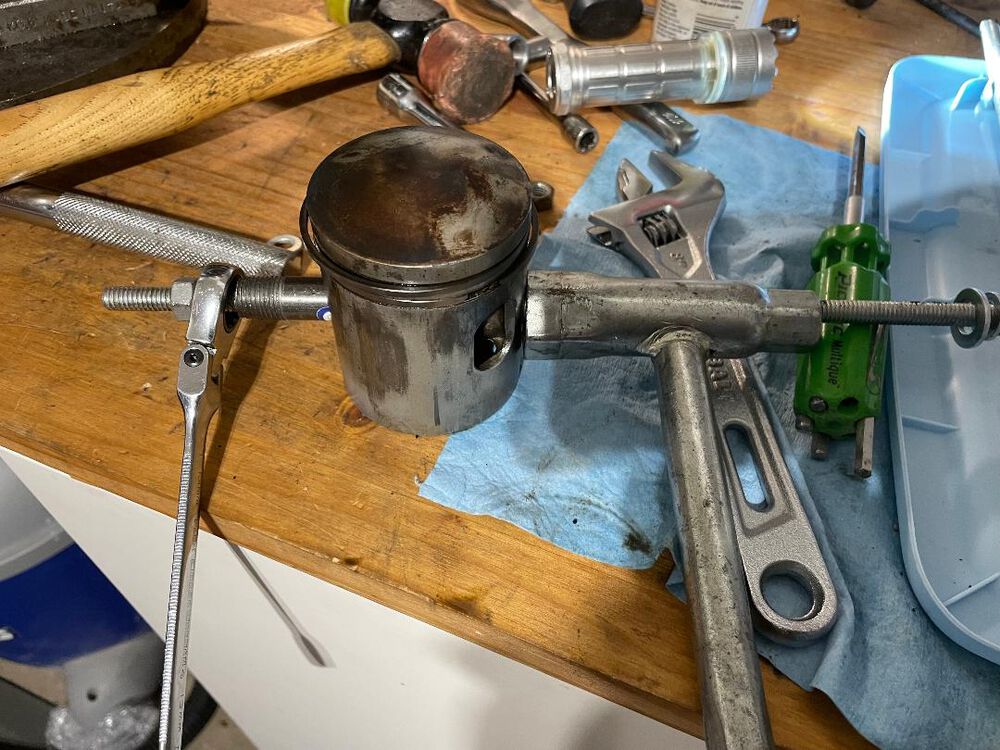

1. I have one cylinder stud that is being stubborn and won't turn. I am using the two nut method to remove but the nuts are turning while the stud stays still. Should I apply some heat here as well?
2. Any good tricks for removing the fudge on pin from the piston? Can't get it to budge.

the same on the piston, throw some heat at it and see if you can get it to move. a 10mm socket is usually just the right size to fit in there and give it a shove. try and avoid reefing on it for the sake of the crank/conrod.
a piston pin puller is really the right tool, but if just pushing on it doesn't work you can fake one with a 10mm socket, another deep socket, say a 17 and a length of all thread and two nuts.

Piston grudgon pin... allthread as Greasy said. Pic below
All thread set up.

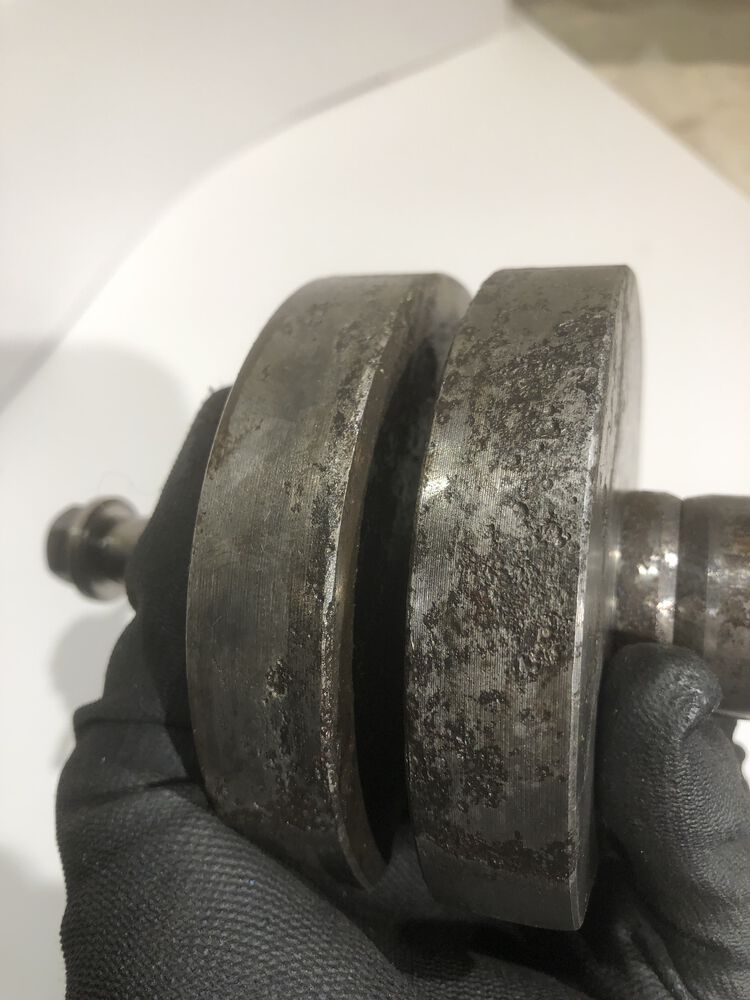

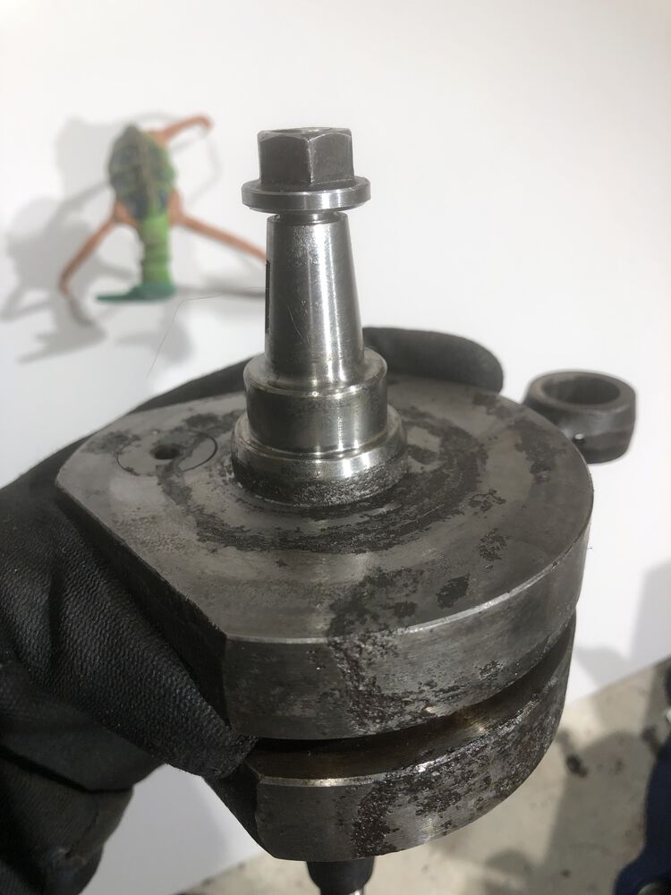

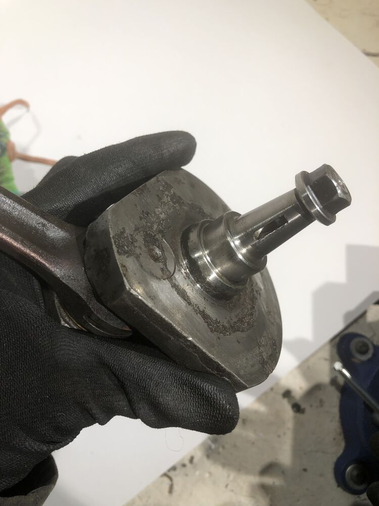

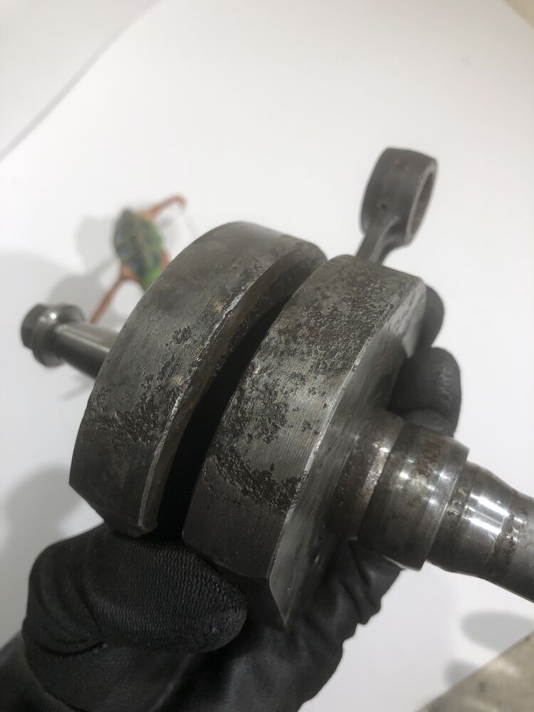

Hi All,
Any opinions on this SS crank? I noticed sone pitting on the metal, just curious if this will affect it in any way and if I'm still ok to use.
@moto64 avatar
Posts: 2448
Location: NYS
@moto64 avatar
Posts: 2448
Location: NYS
Great you found a motor ! I doubt the pitting would do any more than alter the chamber volume by a miniscule amount but I'd be concerned about the seal contact surface and the condition of the con rod bearing.
Yeah, it's the pitting where the seals would sit that has me worried. The rod has a little side to side play but no up/down play so I think it should be ok

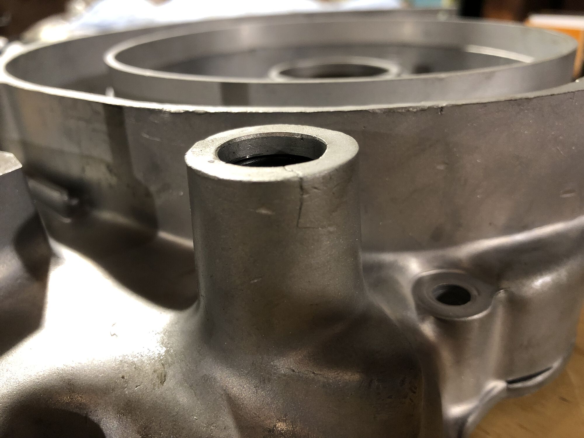

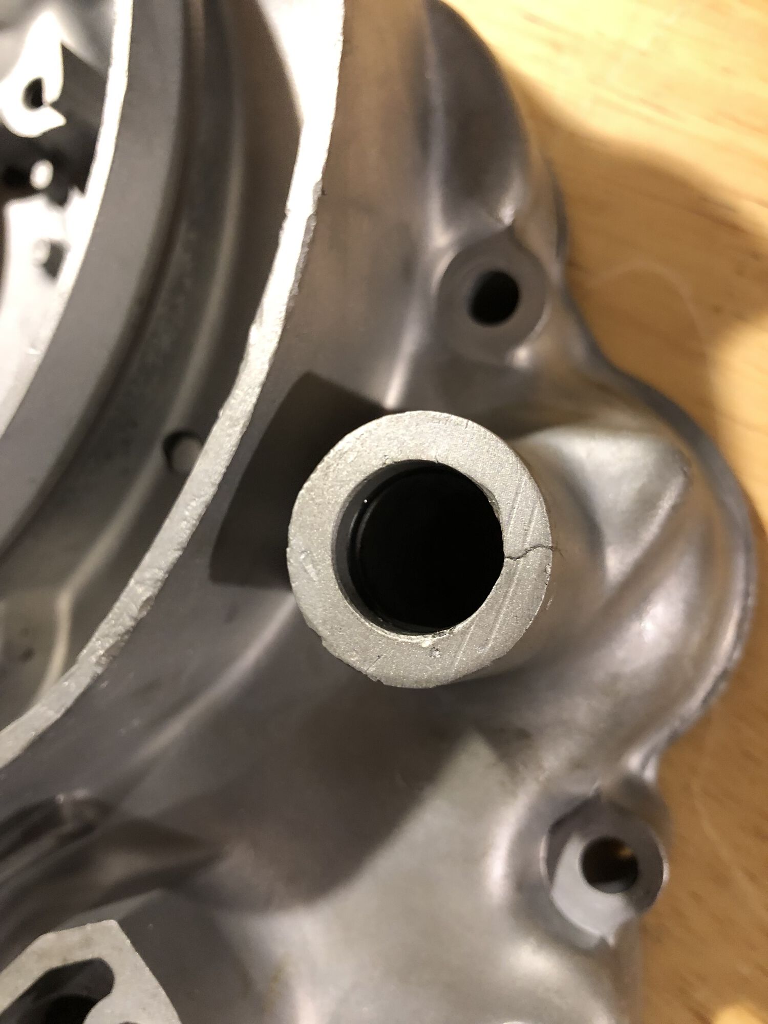

OK, this project is stop and go and have been making some progress. Tonight I was refitting the kick start gear. The gear was not sliding easily through the hole. Gave it a slight tap with a rubber mallet and found two issues:
1. I found a small crack in the case by the kick start hole. See pics below. Does it look bad enough to be concerning and is it fixable?
2. Could the kick start gear be bent ever so slightly, hence why it will not easily slide into the case?
Small hairline crack by kick start hole
Crack from another angle
Closer shot

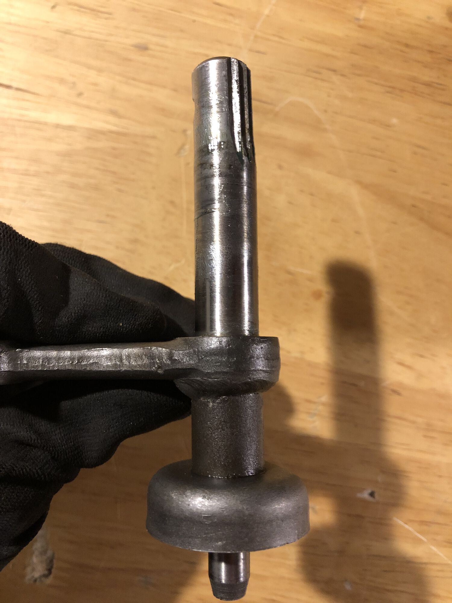

Is it me or does this look slight bent?

The shaft looks bent. If you put a straight edge on it, you'll probably see a gap. Most likely the bike went down on the right side on the kickstart lever and bent the kickstart shaft which cracked the case. The cracked case can be repaired by a skilled person. Have someone who knows Vespa engines weld it and not just some welder dude. It needs to be done right. Then get a straight kickstart shaft. There should also be a rubber o-ring inside that opening about a half inch down inside a machined groove inside the case. This prevents oil from seeping out.

shaft looks sus AF, I'd be replacing that straight away.
while I don't think that the K/S lug is going to fall off, I can almost guarantee it's going to lead and the crack is going to get bigger.
it needs repaired properly, by somebody that knows what they're doing.

What is it with SS180's and KS failures?!? Gah.
I have lived and breathed similar.
100% repair the crack. Replaces the quad. Repair needs to be done by someone skilled (Gick, Casola, etc).
Good luck

Thanks for the advice everyone. New kickstart shaft on order & have a good lead on someone who can address the crack. A will keep you posted with progress.
