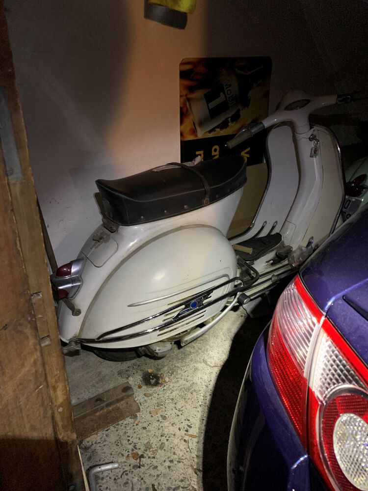

160GS MK1 with only 1 previous owner, original paint and service history- even got the service book. Full history since new and has been stored since 1967.
Cant wait to get her up and running

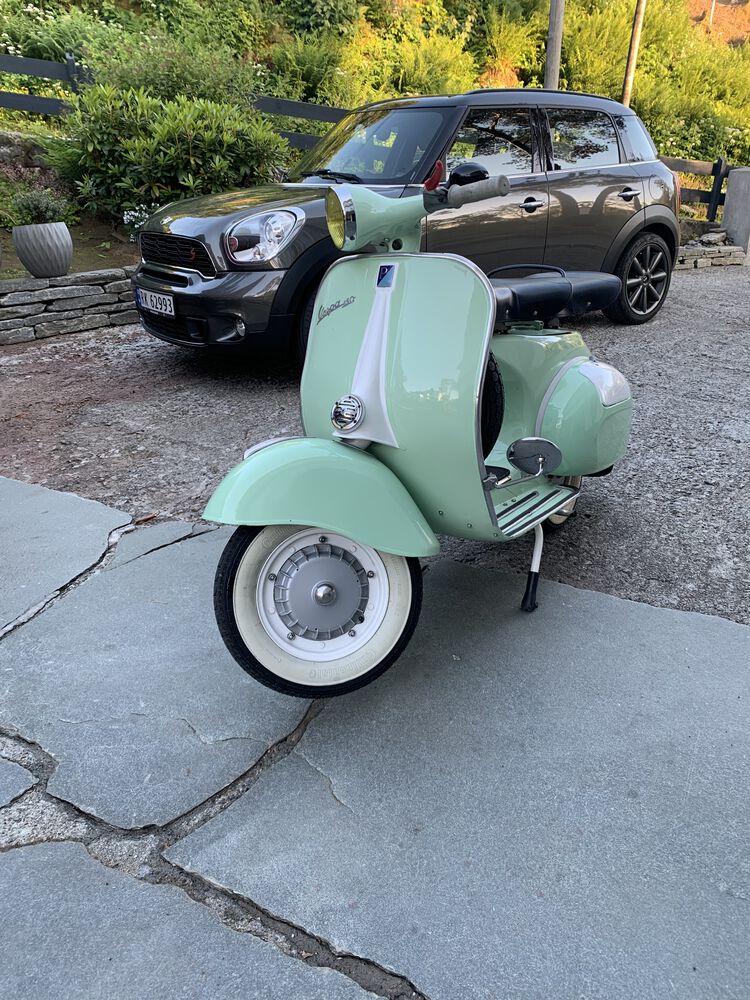

Nice find!
Is it from my eyes or there's another in front? light green it seems...

Awesome. More pics when you can please!

Needle in the haystack find. Good for you and yes, please, put up a lot of pictures.

Your right, the green one in front is a VGLA 1960 with a P200E engine which i rebuilt about 10years ago.
Will add more pics of the 160GS

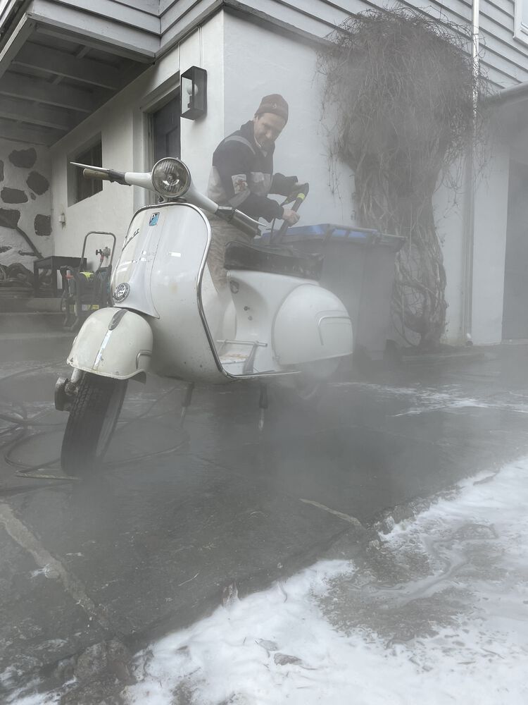

Started with a careful wash down

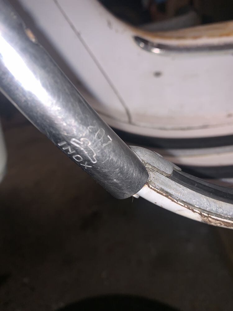

Question... is it ulma 202 trim or 207? Or?

Thanks, and I fully agree, stunning lady for sure. The legshield is INOX 207
Seems the front fender has been repainted, ill post more photos when I take her outside during daylight in the weekend.

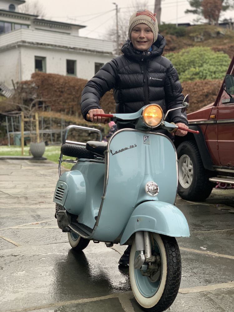

Sure, sorry the delay, just wrapped up a 1964 smallie for my 12 year old son!

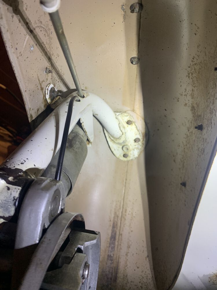

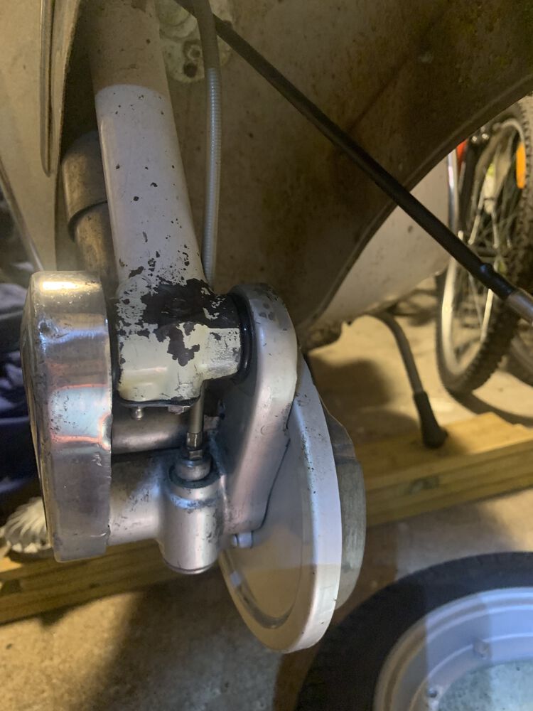

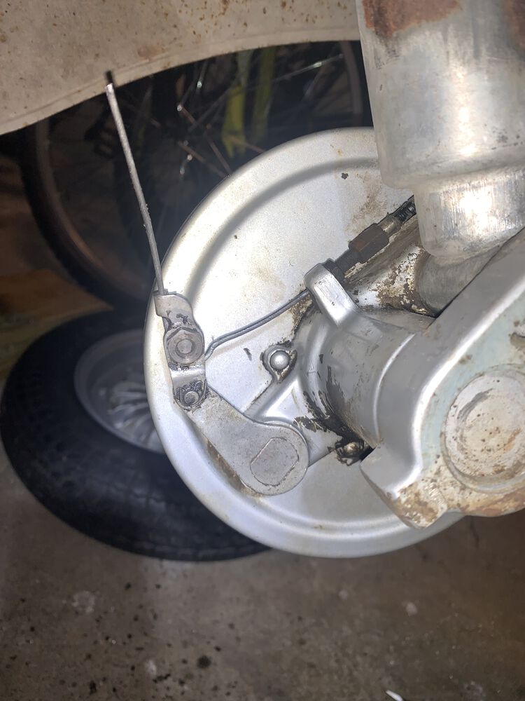

Cleaning and greasing front break wire, incredible condition😊 only surface rust inside the front fender

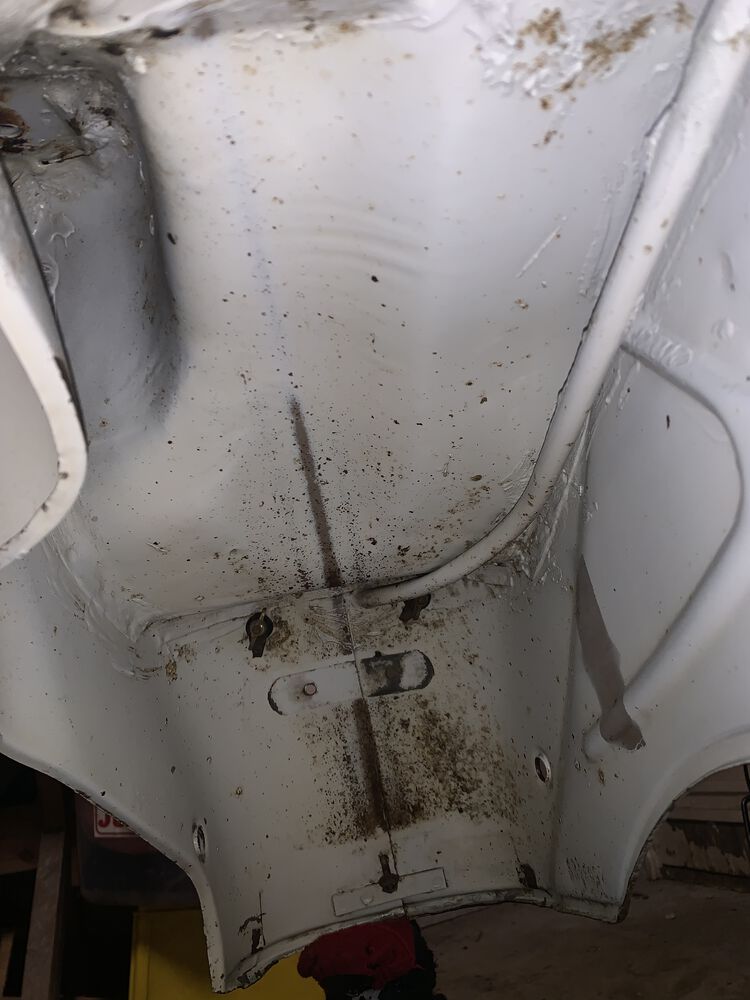

More cleaning to do, getting there

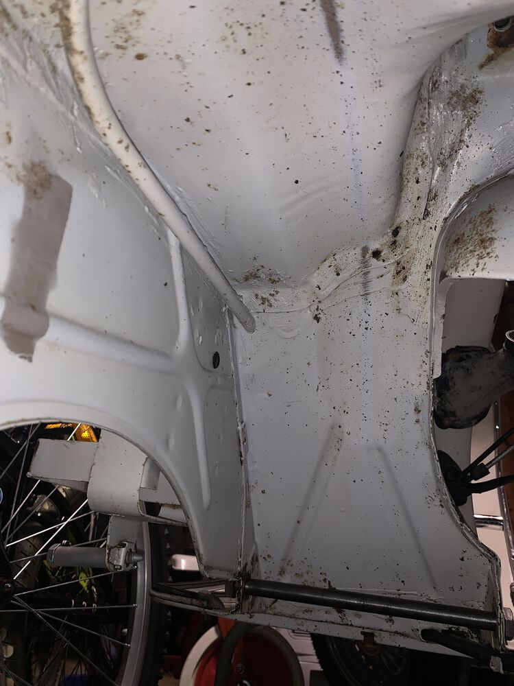

Any recommendations of treating the surface rust inside the front fender? Normally I would grind carefully and use epoxy paint. But happy to hear other recommendations.
Due to the originality Im trying to work very careful with this one👍
@qascooter avatar
Posts: 5240
Location: Florence, OR
@qascooter avatar
Posts: 5240
Wow, that front end is in amazing shape!
As for the surface rust -
I'd lightly brush it with Ospho, then wipe that down.
After that, maybe some 0000 steel wool or 2000 grit wet sandpaper, and gently wet sand it.
Rubbing compound
Polish
Wax
Then at least it'll be protected.
And I love the picture of your son with his scooter. That's awesome...

Holy cow that is clean!
Ospho is also my go to for rust remediation. Easy to use and works very very well.

Ospho or CLR.
Ospho will leave the metal dark but is better when large chips are present.
CLR is better for removing rust stains that show through the paint, but the paint is still mostly intact.
parallelogramerist
Posts: 6206
parallelogramerist
Posts: 6206
If you want the rust completely gone and zero "dark metal", use Opsho as a "metal prep". Brush on a coat of Opsho and let it sit for about 10~15 minutes (but don't it dry! If that means brushing more on, then by all means brush more on). After that 10~15 minutes, start scrubbing with a new red scotchbright pad. Brush some more Opsho on and let it sit for another 10~15 minutes, then scrub it some more. If the metal is deeply pitted with rust, use a soft brass bristled brush. The point of scrubbing with the Opsho is to remove 100% of the rust...not just coat the outer layer of the rust with the stuff. When you're done scrubbing, all the rusty metal should be shiny bright (it might take 3~5 scrubbings). Immediately rinse off all the Opsho and dry the metal completely. Then use your favorite primer and paint to cover up the bare metal.
And i'd highly recommend to remove the mudguard when doing all of that. It will keep Opsho from dribbling down your arms. Plus you will also get the opportunity to remove any rust where the mudguard bolts to the fork.
@orwell84 avatar
Posts: 4039
Location: northern New York
@orwell84 avatar
Posts: 4039
You can also use naval jelly. Same kind of thing as Ospho except gooey, so it doesn't evaporate as fast and sticks to vertical surfaces. I use both quite often. Scrubbing with a wire brush works well and you can get all the rust out with enough applications. I use it for places I can't sandblast.

Washed down inside of front fender with car shampoo, not much rust
Posts: 2563
Location: Siam
Posts: 2563
Location: Siam
That looks great. Probably car wax is all that's needed. That's a beautiful GS. Avoid any urges to "restore" it.
