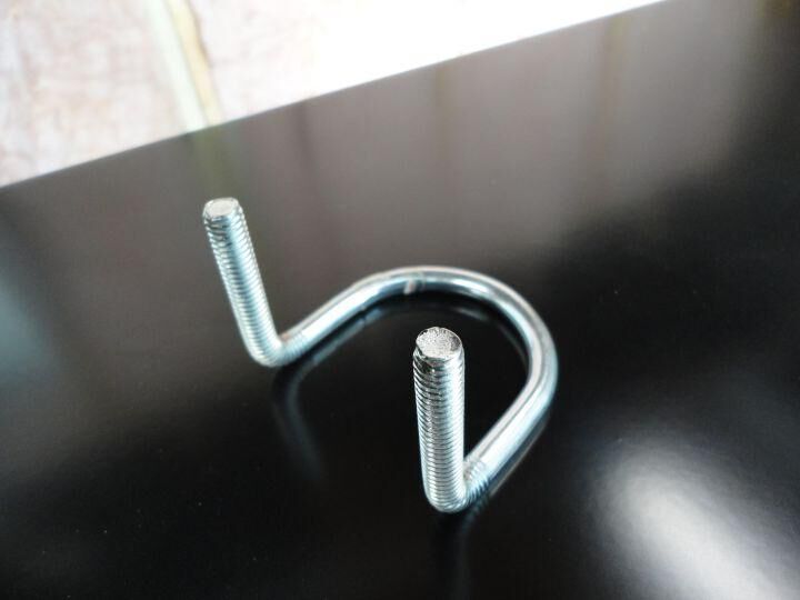

Just get a u-bolt from the hardware store:
Frick you are the best. I was just looking at things to jerry rig. I guess I gotta bend it
Posts: 46114
Posts: 46114
A vice and a BFH will do the trick.

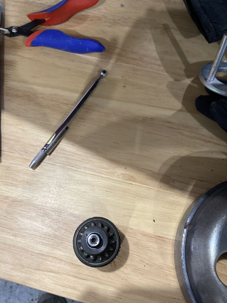

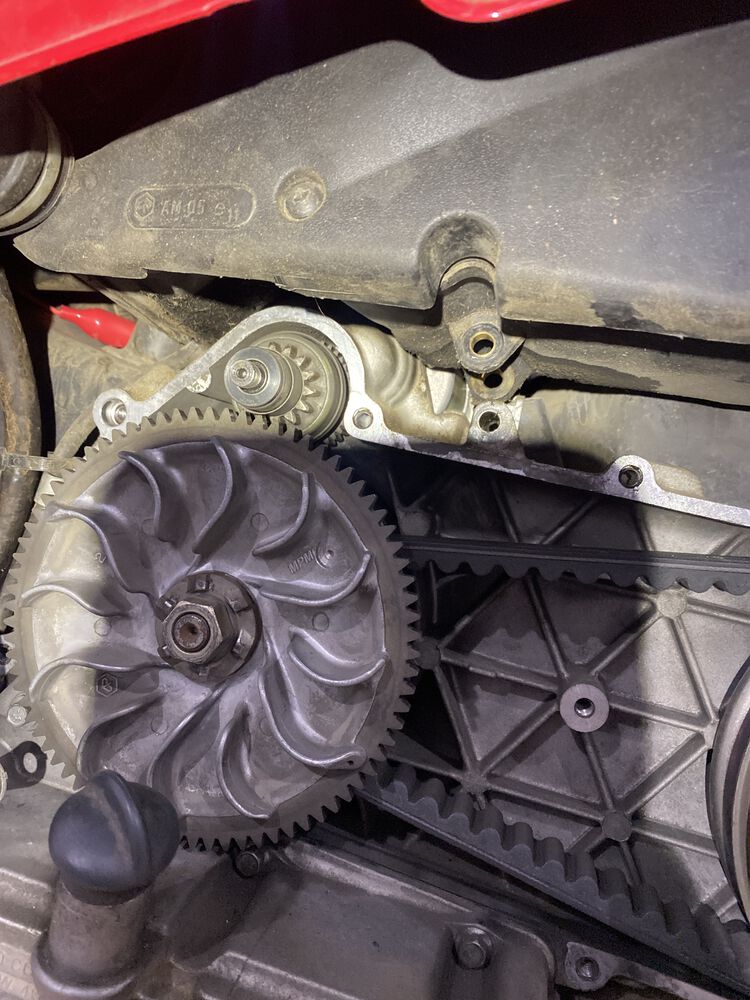

Ok got it off. Not sure how to tell if it looks bad. Silly question. Am I allowed to start it?
No! You have to remove the variator driven pulley (the outer one) to get to the bendix. Then you should be able to remove it, clean it and reassemble correctly against the starter motor splines.
You'll need a variator holding tool - you'll need one anyway when it's time to replace the belt and rollers. The Buzzetti one is fine, but be aware you may have to file the bolt-hole quite a bit to get it to fit comfortably:
https://scooterpartsco.com/tools/variator-tool-for-vespa-piaggio-and-aprilia-125-200

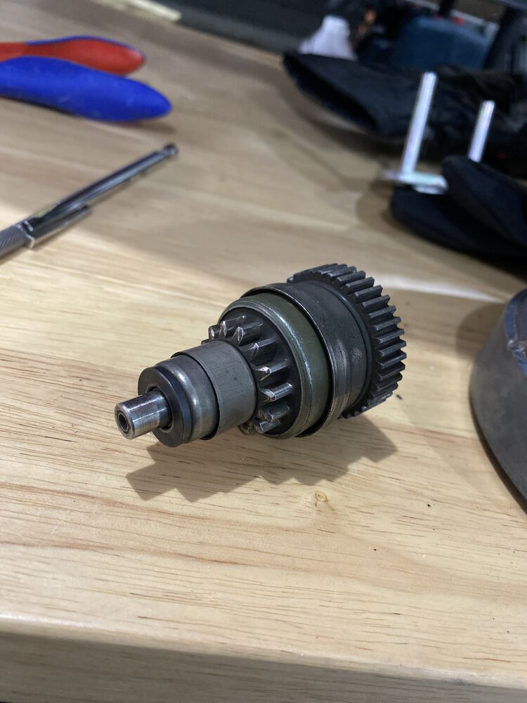

I did it anyways 😬
Is this indicative of bad bendix. Gotta go get one of those tools just wondering if I should order bendix as well
Does it look like it's spinning the right way? Clockwise? Just wanna rule out if I did something idiotic on the starter
