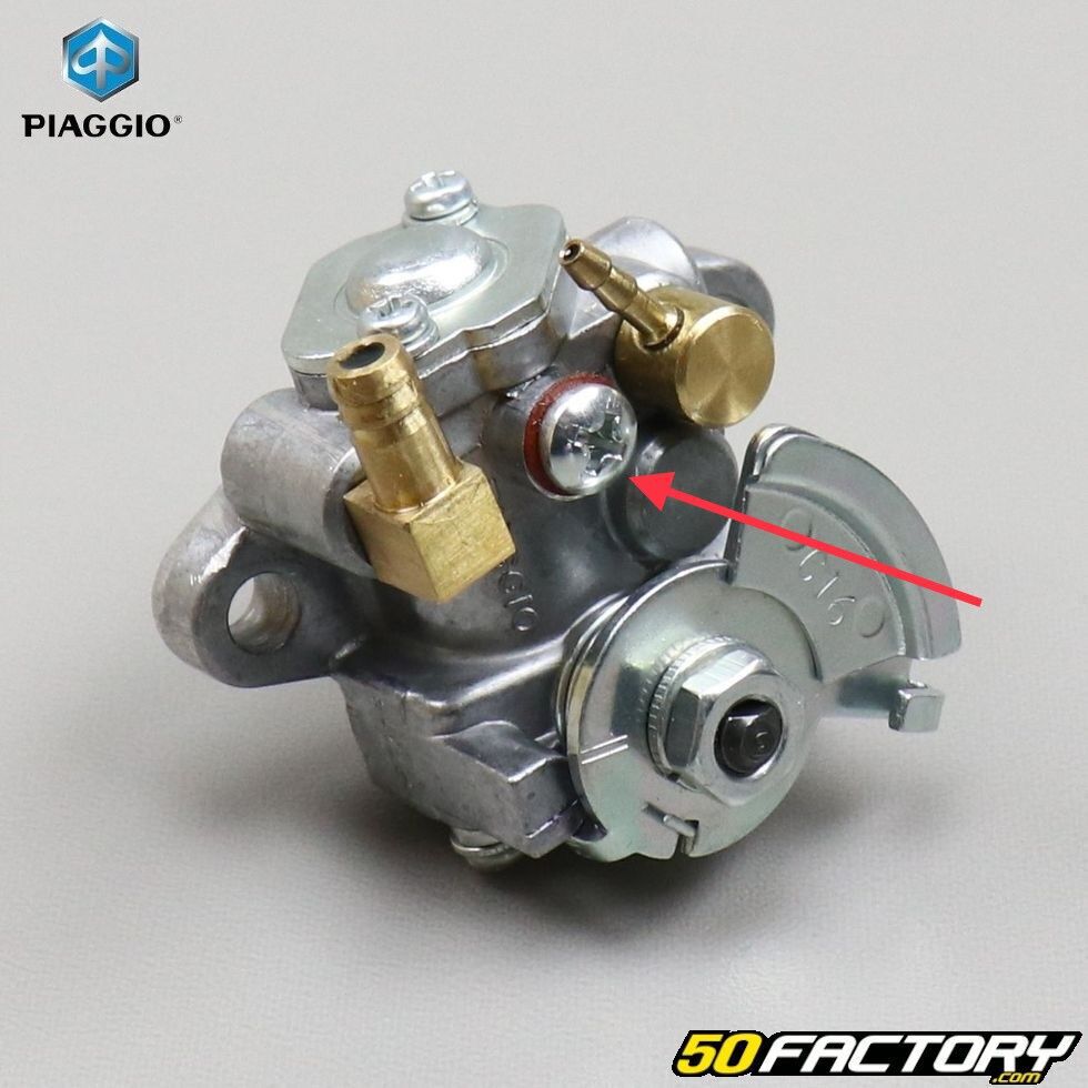

Since youre getting close, dont forget to bleed the air out of the oil pump line when the motor starts turning!
@slowpoke avatar
1952 allstate (early), 1958 allstate, 2009 S150, 2001 ET2
Posts: 226
Location: CT
@slowpoke avatar
Posts: 226
Location: CT
I don't know how to do that. I did not dismantle the pump but I changed the hoses making sure that they were full of oil all the way. If there is a little bit of air in the line would it suck up the gap? Or would that little. But of air make it unable to suck oil through it?
I don't know what to do with that screw the picture is pointing at.
From when I had 2t years ago for the first fill of petrol I put a bit of 2t in it to stop any seizures whilst bleeding pump.
Loosen that screw couple of turns if I remember rightly start scooter and keep it open till all air bubbles have disappeared then tighten it. Then road test it.
Think I got that about right but sure others will put you on the right track if I missed out anything.
Just wondering what happens when you loosen the screw? I don't know what it does. It had oil in it and I put back pressure on the lines when I attached them, there is no air in the system currently that you can see. I would think the pump would take up the air in the system and push it forward. I will use some oil in the gas tank for the first few fill ups due to breaking it in.

It's an air bleeder. Like graham said, you get it running and then watch your hoses. If you see bubbles getting introduced to the carb oil line, you unscrew the bleeder until the air is removed at the pump and then you should see it pump solid. Re-tighten and move on.
Since the lines are full it'll hopefully not have any air but you never know.
