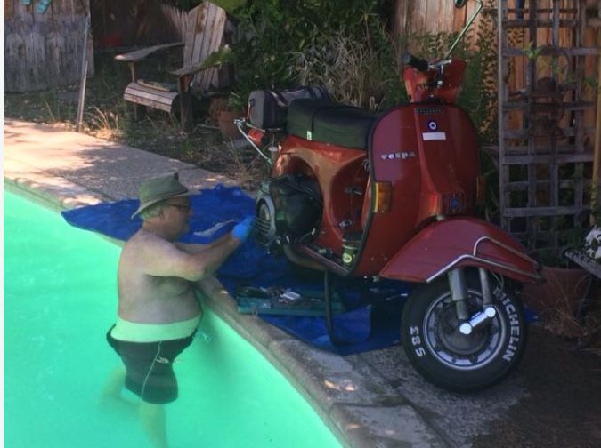

Lift table? Old electric hospital bed? A younger friend who is willing to get dirty?
A member here has a picture of himself working on his scooter while standing in a pool.
Yeah, but that only works in the Summer.

Yeah that picture is wicked love the fact you guys are so inventive USA will always give you a really good answer to any problems us Britt's have difficulty with 👍. Going to try the stand in place on two brick and axle Jack under the back mudguard approach !! Just wish I had a swimming pool in my yard !! Living the dream you lucky GI stay lucky 🌈 soulboy74
