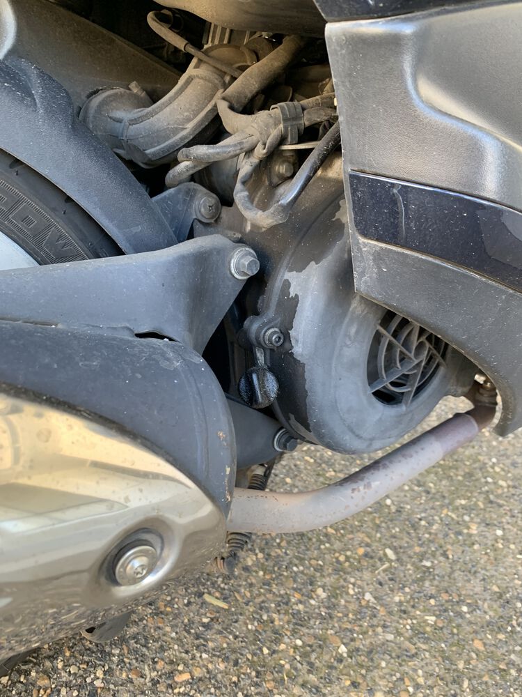

Hi guys,
What do you think is happening here? (see attached) and what is that part called that the oil seems to be seeping out of? It's a fan type manifold I'm guessing.
Bike has fallen over on that side previously.
Any remedies?
Thank you in advance
-Age
Oil seeping
Oil seeping
@greasy125 avatar
Posts: 15121
@greasy125 avatar
Posts: 15121
given how wet the dipstick looks, I'd wager that the o-ring on that has been compromised.
how's the other side of the air box look? has the bike been tipped or laid down at any point? it *might* be coming off a compromised breather tube and down the back side of the case, too.
