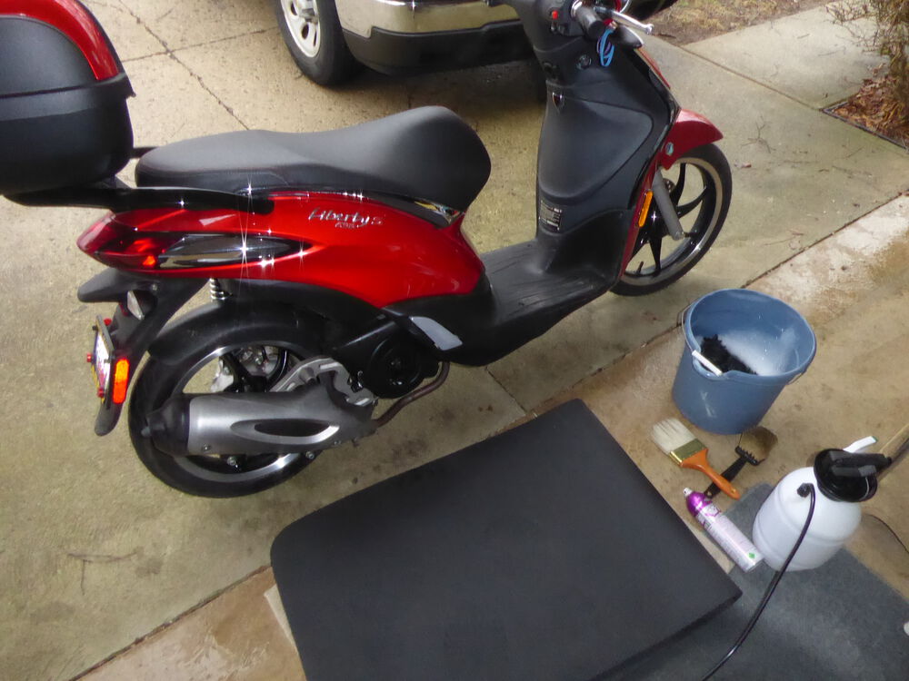

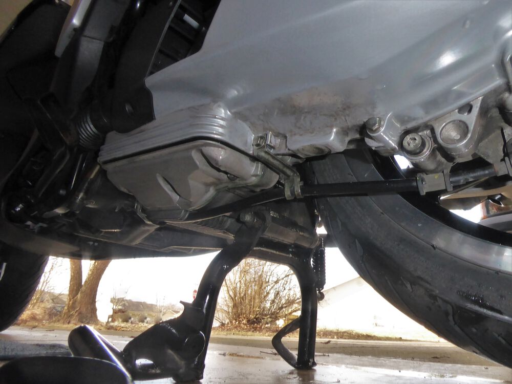

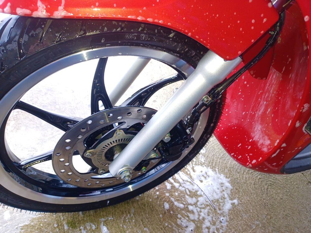

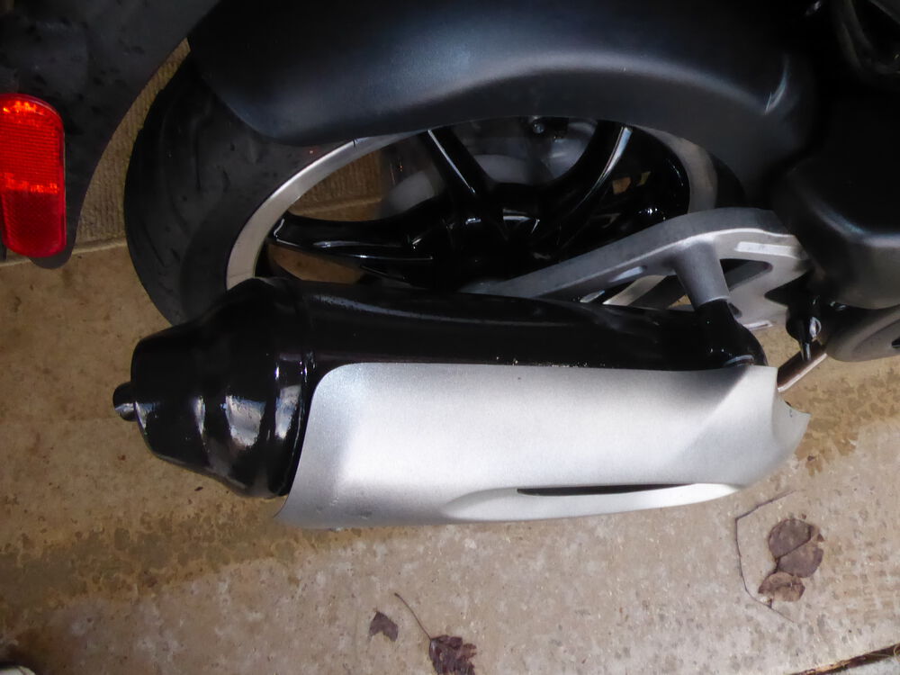

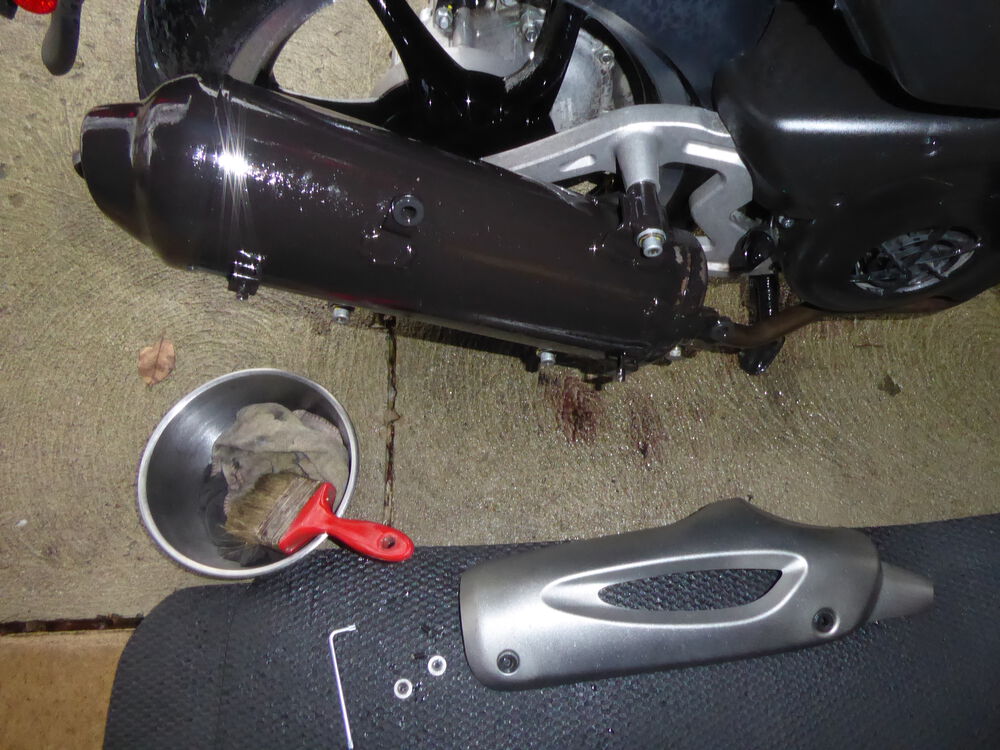

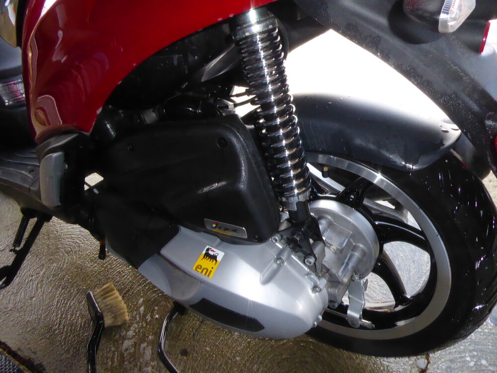

I applied ACF-50 to this scooter in 2017, 18, 19, 20, 21, 22 and 2023.
Seems to be holding corrosion at bay.
I use degreaser to break up the gunk, warm water rinse, dry and apply ACF-50 with a soft brush and rag. Wax-Shop carnauba wax to the body panels.
PS: yeah, the first stop at a traffic light - with that ACF cooking off the muffler is.....heart warming
