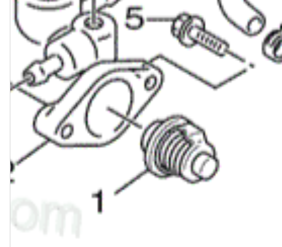

You should be able to remove the t-stat (#1) and put the housing back in place to run w/out. I'd cut a gasket out of a cereal box or something. I've worked on a lot of these little liquid cooled Yamahas (Vino, Zuma & C3) over the last 12 years. I have yet to see a thermostat fail. I might try that first though if you can get to it easy enough before I spent asking price on the sensor. You're perfectly safe to run the scooter without it in place. Put it all back together w/ distilled water in the system. Fire it up, ride it around. If the light comes back, you know it's not because the thermostat won't open.

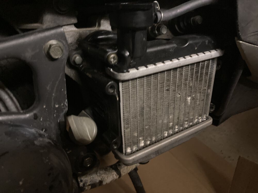

Yes. I'm having a problem with a Yamaha 2006 Vino that I recently purchased to fix up and sell. I discovered I had a problem in the water cooling system because after a mile or two the temperature light would activate. When I purchased the bike after I ran it a bit I discovered it was bone dry.
Anyway, yes currently I'm testing the cooling system without the thermostat and never using water but flush product then antifreeze. Same result temp light activated and now radiator appears to be leaking.

Today I removed the radiator and plugged all the outlets except for the main cap. At first it appeared to have no leakage, but when I double checked by putting a second try of fluid in, it began leaking. So I will be ordering a new radiator. Maybe I'll first try our Wanted forum?

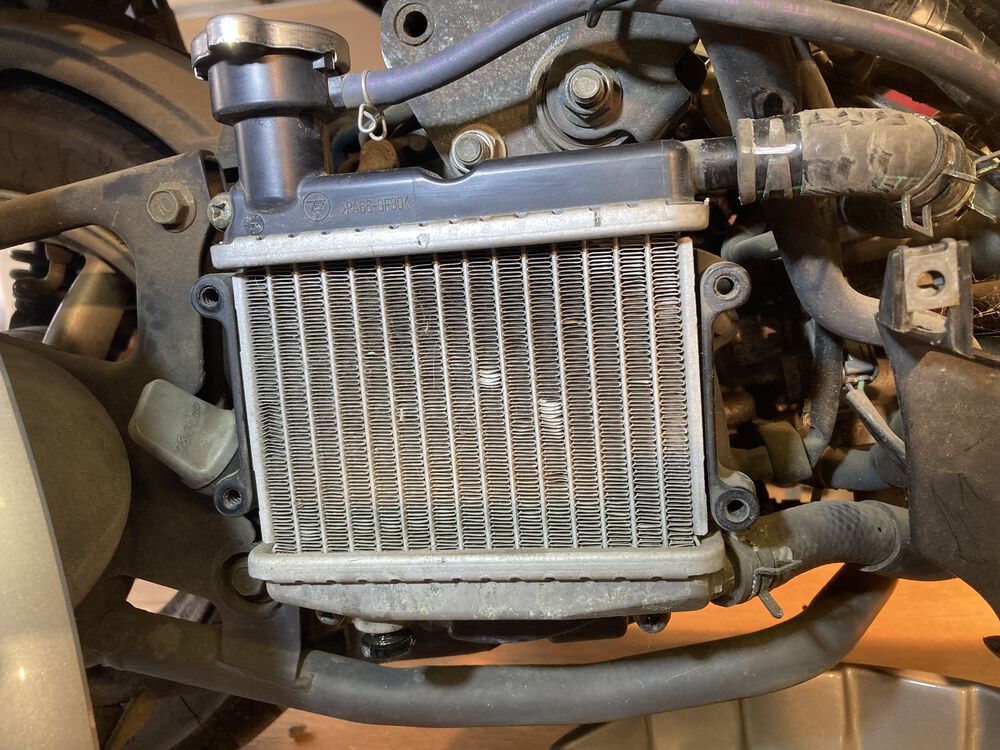

Pull your radiator and take it into a small radiator shop. They might fix it for less than a new one, and have it back to you by the end of the week. I'm sitting on a complete C3 (same radiator as the Vino) theft recovery w/ 3,600 miles. I haven't picked engine parts off it yet, cause I'm not quite sure what I'm doing with it.
