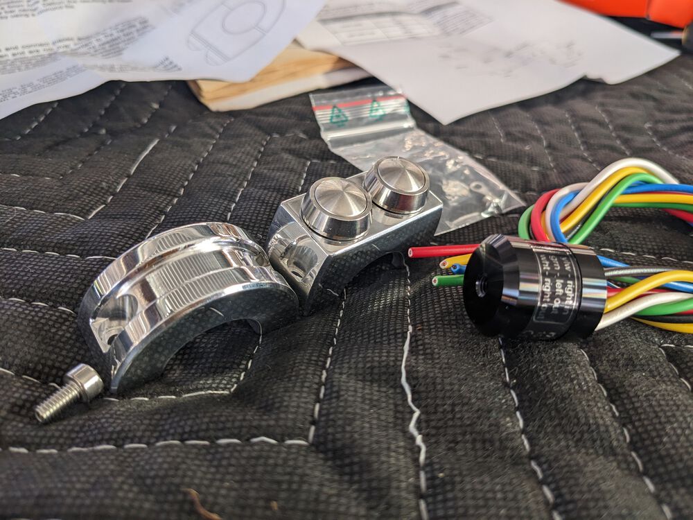

The switch & relay from Motogadget

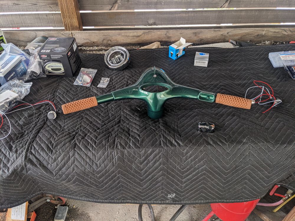

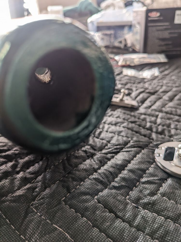

Starting point - bare headset

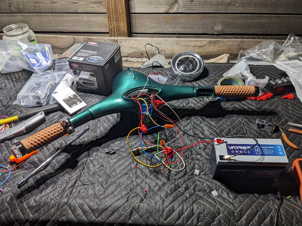

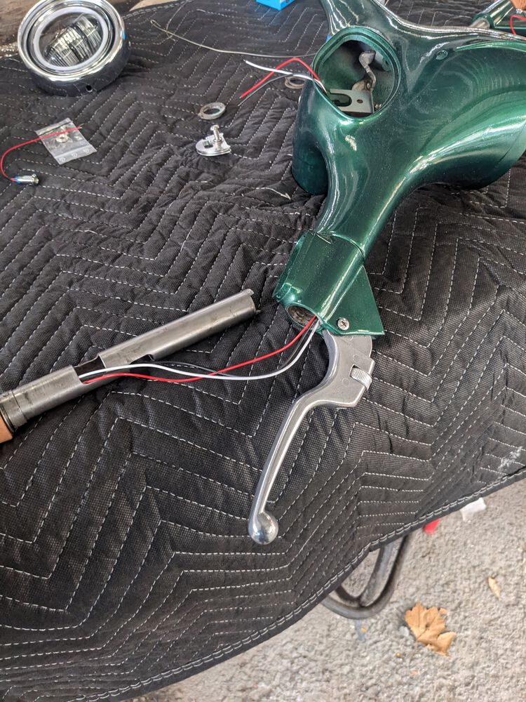

Obvious now, but you can't route any wires until the inner tube is in place

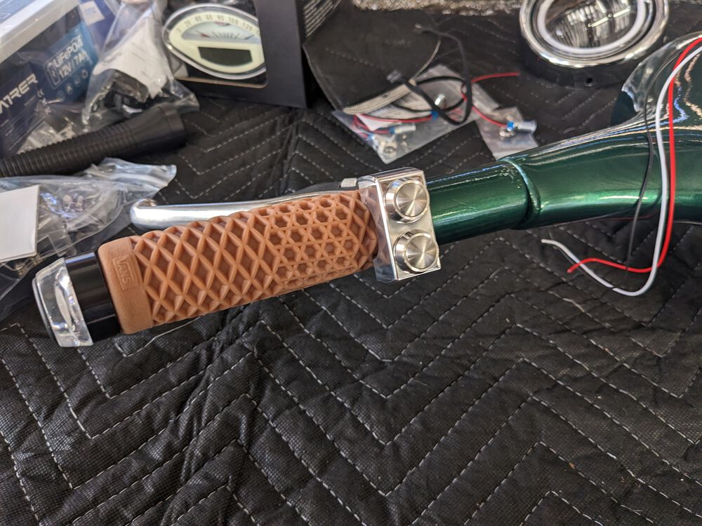

Test fit of switch - very pretty

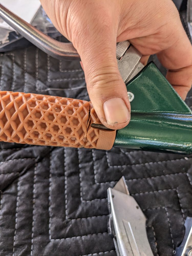

Cut and ready to mount

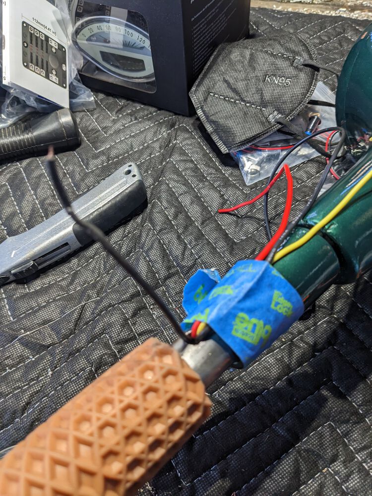

Routing guide - with the tube out, you can just see the path to the headset

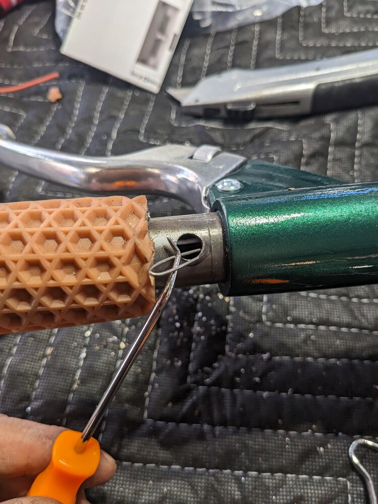

Hole drilled and fish wire in place (1/4" is the minimum size - would recommend at least 5/16" hole)

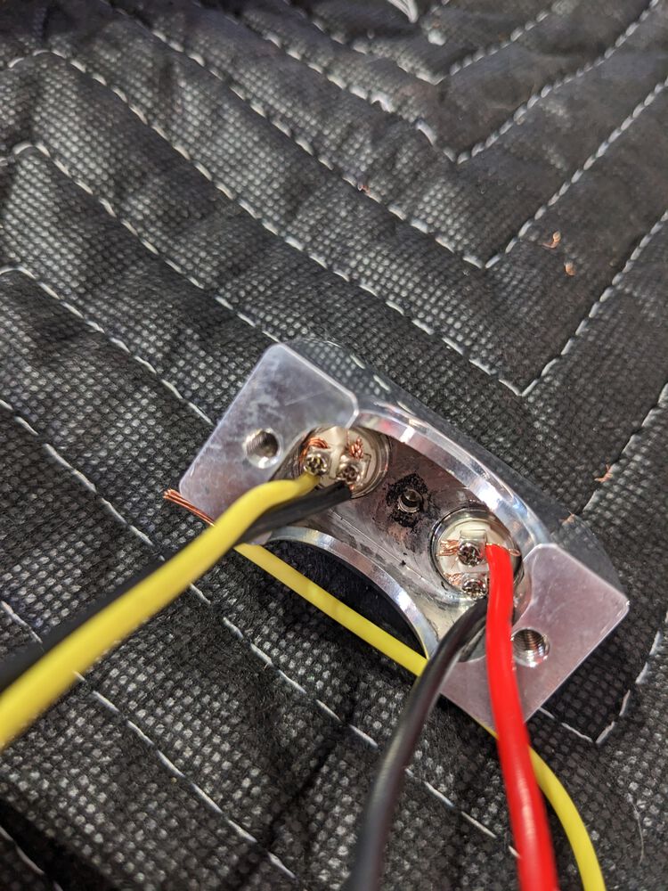

Switch wired up - annoying that it doesn't come pre-wired but easy to fix. No worries on which side is ground

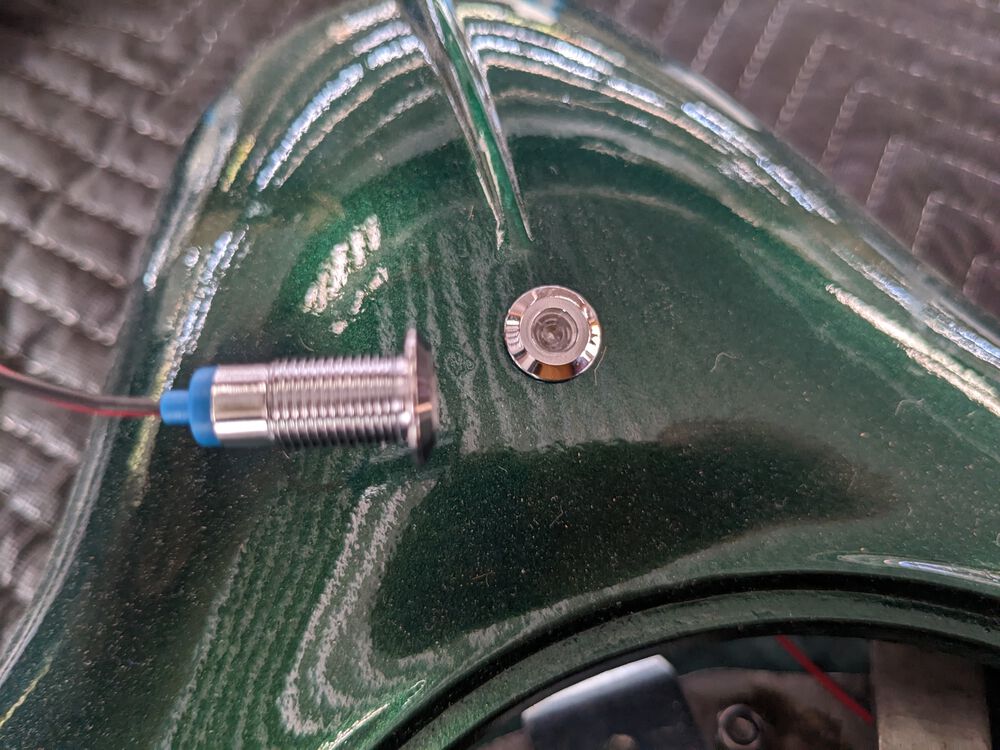

Tip for VBA owners with the small hole in the headset - "indicator lights" come in a 8mm size with a 10-12mm face and fit perfectly and a 5 pack costs less than the replacement lens.
The plan is to wire this up inline with the signals so that it blinks when you have either side activated.

That's a great first posting! I see a SIP LED headlight and digital speedo in the background. Your headset will be super trick once everything is all assembled. I think the only thing i would do different is to weld an extension on the end of the shift tube so that i wouldn't have to cut down the handgrip. My hands are a bit larger than a petite Italian woman (actually my hands are fairly normal sized). It's just that cut down hand grips are a pet peeve of mine (especially on dirtbikes).
